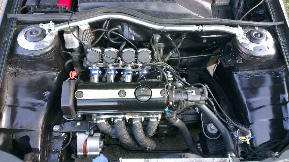

here are the Yamaha FZS 600 fazer bike carbs i bought off ebay. i have recently cleaned them up and have sent them to bogg bros to be jetted and have an inlet manifold made up, also including the intake and out take for the coolant, it will be 215 pound well spent plus postage.
I have recieved my yamaha fazer fzs 600 year 1999 fuel pump to match the carbs, bogg bros will fit this to fuel the carbs correctly with no need for a regulator or the VW polo various fuel pumps.
My four cone bike carb filters finally came, bargain £15 pound delivered from asia, 50 mm hole diameter to fit my air intake flanges

Well here it is! My Bogg Brothers inlet manifold. All stamped and looking sweet, finally came today after three weeks of waiting. For the manifold, stripping, cleaning and jetting the carbs to 150, and delivering them it cost me a whopping 320 pounds ! Worth every penny though, so 320 plus 50 for the carbs, 15 for the air filters, 45 for the bike pump, 80 for the dizzy, ignition module, coil and loom all comes too 510 pound, lol fooking hell. Going to be sweet !
