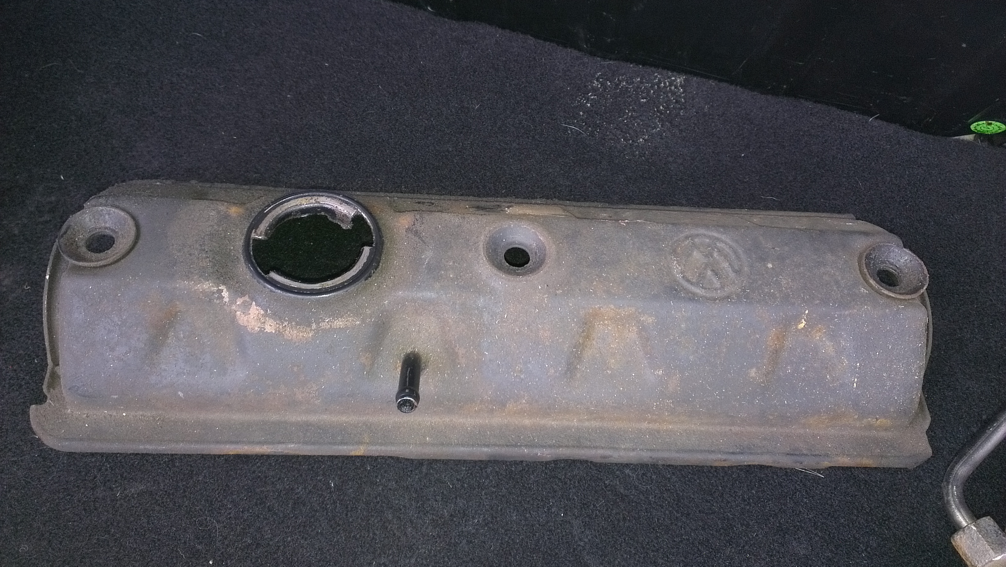

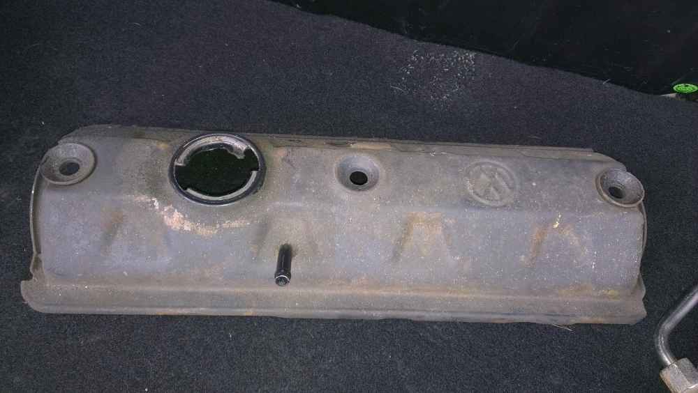

i went to K and M powder coaters today in Pontefract, dropped off a few bits off to be done:
Hockenheims to be refurbed and done light cream
rear strut brace to be done satin black
rocker cover to be done silver
vauxhall carriers and callipers to be done gold
