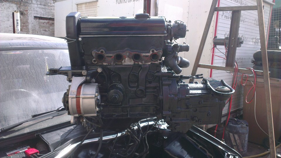

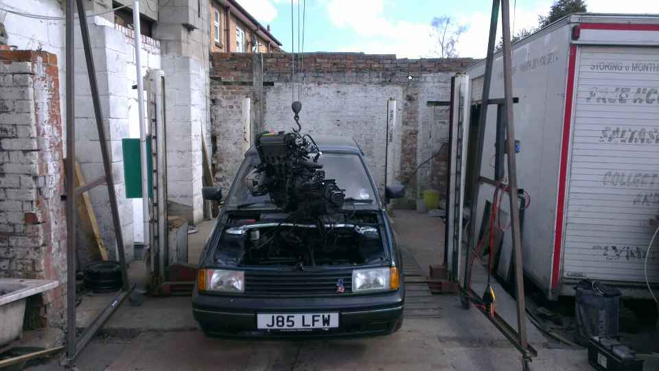

So the engine ect is in , and it is running, gear linkage all spot on.

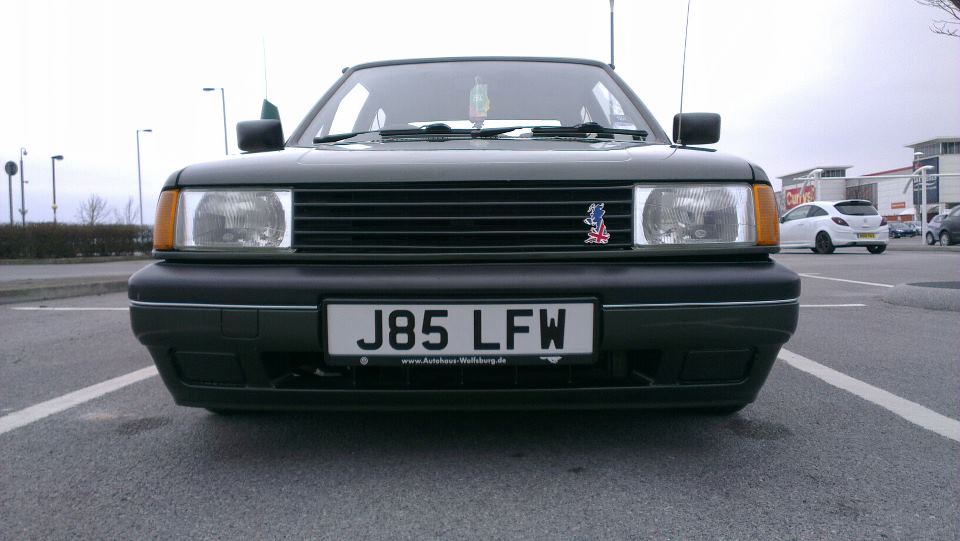

Here is a current picture of it now, need to do some tidying ect , but is looking good, desperately need my custom scuttle pan to cover the battery up ect. Get another slam panel and powder coat it too. Also want a new bonnet.
