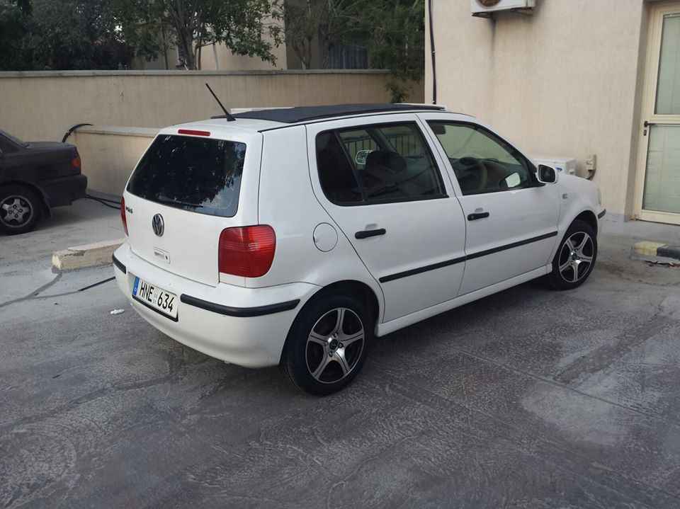

Hello everyone
Am new to this website and in need of some much needed help,So i hope that there is someone that can point us in the right direction.
I am a expat living Cyprus and just bought a Volkswagen Polo 1.0 Open Air,Just the right car for sunny Cyprus. :D

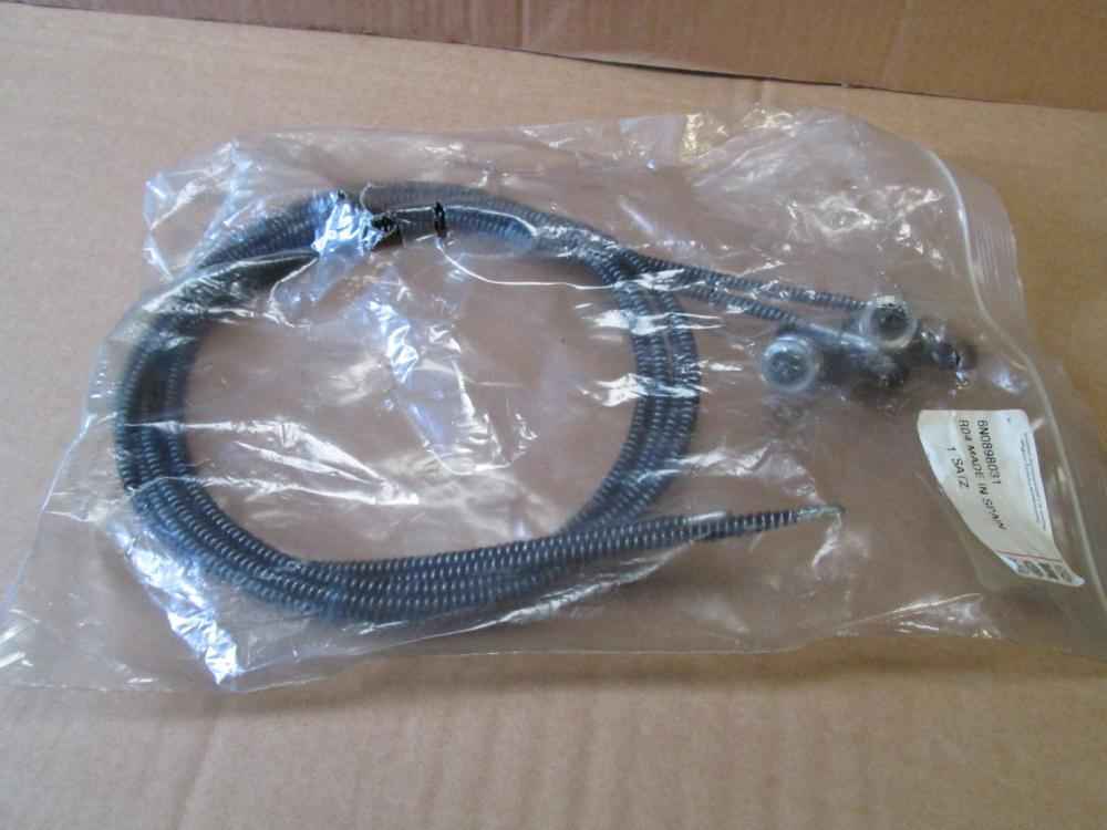

When i bought the car i knew that the sunroof does not open and came with some leaks too. i thought it would be a easy fix,but after having a look to see why the roof is not opening i found out that the sunroof motor is ok and it seem to be the cables that need to be replaced.
I have been looking everywhere to find these cables New or Second hand.I did manage to find only one on Ebay for £225.95 which i think is a bit much.link below.
http://www.ebay.co.uk/itm/VW-LUPO-POLO-OPEN-AIR-FOLDING-SUNROOF-CABLES-6N0898031-NEW-GENUINE-PART-/131163371560?pt=UK_CarsParts_Vehicles_CarParts_SM&hash=item1e89f23828.
I have tried Euro car parts but i do not have the part number.
If someone knows where i can find spare parts or maybe the complete sunroof please let me know or send us a link.

I would keep trying them as their turnover of stock is quite fast.
In the parts listing there is a "repair kit/ guide with cable" listed for the frame P/no 6N0898031 listed @ 83€uros in Germany
