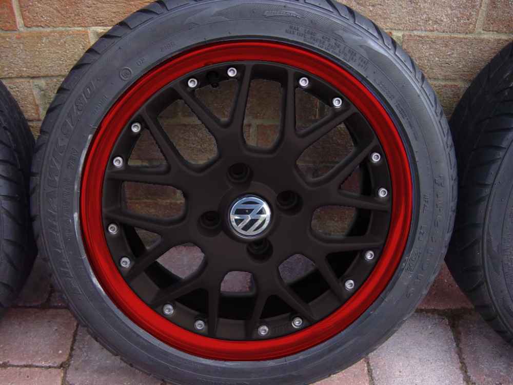

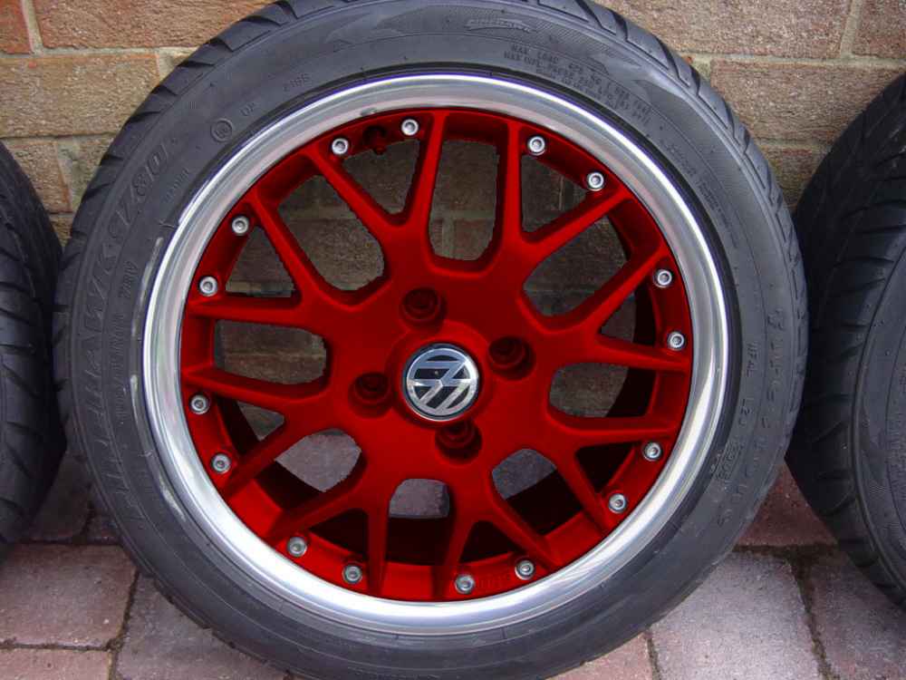

Tell me about it, once they are apart its all down hill from there. The outer rims really don't take much to clean up, and if they are anything like mine they won't have any lacquer left on them.
Also for the bolts there are adequate sellers on eBay that have them, but they are not cheap. What you could do is get some different bolts ie Allen head in either an m7 (if you can find them) or an m8 and re die them to m7. You could probable get them for about £2-3 a wheel as apprised to ore bolt... Might be worth a shot?
Just need to make sure you get the right tensile bolts if you are replacing them for stuff that isn't OEM. Don't want them snapping. I'm gonna assume they are 10.1?
Yeah will look into it :) I know some one who can make
Some anyways if not , but I was thinking of just buying another wheel anyways as one of them
Is shagged ! So gonna have some spares anyways :) just deciding what colour to go with them
, unsure whether to go black centre and high polish rim, or maybe do a colour rim and black centre , need to have a think :)
I'm not sure what they are really , would have to inspect them :)
The standard bolts are made of titanium.
I would defo go with a polished lip as IMO they don't really have the same appeall if they are painted. As for the centres you can go with anything really and it will look good with the polished lip. I painted my centres in white primer then put the centres back in to store overnight and I have just kept them in a mart white as I think it looks awesome.
