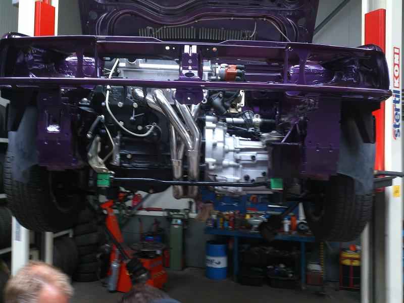

The gearbox is been completely overhauled and gets a new clutch. The engine is also been overhauled, parts are polished, newly galvanized (?) or painted. Also fitted a new 4-2-1 outlet manifold, Newman cam and new pulley on the G-lader. This is all done by Jeroen Leenders (for some of you maybe known for his red 6N 1.8L bi-turbo).
Next week we will work on everything under the bonnet and it will also get a respray over there.
After it the block can be fitted and also a new leather interior will be fitted.

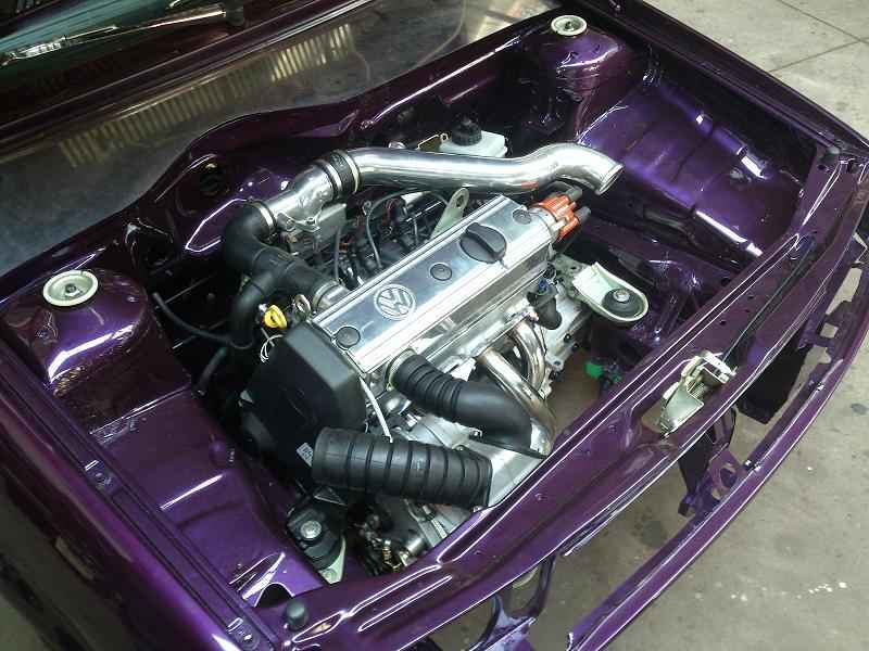

Found a few pics of the engine during rebuild. I didn't want to much polished / chrome stuff on it because I still think a car is made to drive not to wash or wax it daily and drive it on a trailer :lol:
It is rebuilt mainly as stock, only the head and 3F inlet have been flowed. Also a 4-2-1 exhaust, Newman cam and a 68 pulley will be fitted.
After I am satisfied completely I will have a custom chip.
Important for me is that it will stay reliable and I can enjoy it for many years to come!

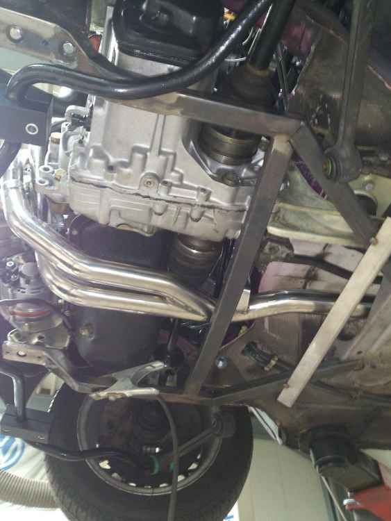

- The gearboxmount is welded, to hopefully prevent it from breaking!

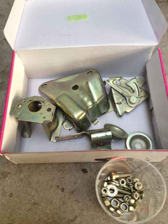

Sandblasted the last parts, to get it newly galvanized
Process of welding the mount
Almost finished

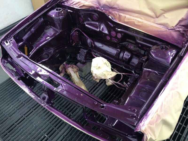

Update:
13-9-2012
The engineroom is now ready for paint, this will be done today or tomorrow.
Also the last parts are now going to be galvanized. Then it's buildingtime again!
Wow this is beautiful, love the colour
Next step done! She is becoming more beautiful with every step and making me more proud :-D
Now we let the paint harden good enough, the frame needs to be welded off and painted. And then.. Building up time!!

So guys, again an update. The last parts are back now fand zinc-plated.
