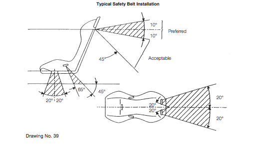

this is the diagram i was referring to, it shows the windows which are acceptable to mount a harness point to.
i have my shoulder straps mounted to the rear lap strap mount and the bottom of the inertia real on the rear wheel arch. it's passed scruiteneering like that for about the past....5yrs!

Is the rear lap belt central to the seat?
Ie could I mount a 3 point on that single rear fixing need it be inline with the centre of the seat?
no it's slightly into the centre of the car.

Yeah but surely it will be pulled to one side then and be totally the wrong angle from
A safety perspective?
Indeed, and the ones I used (OMP) the reels wouldnt work unless it was coming out at 180degrees and dead central, which isn't easy when trying to mount them to a flat surface

So basically unless you rigidly mounted the retractor at the right angle it is not gonna work? Lol

Mounting them at the right angle isnt a problem since they come on brackets that can be bent to the correct angle...the reason i couldnt do this is because my harnesses go under my rear floor so the belts just wont work the way they should.
