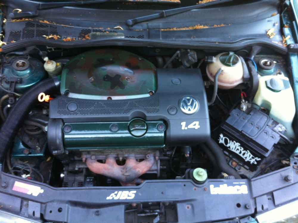

Tell you what, I think I've solved mine completely.
Checked under the bonnet, had a hissing/whooshing of air sound. Found that one of the vacuum tubes from the air filter was punctured. Replaced it with one from the scrappy, whooshing sound gone. Still cutting out on me though, but slightly less often.
Tried plugging in the Sat Nav the other day, and it was completely dead. Same for the stereo. Turns out fuse #28 was blown, no idea why. I pulled out all the wiring to the stereo and the cigarette lighter, traced the cabling back to where the loom comes in from the engine compartment - reseated the connector. Inspected all the cabling (fine), and wired back up. Replaced the fuse, and huzzah, since then there has been zero in the way of any sort of problems. It's kept the time, remembered the miles I've done and so on. No cutting out, stuttering, or whatnot. During the whole process I did have the distributor cap off, and reseated the rotor arm. Not sure if that's what did it, but might be an idea to take a look at yours?

I found today that I had a Bosch distributor cap on a Marelli distributor. ¬_¬
Replaced with a proper Marelli compatible one from Parker's Parts in Corby (Cost about £12), stuck a new rotor arm in as well, and everything's peachy. Turns out I had no cover over the distributor cap, the metal part with the earth braid on it. When I bought the car there just wasn't one fitted, probably because he couldn't get it on with that bloody Bosch part.
Worth checking maybe, just take a gander at the distributor - see if the plastic cap with the HT leads coming out of it has a metal cylinder around it that has a braid attaching back to the distributor.
i fixed mine yesterday, changed the fuel filter which when i open was proper black , and i changed the rotary arm and dizzy cap now it works fine
I haven't done the fuel filter yet, I've got goo in my breather pipe and oil in the air filter, so I've got me a breather pipe from the scrappy and cleaned it out, and tried to mop up as much oil as possible. Petrol consumption seems to have gone down quite a bit since I started poking around in there, and the cutting out seems to have died down too, hasn't done it for days.
