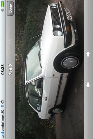

Not really sure to start with this but i've been lurking on here for a while and wanted a project car so I kept my eye out for something different when my 90 Saloon came up on ebay.
I picked it up for £410 back in may!
Here's some photo's from back then.
After a 150mile drive from wrexham where i bought the car i then set about looking at the problems with the car,
Firstly the car is strongly pulling to one side so on closer inspection it has a bent bottom arm so first thing is to replace these.
Also the wing is dented in and this is stopping the door from opening.
The exhaust is just hanging on with wire.
Theres a massive dent in the rear quater and variour rust holes in the car such as drivers door sill, filler cap panel.
