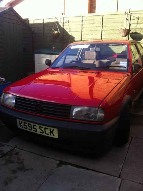

Polotommys coupe AKA Christine
Chassis/suspension:
Lowered 60/40 on PhillJ suspension
Powerflew antiroll bar bushes
news bushes/ trackrods all round
Rear upper strut brace.
front upper strut brace
Arb blocks
GT steering damper (not fitted yet)
Mark4 top caps
Wheels:
Refurbished 13" Revolusion wheels, Two new avons on the front.
Engine:
1.3SPI converted to GT injection with chipped ECU, GT cam, Big airfilter and cold air feed, also slighly bigger bore exhaust from the GT model. Estimated 68-72BHP
Brakes:
Mark4 front brakes converted to vented disks with Bosch pads.
Fully rebuild back brakes, drums, bearings, cylinders, shoes.
Exterior/interior:
G40 interior
GT arches (GT look)
After market foglights
Ice:
Nice sony CD player and some sort of amp (no clue) needs new speakers
Comments/Plans:
I've had the polo for around 5/6 years now, I brought this to replace my old red mark3 that I scrapped, just cant get rid of her!!! her name is Christine.
MPI: Coverted to mpi
Chip: done
GT cam-FITTED
4branch, anyone got one cheap. Still waiting one to come up locally, new exhaust fitted
wheel refurb/Better tyres: Better tyres fitted, two new avons and full refurb
full respray; Had most panels done, needs abit more to be perfect
Tidying up anything manky: Mostly done
Plans 4/11/14
More engine mods upto 90/100BHP
