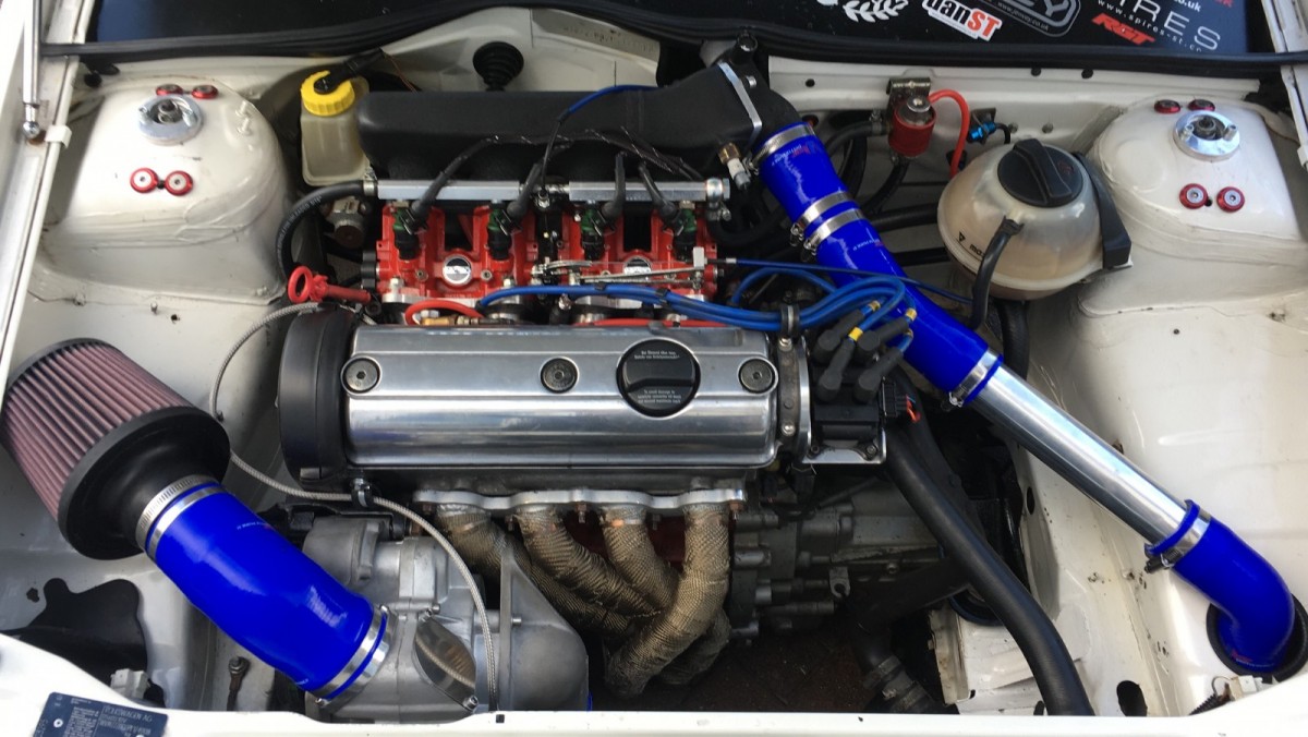

Day 2 seen the engine removed, bay cleaned and stuff like the fuel system modified to suit the carbs..and dropped engine in place
Next couple of days were spent getting the engine in, obtaining ARB/manifold clearance, setting ride heights and damper tuning. Seem to have lost of a load of pics at this critial point haha.
But engine is in, nearly 1000 miles done now, going ok. Some pics out and about...

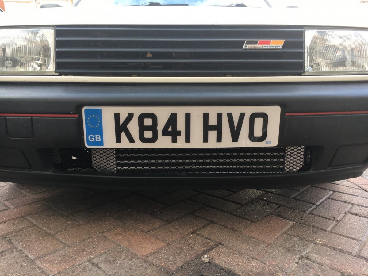

Oil cooler..
Thermostatic sandwich plate..
B0A72252-4BB0-4C36-AF5F-DB683B364BC0-968
Mounted here mainly due to pipe length..
20B32226-C80B-435F-9394-392F1AF2F860-968
Heat shielding on the pipes although they're stainless overbraid - quite close to manifold
5A0B81AB-BF2B-4451-9A87-E605D7328506-968
Pretty subtle with the bumper on, compared to people who hang them out the front like a sick Intercooler n ting anyway!
