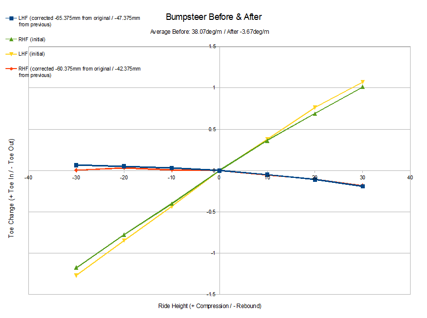

Once I bolted it all back together I wanted to measure to see where my front bumpsteer was at, and see if anything could be done to improve on it.
For those of you who don't know, bumpsteer is essentially the toe change through the wheels movement through its suspension travel.
Ideally I'd like zero bumpsteer, or perhaps slight bump toe out, so as the wheel goes into compression it toes out slightly which will help generate a small amount of understeer as the car rolls when cornering.
But anywho, I got a few bits together, and made a spreadsheet to help me work stuff out...
9855A30F-9012-466A-9916-F374BEAE9A6A_zps
8B877905-3DEB-4D77-A2D4-3A6D7A9C261D_zps
So, whats going on here is basically:
A flat plate mounted to the hub, with lines scribed at 10mm intervals
Front springs removed, and damper bolted in place, I set the ride height to its 'normal' height
Set two DTI's on the centre line of the plate, and a certain distance apart (this is needed to convert into degrees later on)
I then recorded the change of value on each DTI gauge, and subtracted one from the other to create a steer change in mm - due to the fact the wheel moves in/out with wheel travel, camber change etc using two gauges means you can get the change between the two, to get a toe change figure
I then recorded the gauges in 10mm increments into both compresison and rebound
These numbers are then easily converted into degrees with some basic maths, then you can plot toe change against ride height on a graph and solve the graph for a bumpsteer value
I knew it would likely be a bad result, but I was surprised at just how bad it was, for a start I had a LOT of bump toe in, the opposite way to what I wanted, however it was a nice linear bumpsteer 'curve' which is nice, although it was only tested through a 60mm sweep (+30mm / - 30mm)

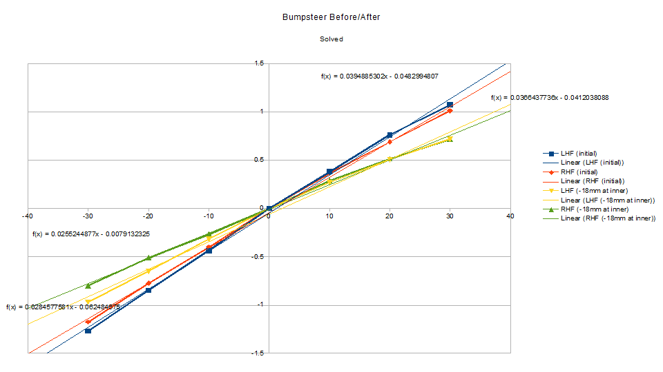

I then set about trying to correct, or at least reduce it. I lowered the inner steering arm mounts by 18mm, which reduced it by 11deg/m each side (11 degrees of toe change per meter of wheel travel) which is a pretty poor ratio for correction, which is just down to how long the steering arms are.
You can see on this pic the before and after, and the equation of each plot, which multiplied by 1000 is the value in deg/m
I will be looking to correct it further, however it needs another 40+mm of adjustment, so it may not be possible to correct as far as id like.

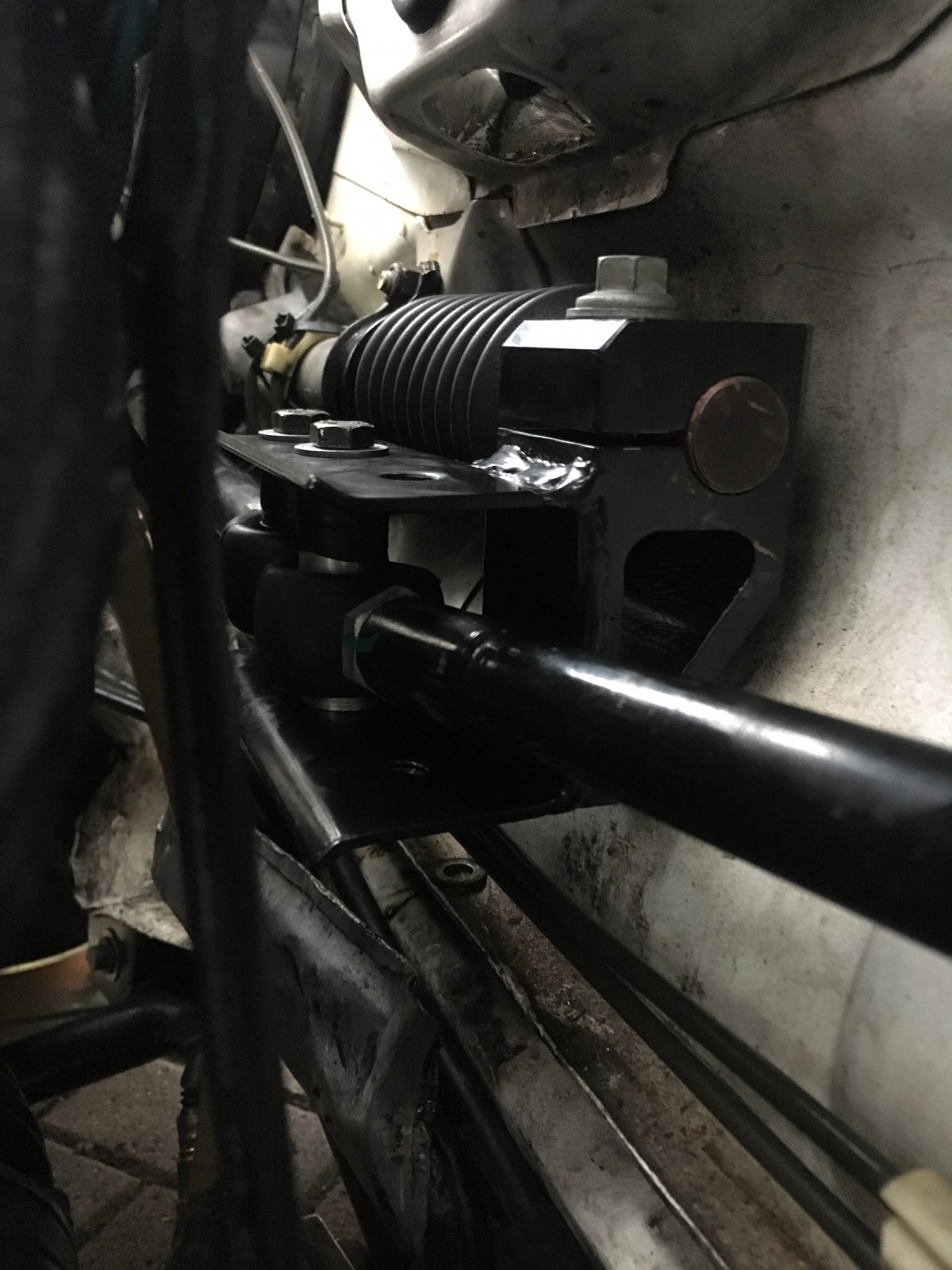

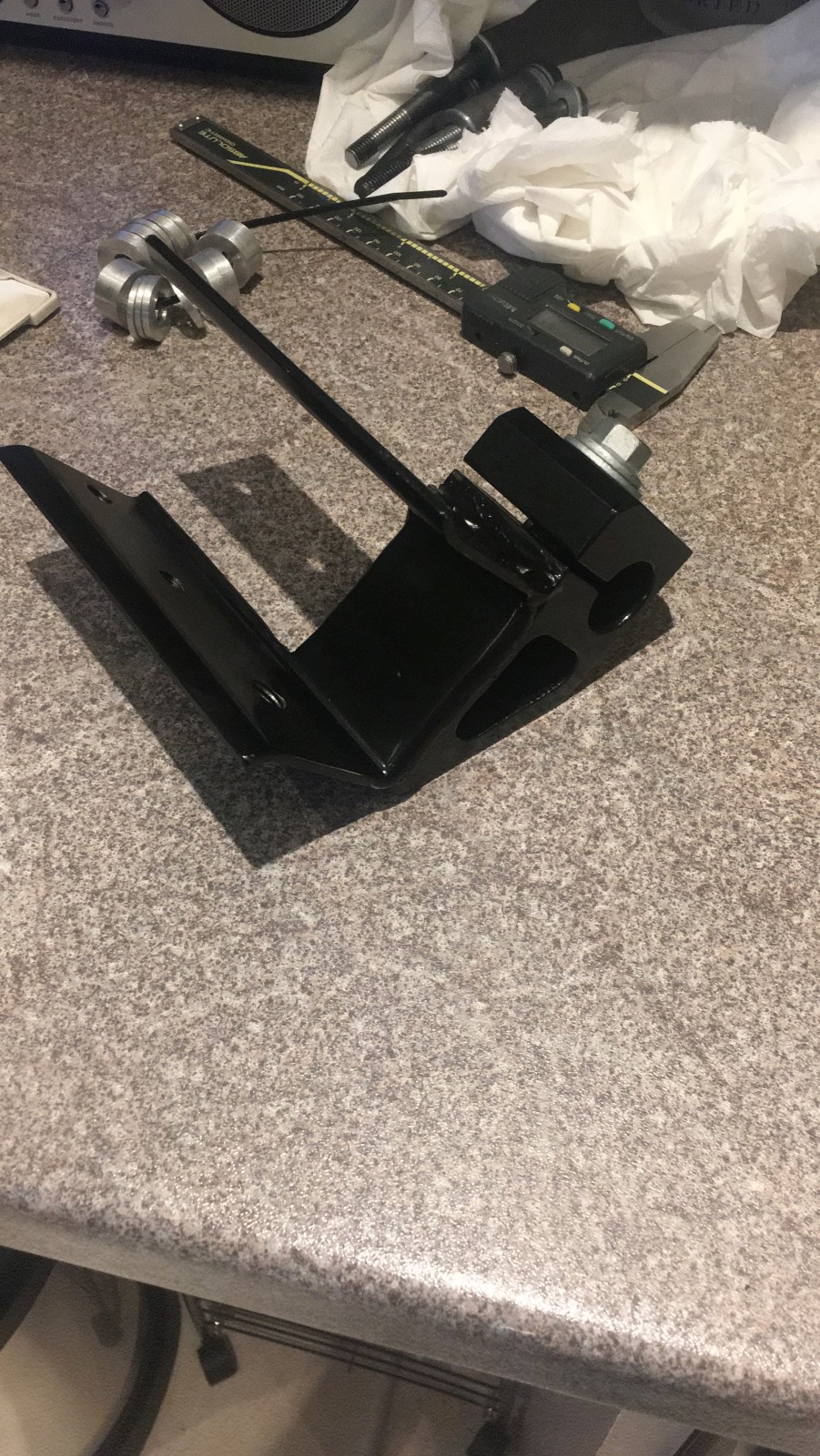

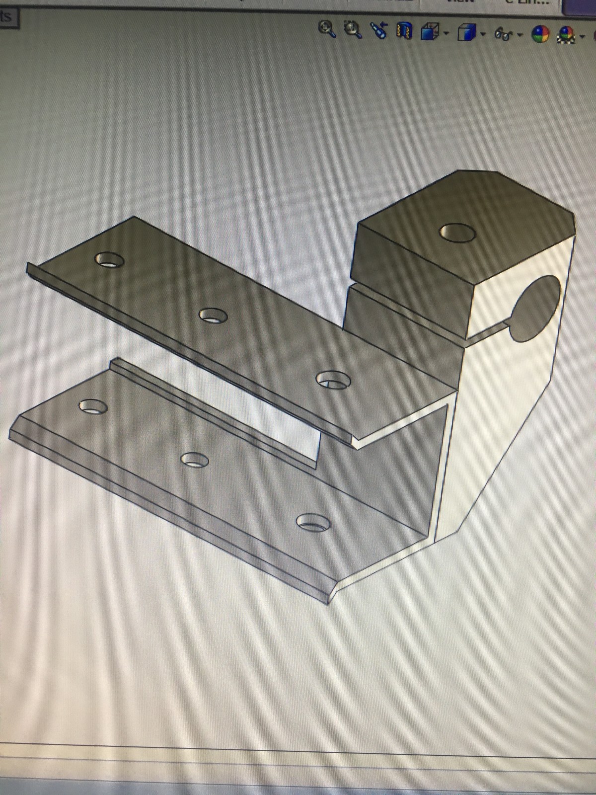

Earlier on I posted about measuring bumpsteer & trying to fix it... so I quickly designed a new rack clevis to enable me to lower the steering arms, but also adjust each side individually..
Which after a bit of playing around it ended up like this (values are average across the axle):

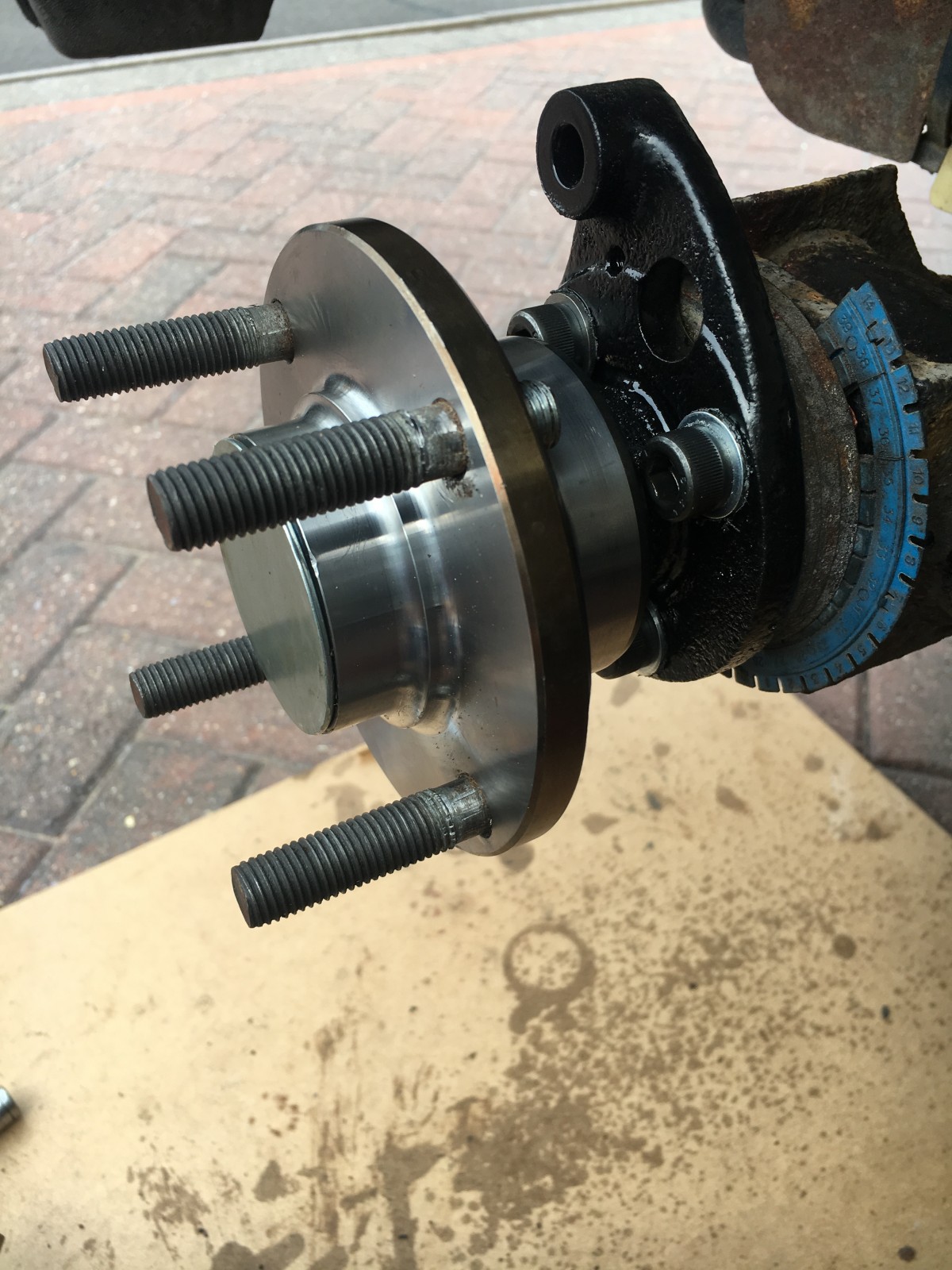

Have fitted a 6n2 GTI rear disc setup...refurbed calipers etc..mainly because I wanted a better wheel bearing setup!

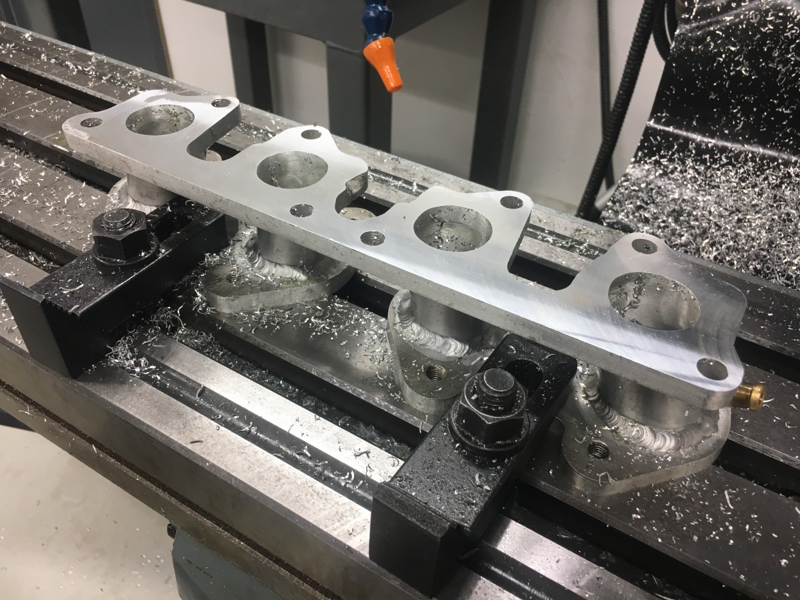

The other main thing I've decided to do was supercharge the AEE because I was bored. I'm not really after mental performance or anything..just fancied messing about!

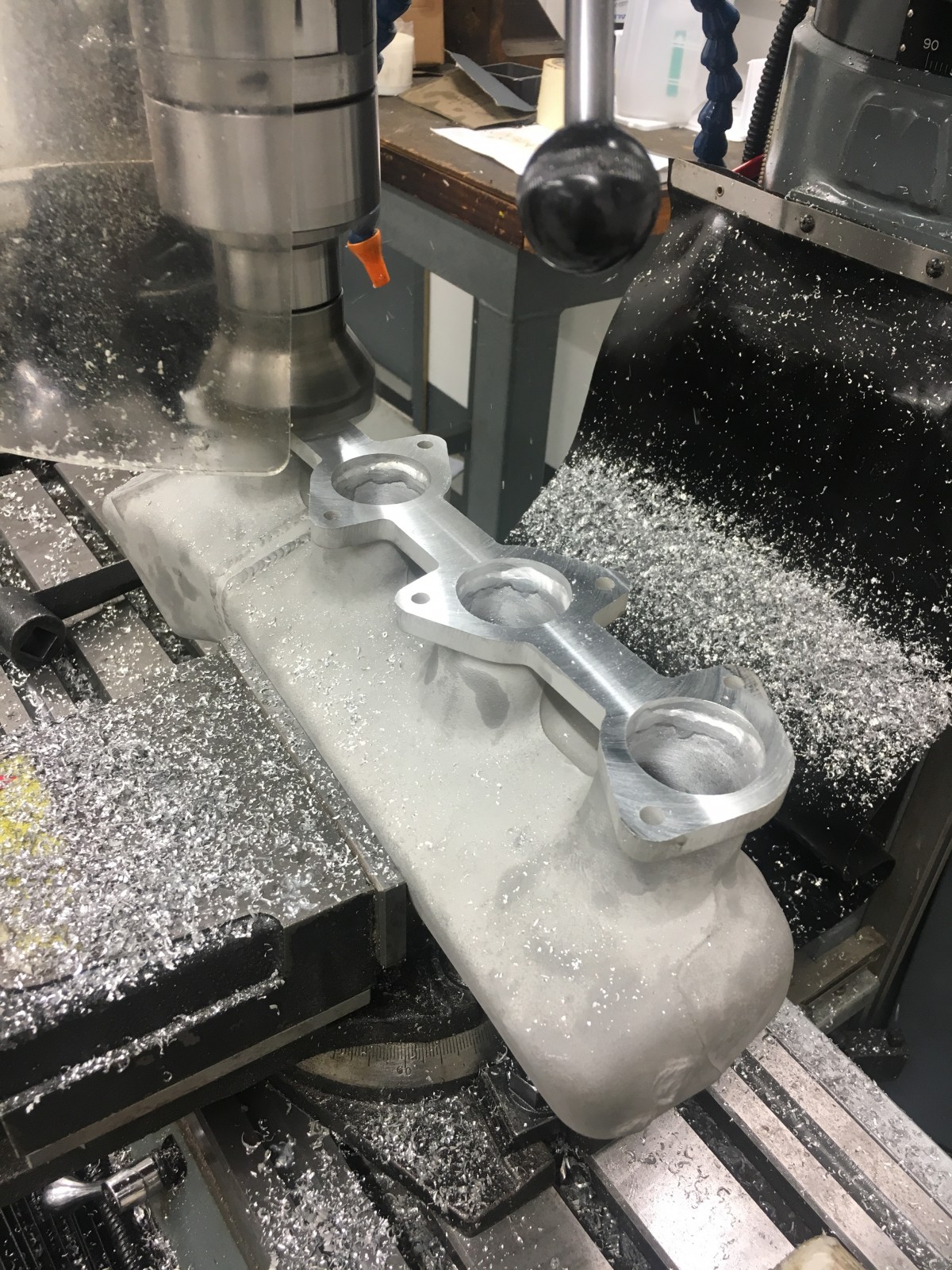

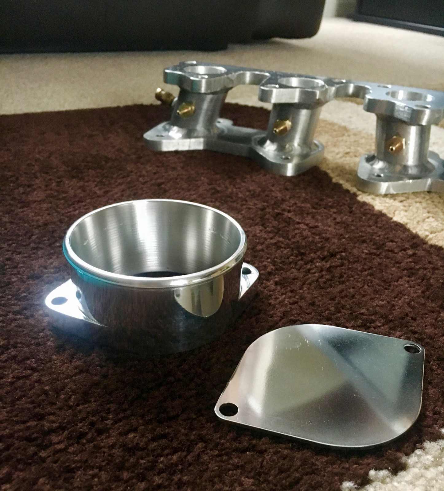

So engine setup is as it was, other than fitting a decomp plate so the CR is now about 8.2:1.. and bodged together a plenum using a 20vt inlet manifold...

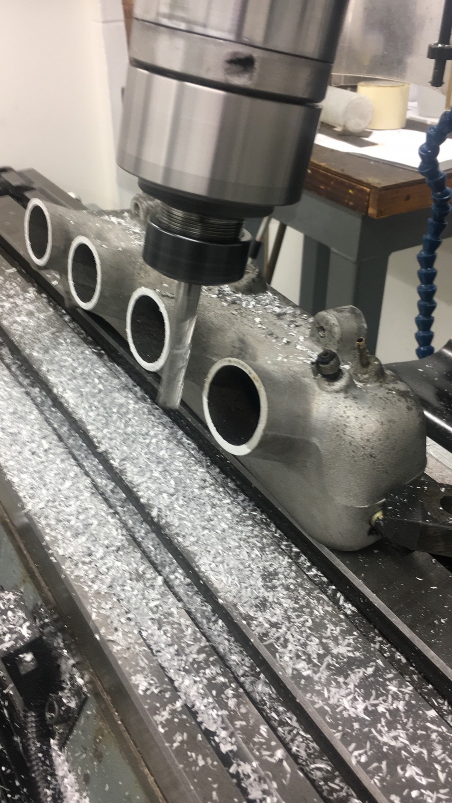

Inlet flange side cut off, & machined square..
Made an adaptor to fit a G40 BRV..
Welded internally, skimmed & pressure tested..
Skimmed inlet manifold..
Test fitted..

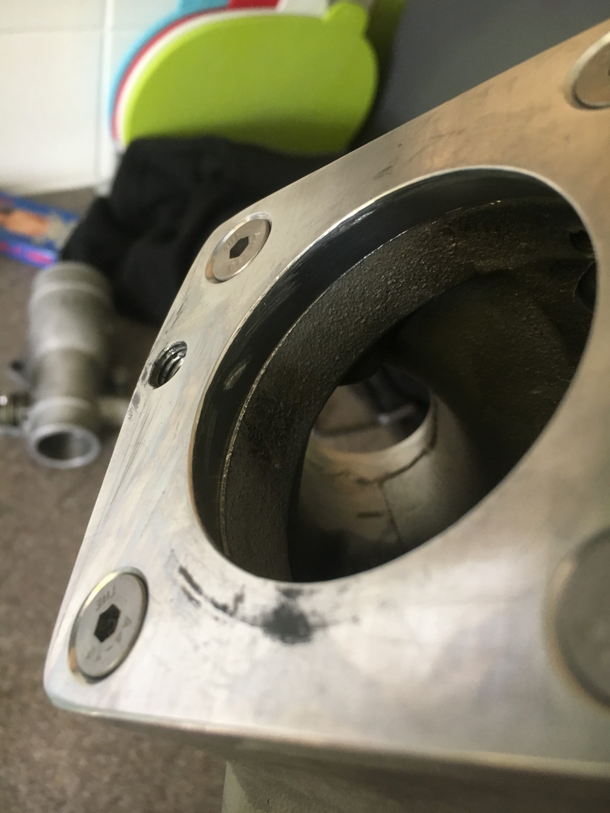

Also had to modify a G40 engine mount to fit my block...took zero pics. And the exhaust manifold.. test fitting stuff:
Machined an inlet stub for the charger...

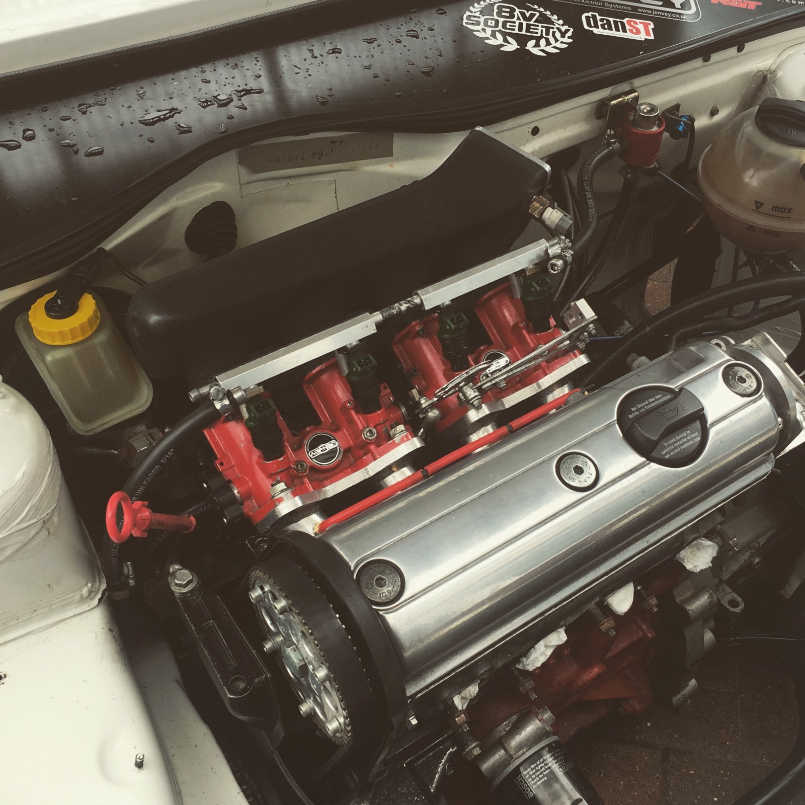

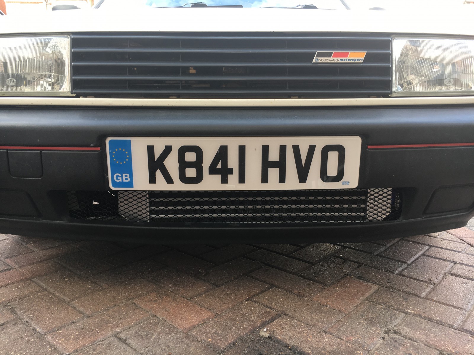

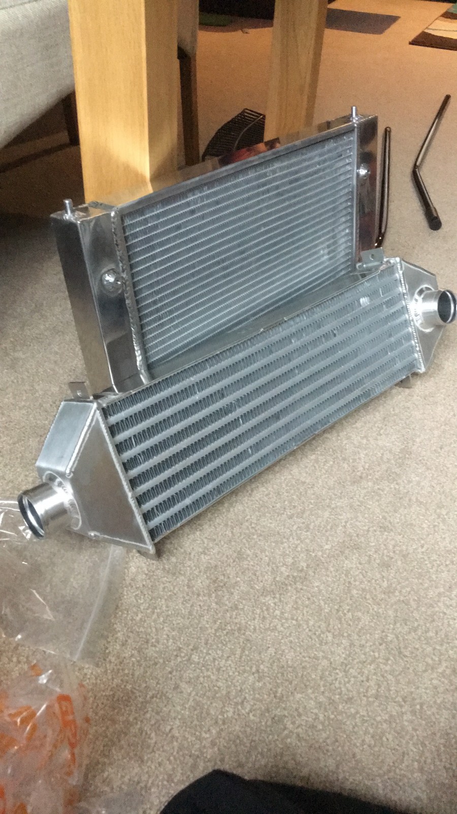

Got a new alloy rad & forge intercooler..

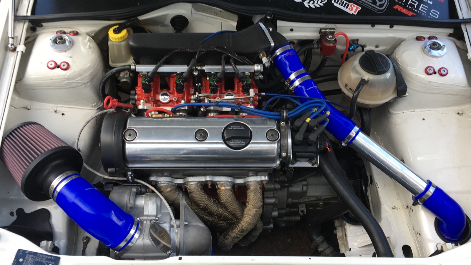

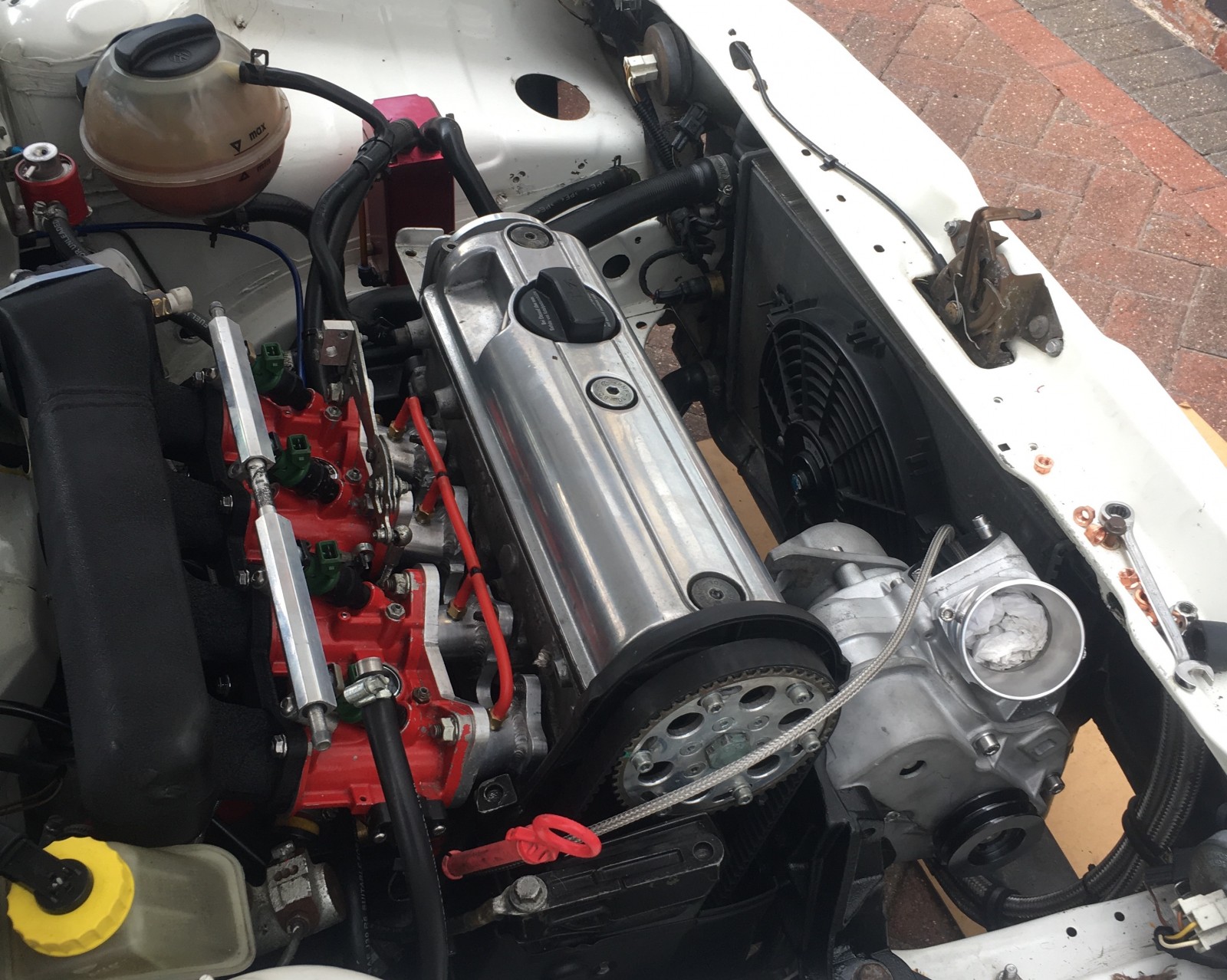

Smashed stuff together...
Its all a bit cobbled together at the moment. Stuff needs changing and improving, but I wanted to test how the G40 worked with ITBs etc first.
Will probably make up solid boost pipes and stuff eventually and change a few other bits and bobs around.
Have done about 600 miles so far...mainly messing around mapping. Running a standard charger with a 68mm pulley, it holds about 6-8psi boost through the range and pulls reasonably well.
Going to do a bit more mapping first then take it somewhere for fine tuning on a rolling road.. not going chasing mad power or anything, expecting around 150-170hp.
