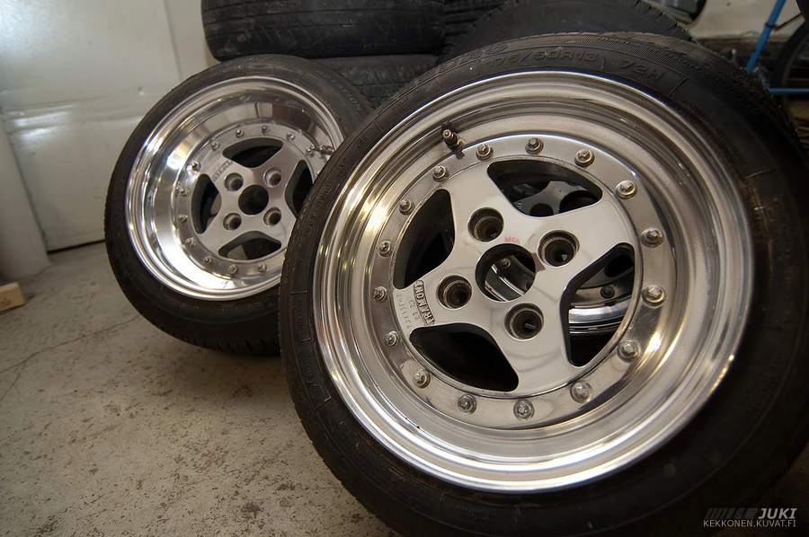

Wheels and Tyres: Tramont TY2 7x13 + Fulda Carat 175/50R13

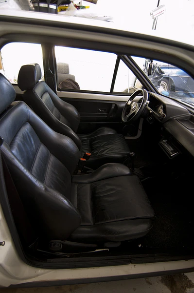

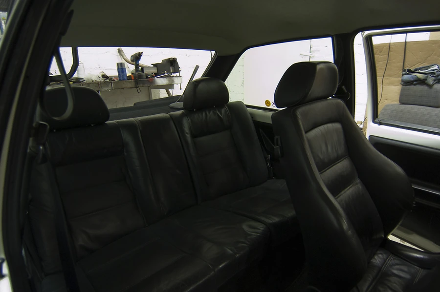

I have already installed leather interior from a ColourConcept Golf. I had to narrow the rear legs of front seats to make them fit on stock mk2 rails.

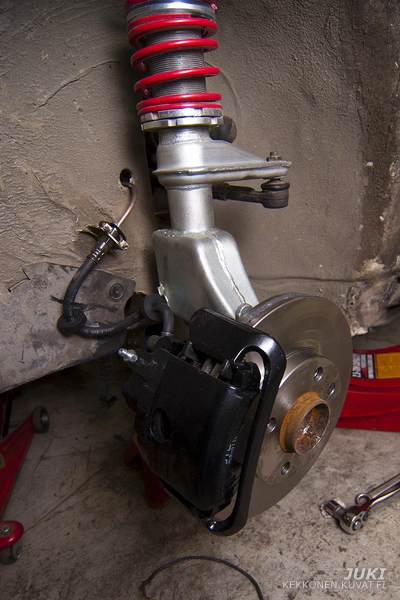

Suspension is a "GTO" coilover set, front and back. Have been very satisfied with them! The front struts have been adjusted to lowest point(with helper springs still in place), rears have still plenty of threads left.

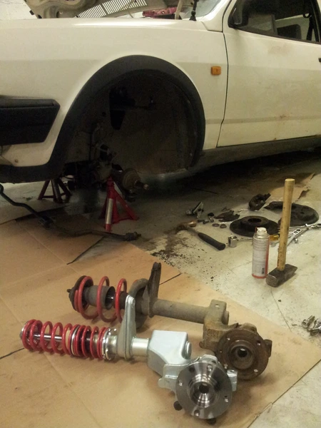

With the engine I will have to swap G40 front brakes, rear axle beam with arb and few other bits and parts to make it street legal in Finland. Basically I have to make it equivalent to a G40 Polo, for all the suspension, steering and brake parts.

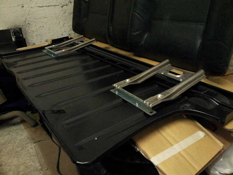

Golf mk3 rear headrest holders installed to mk2 backseat:
Front coilovers:

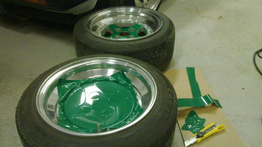

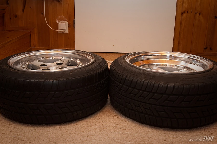

Currently the wheels are covered with selfadhesive vinyl:

I'd have used a flat strip for mounting the headrest brackets though, those ones sticking out look like they could cause problems.

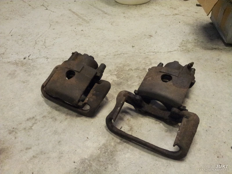

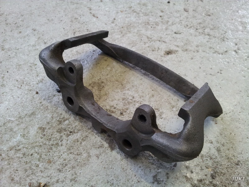

Thanks for all the comments! Here is a small update regarding front brakes:
I received the G40 calibers last week and have been cleaning them with citric acid. The carriers were clean enough in 2 days and calibers are still lying in there because there was still some rusty spots on them.
I used 10% mixture: 4 liters water and 400g citric acid.
When i got them:
Carrier after 2 days of citric acid bath, just rinsed with water, how could rust removal be any easier? :D

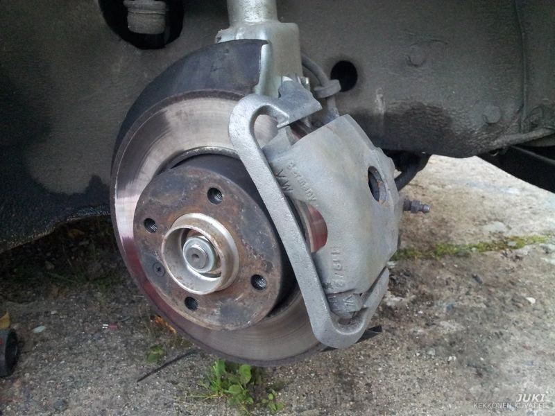

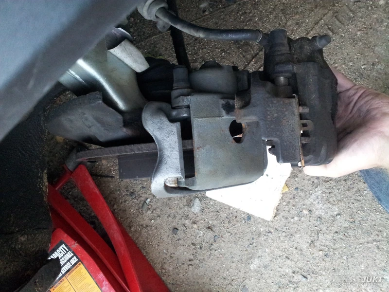

I also took one caliber out for test fit (just to make sure I can still use the Tramonts with these brakes and seems I will be ok)
Just a comparison pic with stock disc and caliber:

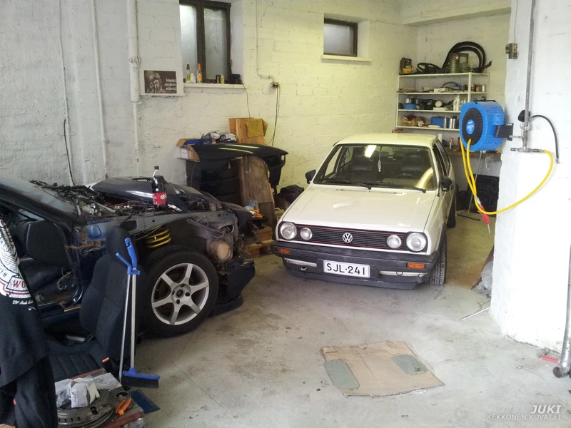

Okay so now that I have found the engine and we have made a deal for it, I put the Polo back in the garage and it won't be coming out until next summer :) Don't know yet for sure of the day I'll receive it, but seller told he'd be taking it off the car this weekend so it can be shipped to me.
There it is in it's own spot:

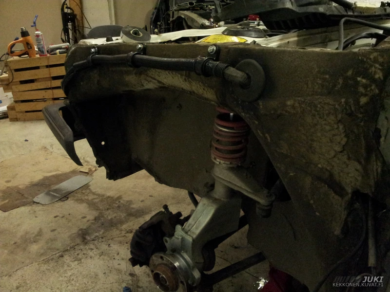

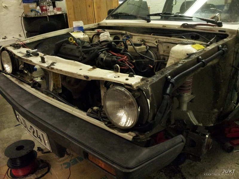

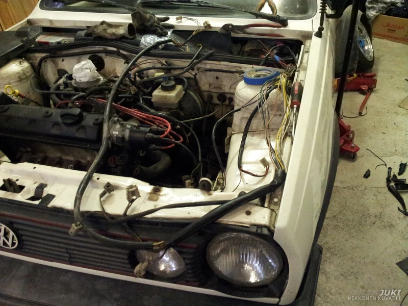

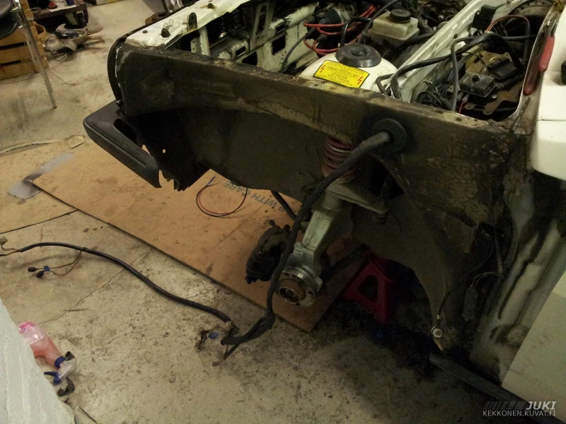

While waiting for the engine to arrive, I decided to re-route the wiring harness for front lights etc.
First I opened it up to separate the distributor and window washers wires. (Also removed the cooling fan related wires completely, because I have already re-wired it earlier, with a relay and a switch on dash.)
Then covered the opened part with "self-vulcanizing" tape, also made a hole to get the harness inside the drivers side wing:
And finally covered with a plastic tubing and secured it so it sits nice and tight:
It's all about the little things that no one sees.

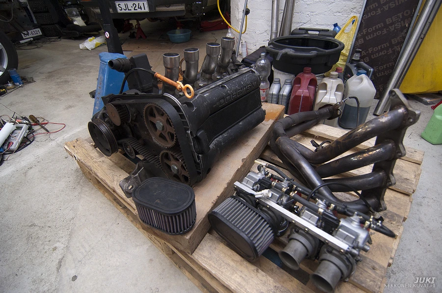

So the engine arrived after traveling one week from England to Finland :)
Some of you may be familiar with this engine :D

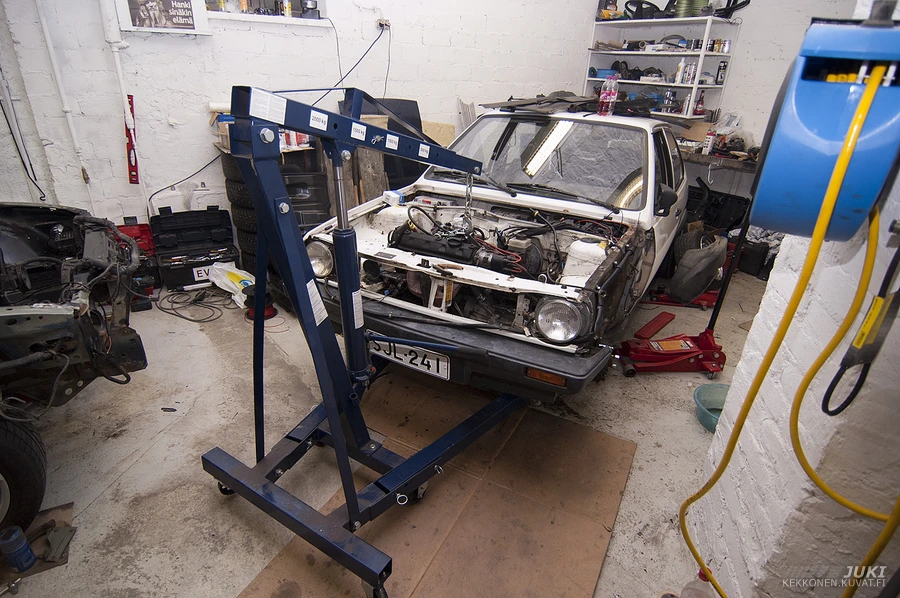

I borrowed an engine lift from a friend:
And out it comes!
Next job is to clean up and paint the AFH, perhaps fix or make a new intake manifold and also have to get the 4-brach welded since it has a crack..
Also parts I still need are: 5-speed gearbox with linkage, starter motor, G40 parts (drive shafts, front arms, arb mounting bracket and rear axle with arb)
The car is amazing, in regards to the engine I think you should shorten down the tubes on the inlet manifold
Yeah I was thinking that too and will most likely do that or make a completely new one.
How come?
The car looks amazing, as does the engine, good work!
Can't beleive i've not spotted the thread untill now!
How come?
1 reason could be that I don't think it would fit with those filters on.. as there really isn't that much space between the car and the bulkhead on the right hand side :)
How come?
Thats the main reason.
Previous owner had to cut a hole on the bonnet... and I dont want to do that :)

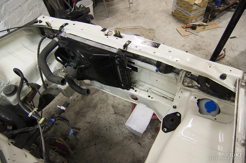

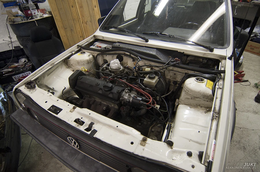

Here is how the engine bay looks like now, after some cleaning and a little touch of paint:

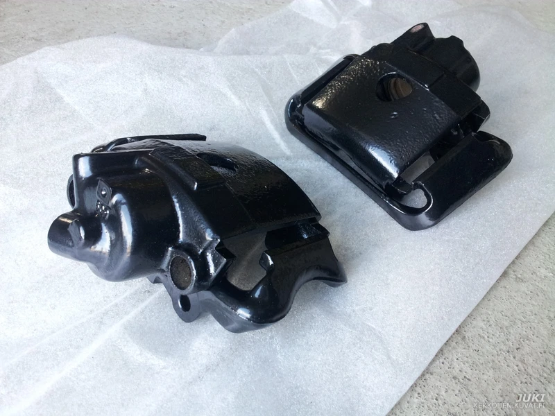

And here are the brakes after powder coating:

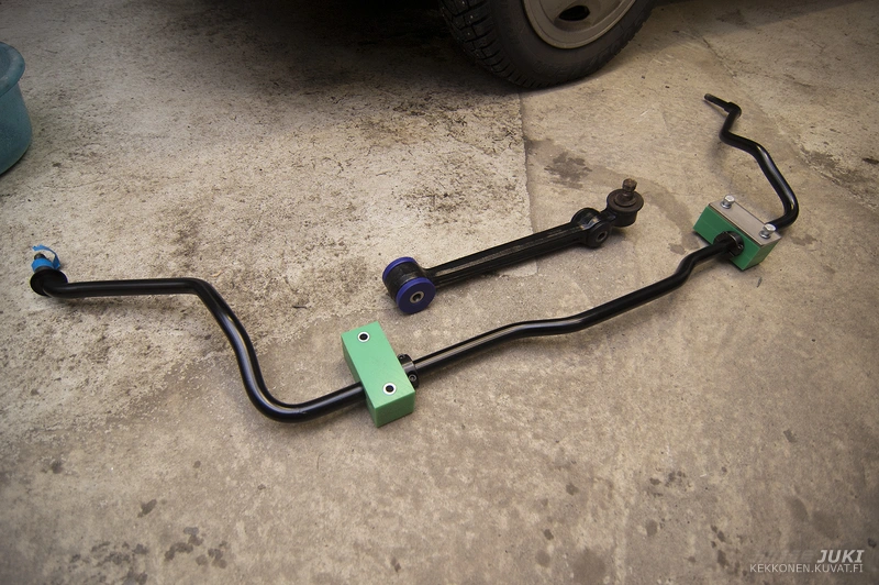

ARB blocks and bushes:

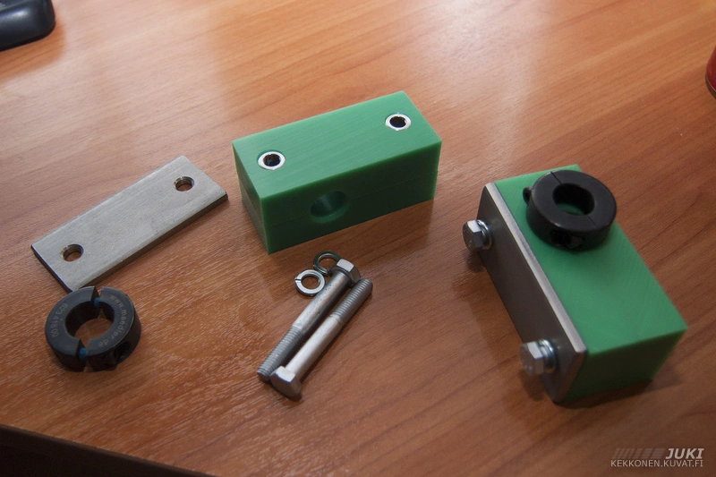

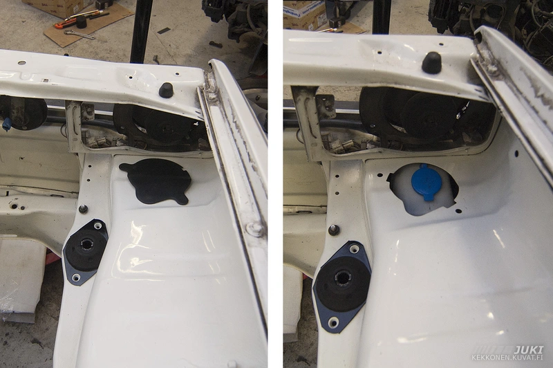

And something that I have worked on, the windshield washer relocation:
