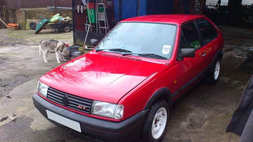

Been a good deal of progress on this but forgot to update. After repairing the bodywork and replacing the fuel tank, turned out the brake ballance thingy was seeping fluid too, so that needed replacing. Treated it to new plugs, dizzy cap and rotor arm too. Now running a lot better, but the fuel pump has started to whine. Anybody know where I can get a decent second hand one from? The new ones from GSF are either £98 or £192 and I'm not sure which one i need. Either way, it's a bit steep!!
Anyway, quick pic of how she looks at the moment:
Still needs a proper polishing, but much improved from before. :-)

Thats a hell of a transformation, Keep it up :thumbsup:
Cheers Mike. Been a lot of long days at the weekends, getting it to where it is so far. Hoping to be taking for it's MOT in a couple of weeks, then I can start enjoying it, but this whining fuel pump sounds awful from inside the car, and no breakers seem to have any. :( Plus, after closer inspection, the ones on GSF are labelled as "in tank" pumps, but the one that making the racket on mine is outside the car, underneath it, at the back on the drivers side. It still pumps, but if it's making that much noise, I doubt it will be pumping for much longer.
What a transformation. Thats some good going 8-)
cheers bud. Doubt it will ever be as nice as yours though!
Yeah that's brilliant work mate, looks stunning in that picture! I wish I had the motivation to wax my car that well, I get bored too easily!

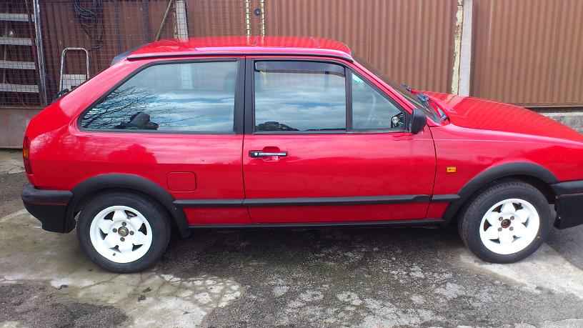

Good news everybody. Another Polo has made it back on the roads! MOT passed today.
it's been a bit of a mission, especially seeing as i have no eprience of cars, but i got there in the end with a lot of help from a good mate.
to get it at is in the picture, i've had to:
Replace the radiator, fuel tank, wheels and tyres, front discs and pads, rear drums and shoes, rear master cylinders, brake bias control thing, plugs, distributor, rotor arm, thermostat housing, water temp sensor and gasket, exhaust manifold gasket, and in-line fuel pump. I've also had to repair the in-tank fuel pump and various bits of pipework, as well as the battery tray and some rot down by the bottom of the rear arch on the drivers side. I'm sure there's more too but thats all i can remember for now.
She's had new fluids all round, and a bloody good clean, inside and out.
Still to do:
I need to find some suitable centre caps, but am having no joy with that whatsoever, so if anyone knows where i can get some raised centre caps for a 66.6mm bore, i'd be grateful for the advice.
I also need a drivers door bump strip, as mine has bent at the front and wont straighten out.
I've got sunroof seal and lifter arms on order too, so they'll need fitting when they arrive.
I've fitted a blaupunkt toronto 420 bt too, but that has no power at the moment. need to get to the bottom of that.
Anyway, i hope you all like what i've done to her. Maybe see you out and about soon! :)
