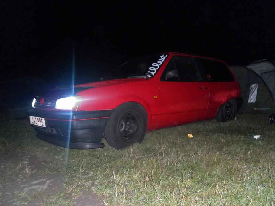

Hi just wondering if any one would be able to point me in the right direction of what tires would fit on 13" 7j 4x100 alloy wheels on a mk3 breadvan dropped 60mm front 40mm back.
The back also sits a bit more lower as i've lost my boot space to a sub box :)
I presume the arches may need adjusting but not 100%, advice would be much appreciated. Thanks

You will struggle to get 6j to fit on a breadvan, let alone 7j without a lot of rear arch work. As tyres go, get the thinnest possible and stretch them over so they don't hit up inside the arches.
155, or 165 by 55 I'd say.

I have 5.5 j and I've had to roll the arches to be able to have any weight what so ever in the back. Camber shims might be a route to look into aswell? Also sorry to go off topic here. But what splitter is that on the front? I've been after one forever.

the splitter is off a 6n polo pretty sure renault laguna splitters and mk3 golf splitters will fit too.
Also atm I'm running 155 65 on 14" 6j bmw rims. But ones in the pic are original steelies.

Sweet. I'll look into that. And I've just bought some ats classics and the tyres on those are 165/55. And they scrub out in the rear :/ its been lowered a good 60/70mm. So I guess I was asking for it haha

Yeah 7j is gonna need a lot more work than just camber shims or a little roll of the arch :p. Still. I reckon it'll look sweet :).
I'm running 14" x 6j on a 155/55r14 tyre and I'm as low as fuck, just folded up the rear arches a bit

The offset is ET-7 thats quite a bit of dish isnt it??
Thats MINI offset, low.... You will have fun fitting them!
Hammer, can fit anything! Be tactical with tyres, 165/55's are a nice fit, little bit of stretch but dont give stupid ground clearance compared to the likes of a 195. the 195 is also a square sidewall so wont help you clearance.
Get on tyre stretch and decide what you can manage, I've seem 135's on a 7 before now!

I'm running 155/65/13 tyres on 13x7 et20

Little bit of a tap and they fit without scrubbing, however I'm running mk1 coilovers. There is ways to get them to fit but in theory your wheels are 1" wider than mine and assuming Ben is running a similar offset to me, you'll need to do similar to what bens done as they'll sit very similar.
You may also want to have a think about the fronts as you're gonna have about an inch of pole again at the front which mr plod won't like.

been a while since I've been on here now and since then I've got a set of 13" x 7J revoloution 4 spokes to slip on the breadvan, all with the help of the arch roller i bought, not too sure if it will work on back as its a straight arch but if not its okay i got a few big hammers :p
