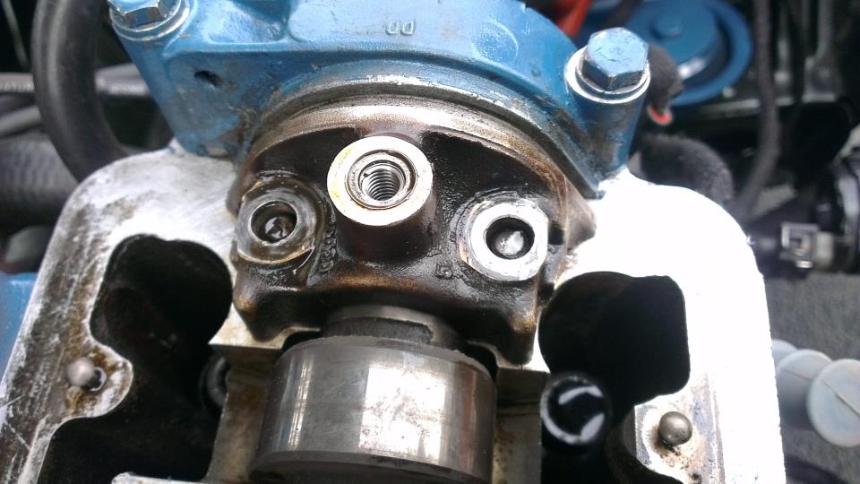

today could not get any worse , was changing over my ABD cam for the GT cam, and port 5 bolts have snapped, guessing i need a new head, any one have a GT head or an ABD head or an AAV head? need one ASAP

You can get them out. There shouldn't be much tension on them no, so you can try 'drifting' them out with a hammer and drift
You overtightened them. There only sposed to be around 10NM or something like 6NM +90 degrees
You could try a chisel to put a slot in the top and use a screwdriver but thats too difficult tbh
Id drill a small hole in the middle not too deep, then see if you can turn it with a screwdriver or something.
If not go to your local toolstation and grab some easy outs

Can you not just whip the bearing cap off, and get a pair of mole grips around them?
That's how i get them out when i skim heads.....
Yeah if you get the stud out with some mole grips (try locking two nuts together or grinding some flats on the stud if it slips) you can just fit another.

You wont need a new head!

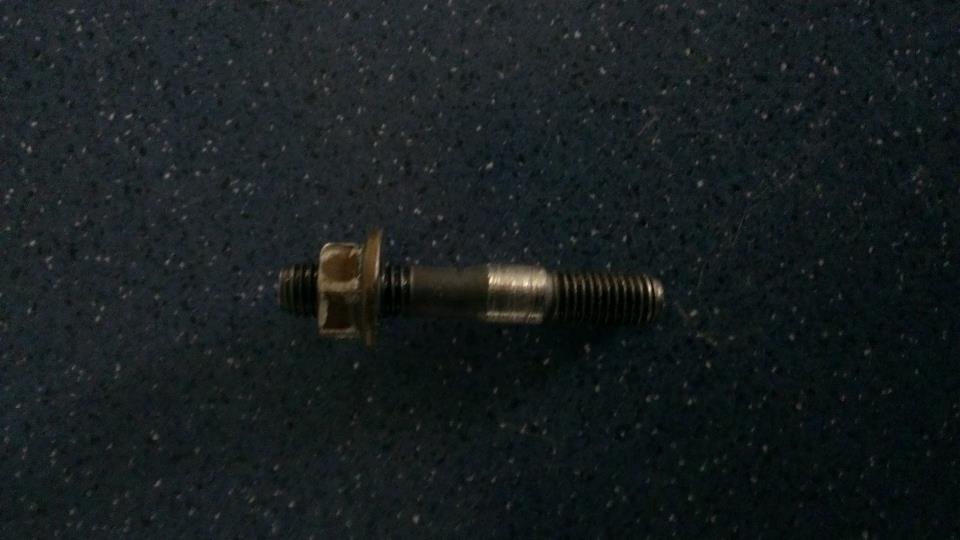

Just take the cap off, and grip the studs with a mole grip. Unwind them out, replace with new studs, or second hand ones.
funny that the studs have broke though, usually the cap breaks if your not doing it square etc
i have got them out earlier , just need new studs . did some one mention the size in a previous thread ?
