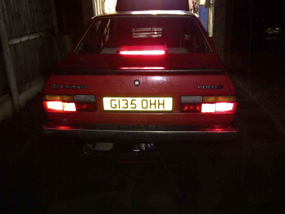

I've fitted a towbar and it hasn't totally ruined it.
Good progress bud, do you mean new custom exhaust hangers on the bottom of the car ? Get some pics of then too :-)
No I need to replace one of the existing ones at the back as it's lost all its strength. There is an extra one through the boot floor that is helping but it could do with a second one on the other side as the backbox doesn't sit very level
All the major stuff is finished and it's being taxed tomorrow! :-D
