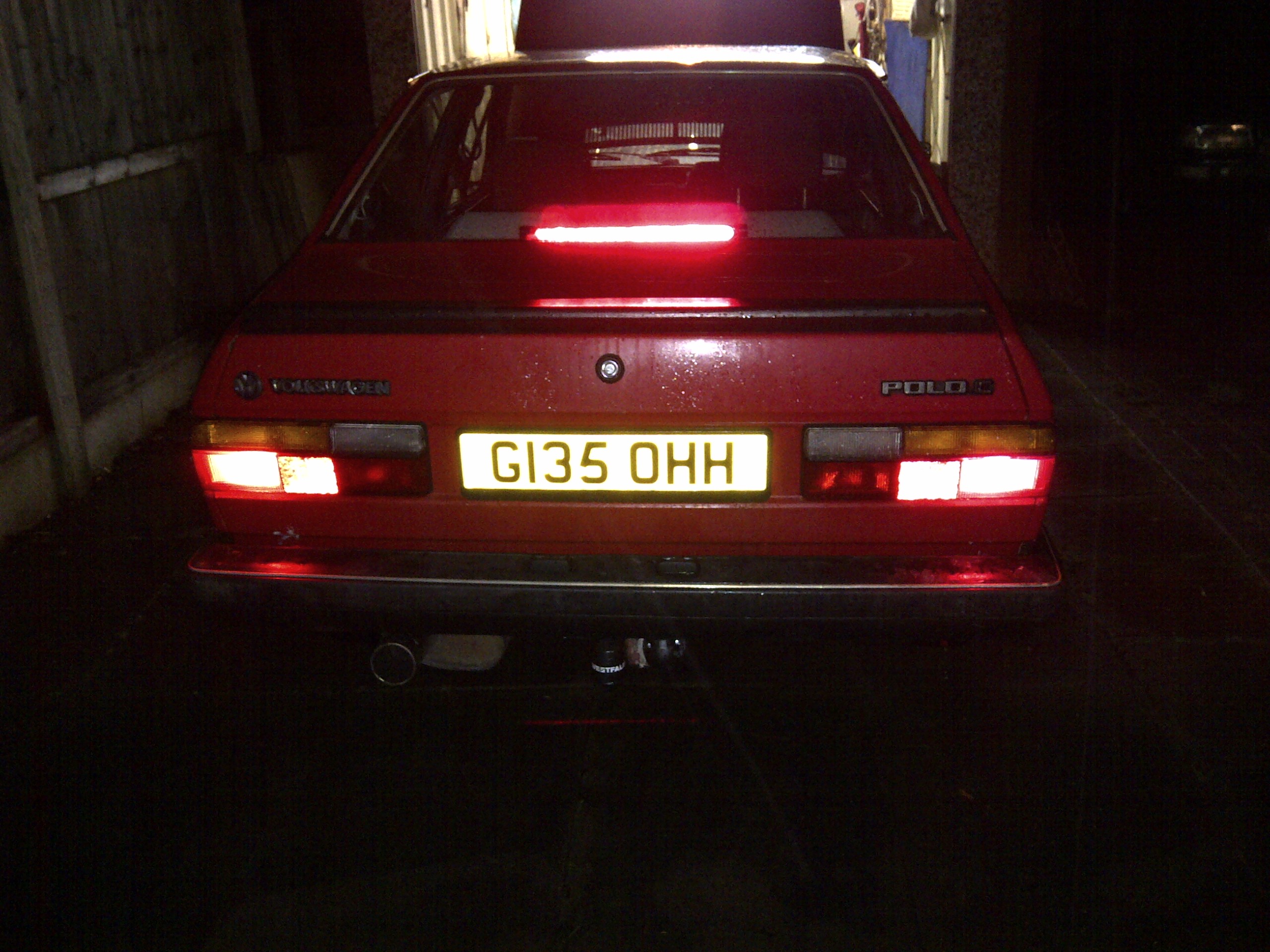

Here is a photo of some things
Here is a photo of some things]
Haha gay lol . Well done tho gaz :-)
Spoiler is awesome but the extra brake light is too long, get a shorter one in there!
Ha! I wanted one the whole width of the car, like a honda nsx. Fortunately for everybody I don't think they are easy to get. This one has 56 LEDs in it but on the back of the pack it said they did ones up to 80 LEDs but even then itd be a mere 2 feet wide. :lol:
