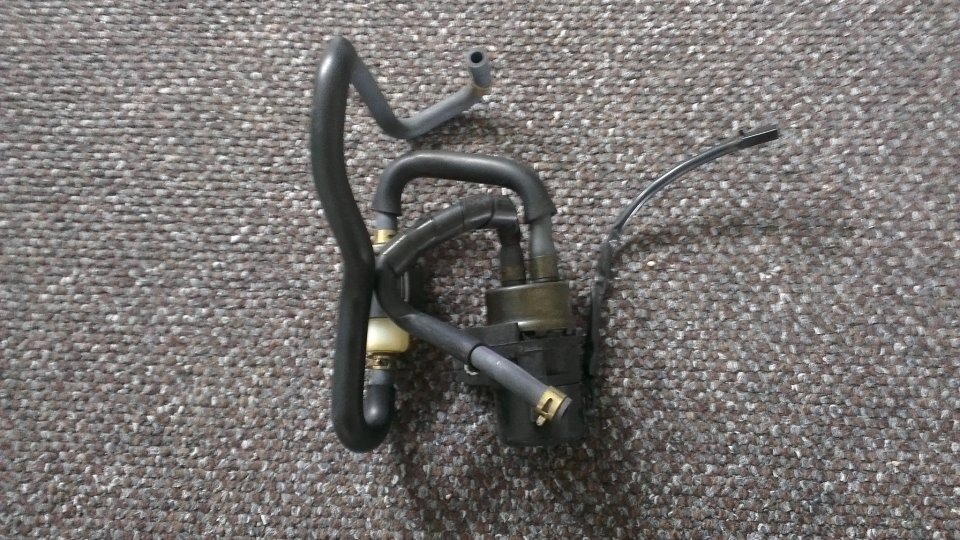

I'm curious to know how to fit a bike fuel pump to to supply my bike carbs, iff you have done it can you please explain how. I'm assuming it replaces the inline fuel pump as this regulates the pressure the fuel goes to the throttles bodies. Is it just a case of removing the inline pump and replacing it for the bike pump, then connecting it to the loom connector under the car ? i haven't actually looked under there or have a good idea of what it looks like. This picture is my fuel pump i will be using. It has two small hoses coming off it, one has a small air filter in line of one of the hoses and the loom connector is two pins. And the hose with the filter will this be the hoses that comes from the fuel tank ?

You basically need a live 12v feed to the red, and earth the black. Ignition fed live, ideally with a fuel cut off inertia switch.
On your pump, the fitting with the filter is the connection to the tank, the feed "in" line, the other is what needs connecting to your carbs.
Worth adding - on a bike the tank is above the pump, thus making the pump almost gravity fed, whereas you'll be relying on it to drag the fuel out the tank - it may increase the wear rate on the pump so keeping an eye out for a spare maybe advisable.
After around 8-10k mine is fine, no hesitation on long journeys or any fuel leaking from carbs/breathers and such.
Regulator method IMO is just pointless, facet's do work too; but to be honest you can pick bike pumps up sub £30 and work spot on :)
