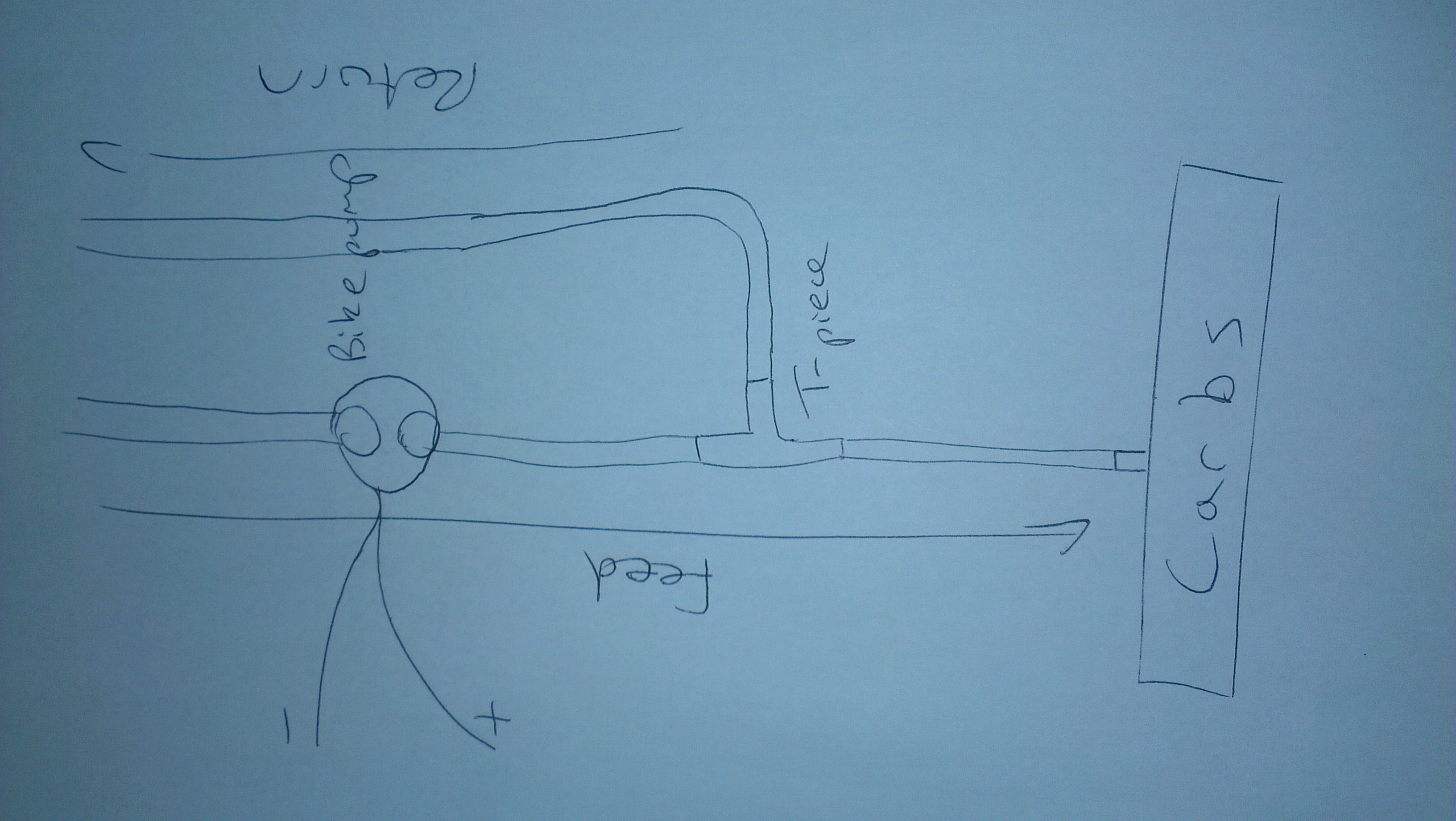

so i think i have come too, remove the in line pump and put a filter king in its place ? then in the engine bay add the bike pump onto the in fuel hose to feed my carbs, wire my pump in add an inertia switch, and what shall i do with the fuel hose that was the return ?
Also because i have a mk2 tank, could i just remove my intank pump, ad a mk2 mechanical one, use the two inlets on the bottom of the tank, join them both with a t piece, so i have one fuel line, feed it to my bike pump, then my carbs ?
I'd suggest running a t piece with a return back to the tank.
Then should the pump for any reason not self regulate (this has happened to me before) it'll stop fuel pissing out of the carbs into a warm engine bay. It catches fire easily (yes, it happened to me).
So you'd have mk2 tank, clear hose is the feed, bluey one the return. Put the feed into a facet/bike pump then into a t piece. Have the straight t going to the carbs then use the 90 degree bit off the t as a return back down the standard fuel line. No need for a pressure regulator.
It's a proven, well trodden route that works.
Also, everything you've asked here is covered quite comprehensively in the FAQ thread. People will soon get fed up of answering questions already answered countless times on the forum.
Yes I know , like I put previously though , 800 odd comments , and it has been hi jacked with pointless banter , here needs to be a 1 or 2 page definitive guide with pictures in the faq , step by step on how to fit carbs with a bike pump and all mk2 bits .
Ok like this , it just confuses me that fuel feed and return go down one hose then split off . The hose is 10 mm isn't it , will get me a t piece , remove the old inline pump and join them up . Will order hose too .Just need to sort the choke cable .....
if you are using a bike pump then you don't need the Tpeice or return. As the fuel pump will cut out when it need to.
I've tried using a bike pump (admittedly not on a polo) and it wasn't shutting off. The way the carbs are on a car compared to a bike apparently mean that they can work at alot lower pressures. So putting 5psi of fuel pressure into them caused petrol to run out of the overflows. Because it was overflowing, the fuel line pressure wasn't building which then meant the pump wasn't shutting off.
Might of just been a duff pump but it came off a running bike...
Way I see it doing the t piece is just a good fail safe.
Lol yep that's what I said , join the inlet and out let so there is only one feed, add a filter king were the old inline pump was , fuel line to bike pump in engine bay , fuel line to carbs , no return , then ska wars mentioned a t piece , so I did that diagram . So t piece or not is the question lol
If u run a t piece u defeat the object of a bike pump.
May aswell run a facet pump and t piece.
Yea just like that :)
Can't be sure on a 2f but on my mk2 the fuel hoses are 6mm inner diameter, and the hose on to my carbs is 8mm ID. So I used a 6mm brass T and the 8mm went on with a little push.
x2
My bike pump is fine tbh, iv known them constantly run but not have them overflow..maybe your needles in the float chambers dont have the best of seals?
