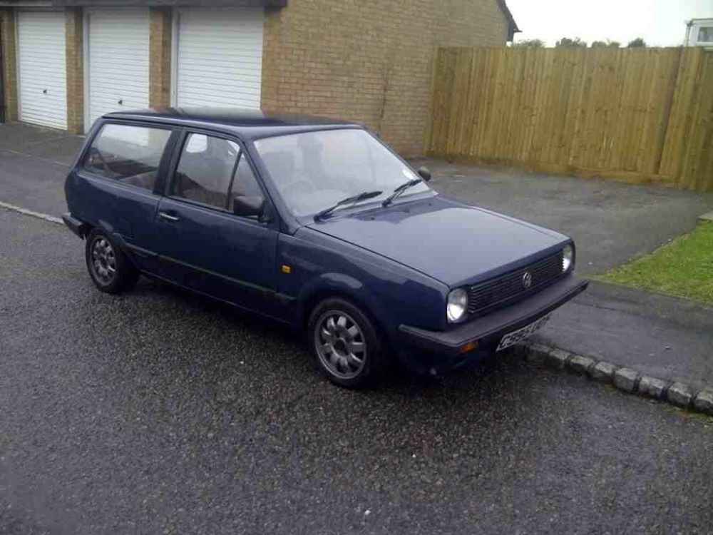

I have got a set of 13" 5.5J BBS MAHL wheels.
yet to collect them but the tires are shot, what size tire would look right don't really want any stretch but i will be lowering a 60/40 or near there.
What's the offset? They are usually quite low aren't they? Quick google says ET18. :shock:
Tbh I'm not sure and the guy hasnt looked yet.
I'm going to look at the standard steels and see what the difference is on willtheyfit.com guessing the et at 18 as you say.
If these are et18 would I be correct in saying these will stick out 4cm further than stock steels?
I think they're usually ET13, so they'll catch on your arches.
13"x6" ET13 on a breadvan:
Just had them checked and they are et18 thankfully
i am stuck with tyre size though not my forte.
can anyone help with tyre size for 13" 5.5j with et18 on standard mk2 polo breadvan. will also be lowered soon 60/40 or similar
165/55 r13
165/55 r13
thanks buddy :-)
