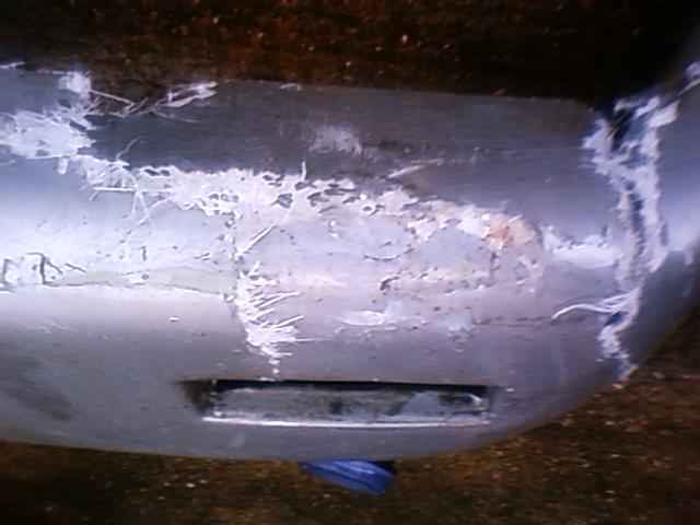

Anyone dislike my front spoiler?

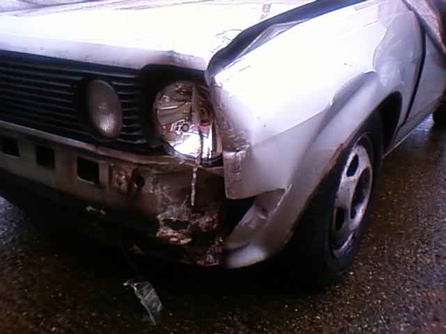

Kissed the back of a Honda Jazz with the front of my Polo at about 10mph this morning. My fibreglass frontspoiler took most of the impact.
And nearside headlight, grille, wing, front panel, bonnet are all crumpled.
Pretty sure the metal can be straightened (if chassis not bent) and panels replaced.
But fibreglass repair - how hard is that?

I originally fitted it to cover corrosion in a front panel, but it has been a pain since I lowered the car too.
It's declared on the insurance as front-spoiler/air-dam, but age/value of car means its up to me to sort it.

Will see what nearest good bodyshop says about the metal this morning.
We've repaired worse than that at my work :-).
You'll want to use something like thin metal plate, and fibreglass matting, to re-inforce it from the back, then a bit of fibreglass and filler on the outside to gain back the shape.

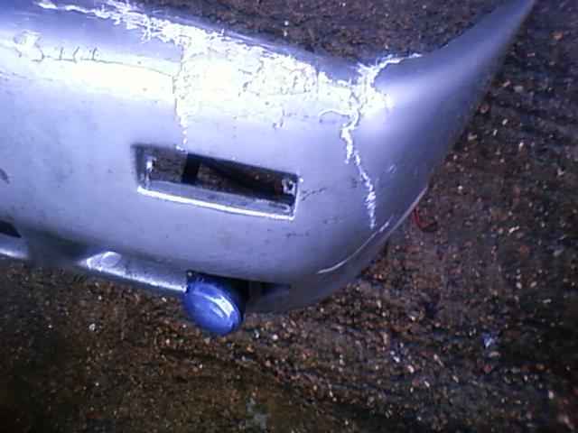

There's a mounting lug that's structural and broken off.
Guess metal could replace that.

It won't be an easy repair by any means, but I still stand by what I said :-). Ideally you want to get the shape back primarily with something like plastic padding paste as its a bit more flexible than filler and contains glass fibre strands, then skim with a bit of bog to get the final shape. As long as its a light skim it shouldn't crack.

Still waiting for the metalwork estimate.
Nice bodyshop man said it will be, I quote. "a lot", due to cutting and welding work.
Odd, I thought the straightening and painting was the big labour intensive part.
But, I can use an angle grinder and I've done small welds before, so I might end up doing some of the prep.

Thanks for that kind offer. Bodyshop man thought it might just about bend back.
We'll see. Impact was slow and car is low it didn't take much of a hit

Bodyshop's waiting on a price/availability for inner wing panel.
If they're using imperial, it'll come back as unavailable, i'll send you a few supplier links when i'm at the pc.

Think they must be. Now wondering about repairing the inner wing with corresponding higher labour time :doubt:
= about 21 hours total because he wants to do the cross-member too and I had suggested he mend a small dent that my offside wing has had since I bought it as removing and refitting that wing for access anyway.
