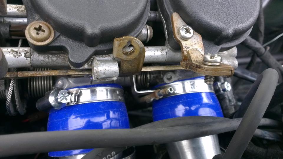

Why is there no clamps on the manifold?
Make sure the carbs have filled with fuel first, make sure there's spark, don't guess..
Also, the throttle cable doesn't look to clever in it's position..
turn it over while holding the choke accross
i took the photo before i put the jubilee clips back on

my throttle cable is not attached the the pedal, when it is it sits in the wheel nicely

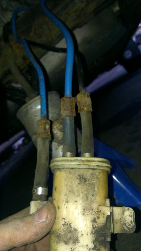

i know all you need to do is use one feed, blank off the return, and leave the carbon canister wire to vent. but looking at this picture, i couldnt realise which hose was which without tracing them back, which i couldnt because of what i said earlier.

Like I said , because I can't get to see the hoses , or pull them through , I don't know , reason being thicknesses change don't they , and colours could change ? But iff your saying they are colour coded then I might take a look . I think.some one said the accumulator acts as swirl pot , helping to prevent fuel starvation from the lift pump in the tank when going round corners at speed ?
You don't need to get to them, iv said this. Lol.
There's two blue two black, join black to black, blue to blue, with relevant reducers and hose.

lol yes i know that now, was just saying because i couldnt get to the rest of the hose, i didnt know iff they changed colour or thickness .

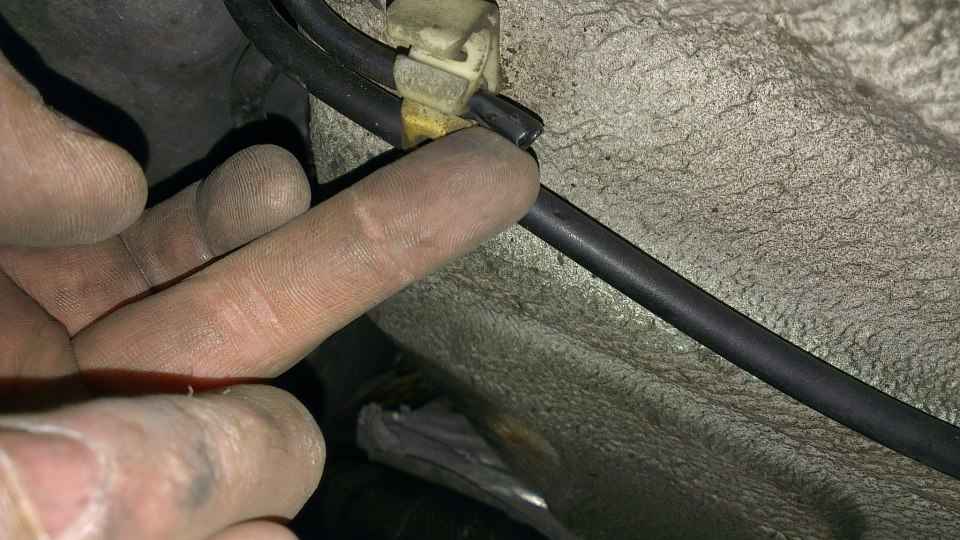

here is were i cut the carbon hose to vent, just before the petrol tank, is this what you did ?

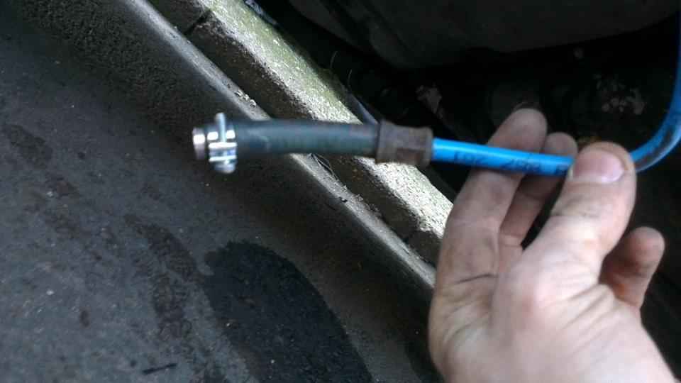

here is were i cut the return and blanked it off, same place just before the petrol tank, is this what you did ?
Can't even remember, I think you're making it a lot more complicated than it needs to be though
lol how have i ?? actually i asked these questions before and you said you couldnt remember how you did it. so i went and did it how i thought it could work, now your back saying how to do it lol, would have been easier iff i new this when i did it :lol:
iff you joined blue to blue, which is return , then did you leave the return hose plumbed in and blanked off the hose in the bay were it originally finished to attach to the throttle body ?
because since i have deleted the return hose back to the tank and blanked it , should i just not join the two blue lines, and blank the one there from the inline pump and bin the rest upto were i have blanked it ?:shock:
