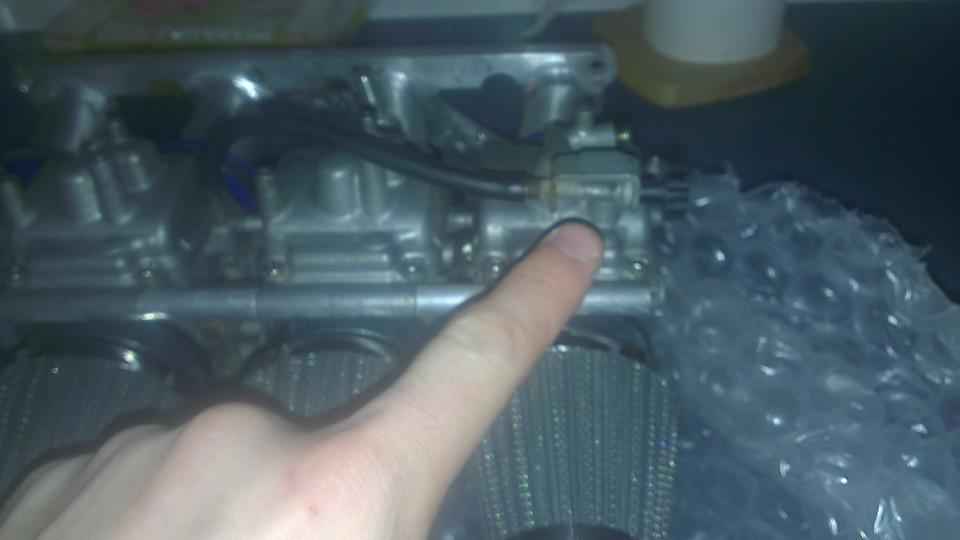

My idle control.valve , how should I have it ? One full turn open ?

And what's all this about an idle control valve..?

i cant work on it in the dark ! lol, and i mentioned the 1342 clock wise about four times above and no one said out, i looked in haynes and it just said 1342, not clockwise or anti clock wise. so ok cool anti clock wise, I'm on it today, hence being up early, just need to do the choke cable and get it going. yes the idle control valve allegedly, before i posted pics of my carbs asking what all the bits on them were, there is a small black knob that can be turned, and is like on a spring, i think it turns the four bronze flanges to sit open a bit , or close them fully. dont know how to set them.

The idle screw. Lulz.
Yes, it's anti-clockwise. And don't go pumping the pedal expecting it to start, it basically needs the screw turned in a few turns so you can see the plate it rests on move about a mm or two.

It's jus an idle adjustment screw man, it just has a long flexy thing on it to make it easier :)
