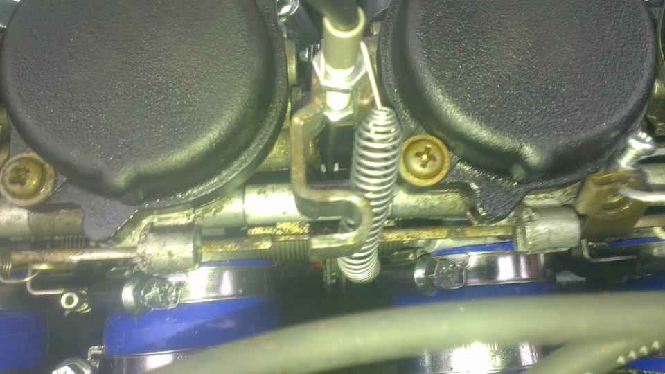

every thing was set up correctly, just needed fine tuning ect, only extra thing he did was add a spring to the throttle wheel to give it more of a pull back.

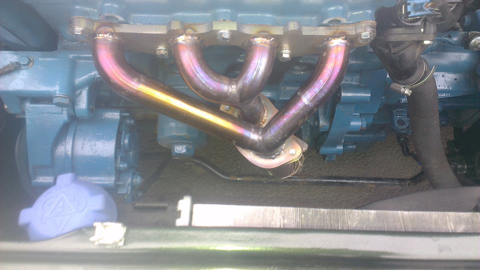

also here is a pic of my custom manifold fitted
