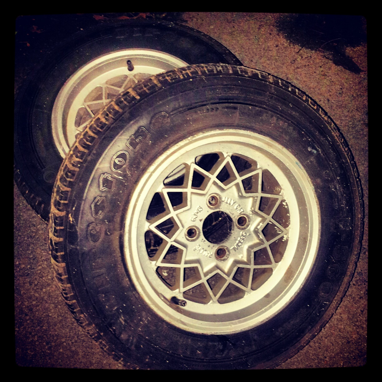

put some pics up of the wheels. if they have tapered wheel bolt holes, then spigots arent essential providing they are deffo 4x100 pcd
[me=g40jon' date='Saturday 29th December 2012 - 10:47pm' post='2461445]
Apologies for the instagram shot, the original was too big to upload here. You can see that they don't have the volcano type centre part. The lug holes are tapered and definitely 4x100 but I will probably make some spigot rings for piece of mind. Thanks for the help everyone :)
id happily drive them with no spigots tbh
Fuck spigots, think of the weight
What was I thinking. Weight first, safety later
Exactly (:
