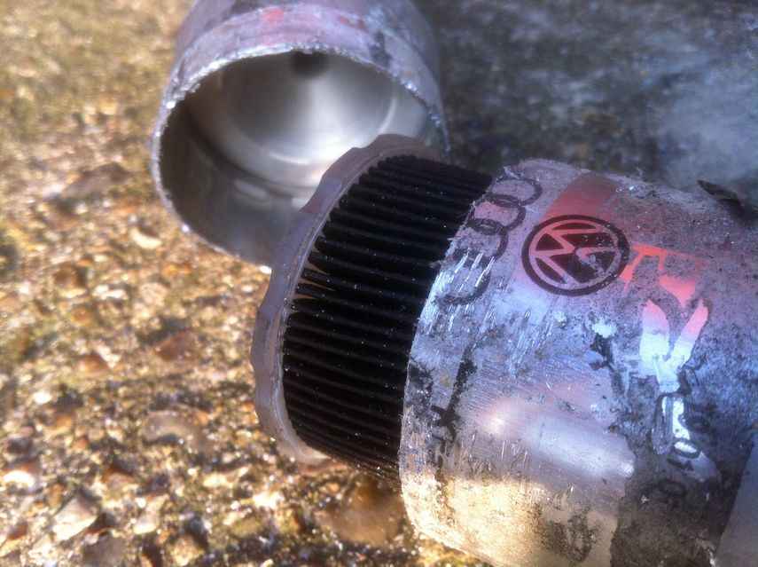

Here's mine... take a good look at the clips!

That's a good photo of the old filter, I too have cut these things open and can't believe just how much muck there is inside. When all of the petrol has evaporated, you are left with what looks like very fine sand.

I found it easier to push a flat head screwdriver into the push clip and then just pull the hose off, then unscrewed the filter bracket. Car idles much better now!! Can't believe the sediment that came out of the filter!!
