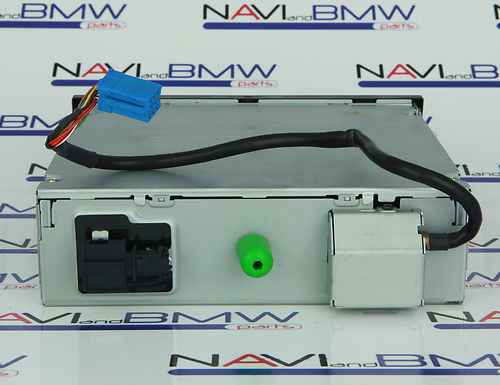

As far as I know you can't use both, the end of the lead from the boot CD Changer replaces the one from the single CD. Have you thought about the single DIN CD Changer that fits in the dash rather than the boot mount?

This is the back of the 6-disk unit. It shows the blue plug which replaces the one currently used by the single disk player.
They don't have a cartridge, you feed the disks in and it saves them inside.
Ah right, I see. I might look into getting one of them then.
I've ordered a cheap cable that goes to the boot for the CD changer that replaces the single disk, but it would be more convenient if it was in the dash.
