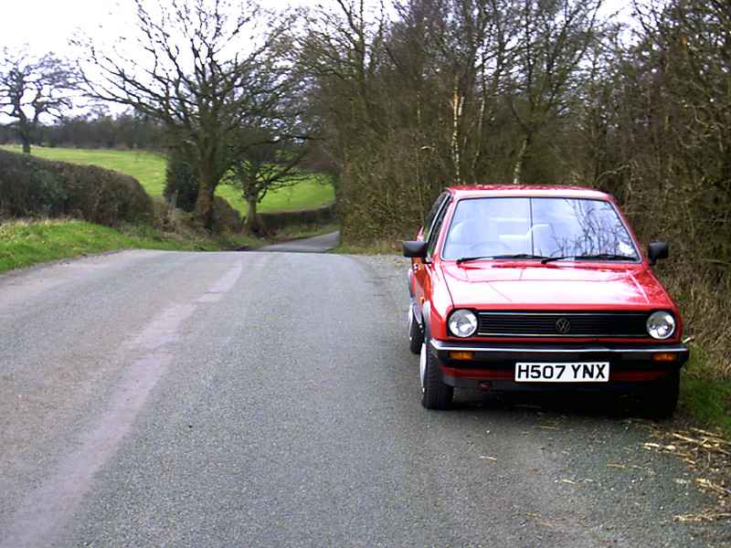

here's the car as i had her:
Nice and high! apologies for the rubbish picture quality (on old phone now got a new camera Yay!)
Took a mission to go trailer her back just under 300 Mile round trip but i think it was worth the price as the interior was mint and the body very tidy!

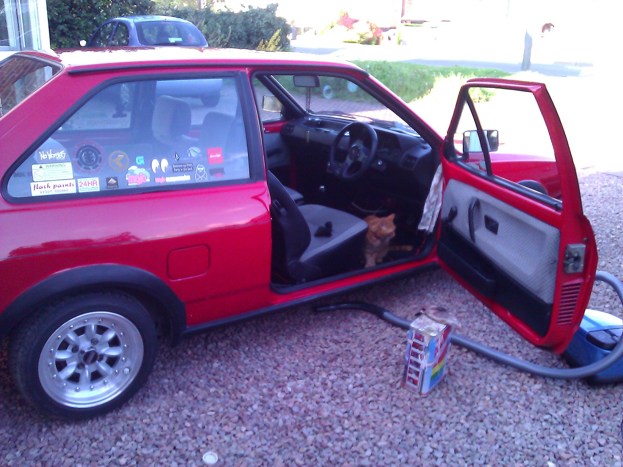

After the drop I needed some wheels, I looked at the usual, Ats Classics, Starmags etc but wanted something a little different, spent a good few weeks looking through forums and ebay and eventually found some smoor roadsters in shite condition but very cheap! as i like it! so snatched them up and got them delivered!
Picture after trial fit and a clean! even the cat likes it!

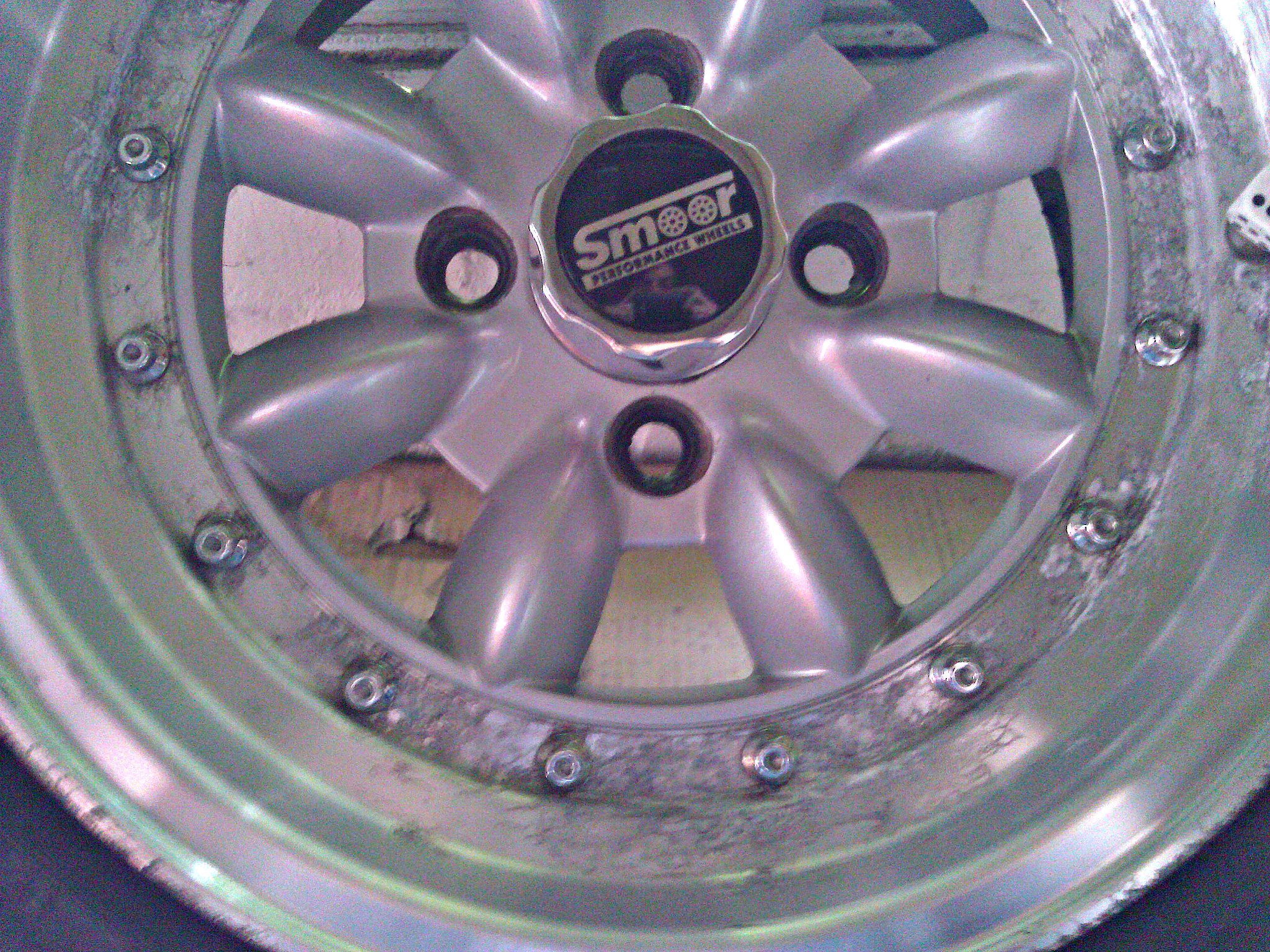

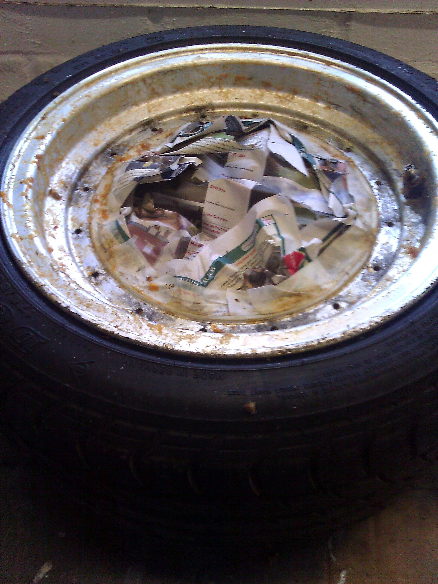

They look good from here but a closer look would show:
So next was sorting these out as the lacquer had lifted and alot of curbing, with no money DIY it was! MORE TO COME!!

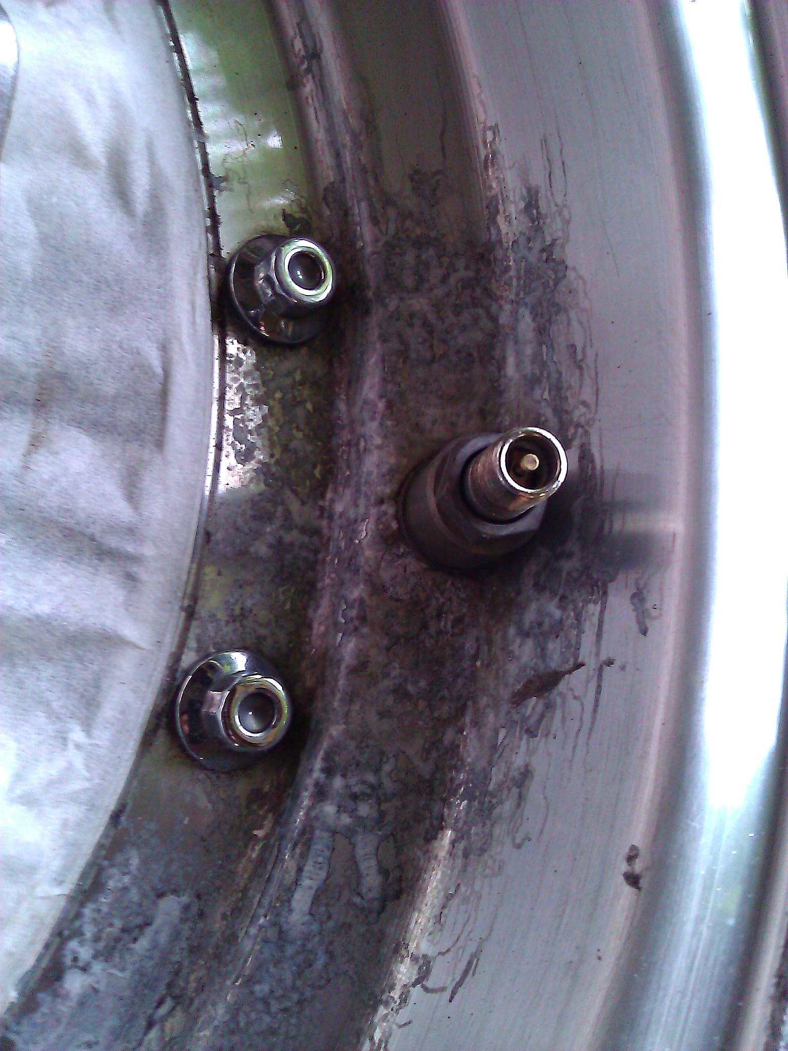

Close ups of damage:
Paint stripper on to remove lacquer:
When the lip was sanded and smoothed nice and cleeeaannn

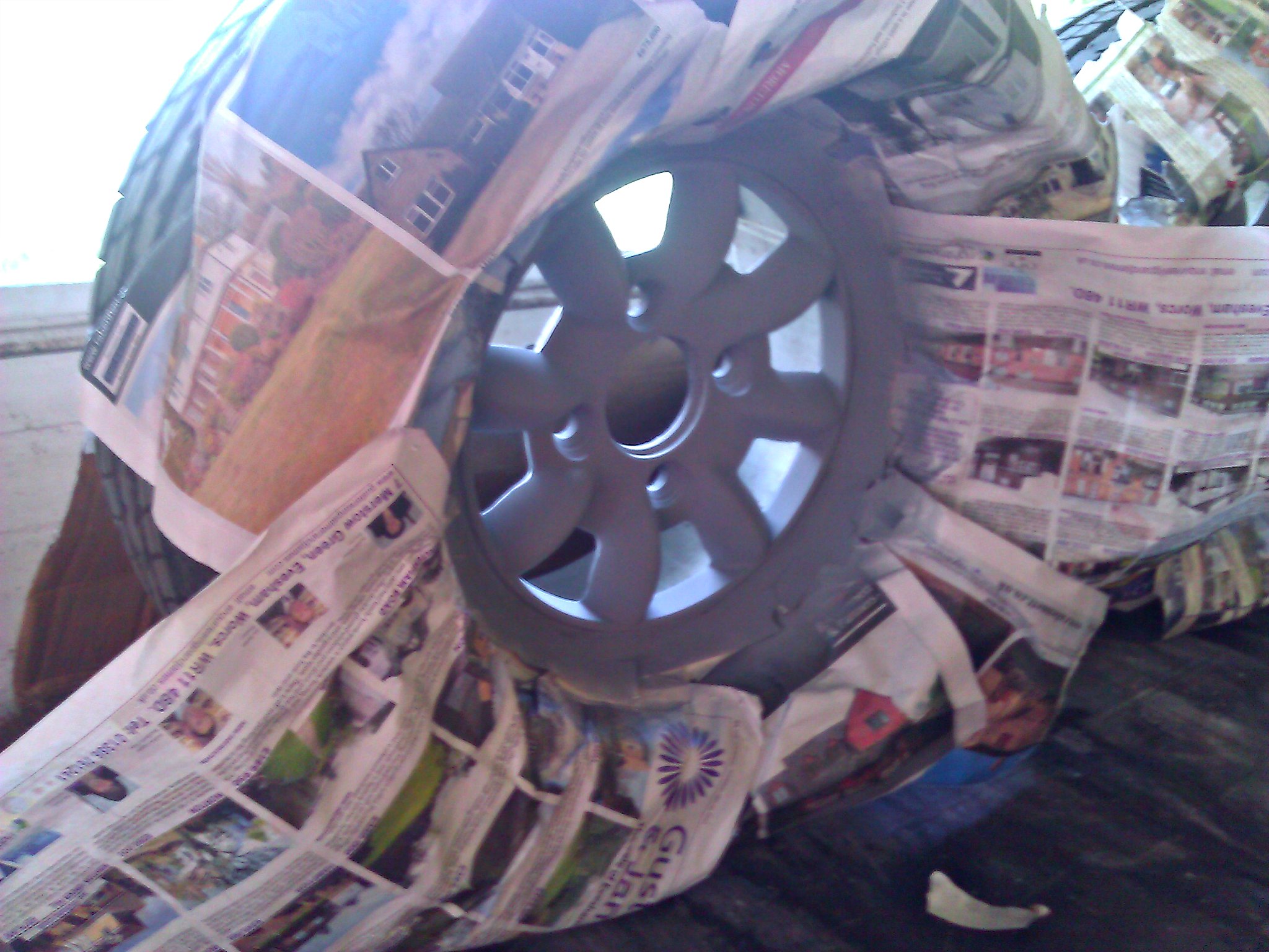

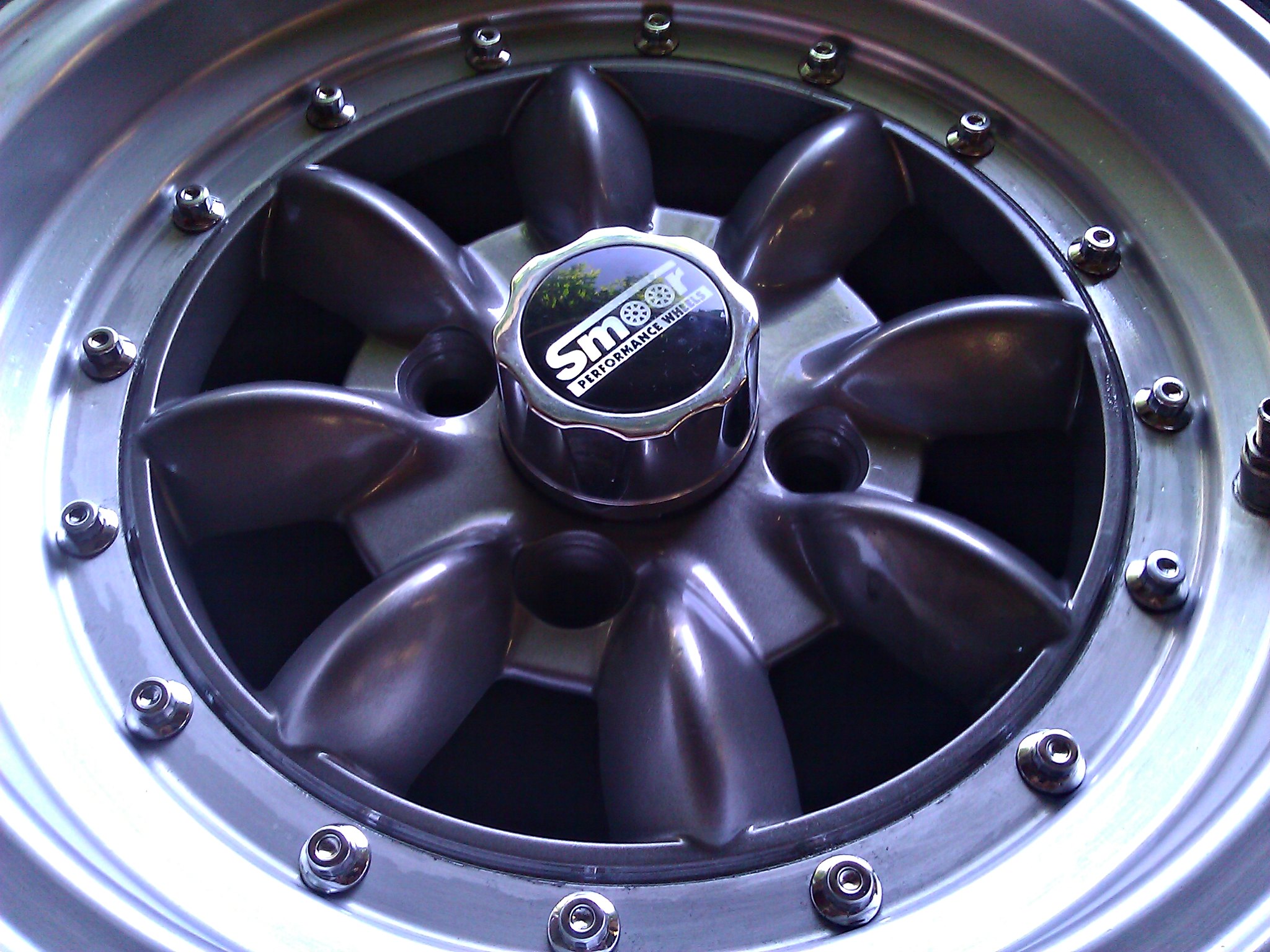

Now came the difficult decision, keep the centers aluminum colour or paint them and what colour!!? i eventually decided some form of grey and after standing in (dare i say it) Halfords spray paint rack i decided to go for MG ZR Gunmetal grey, after being told it naturally it creates shadow due to the paint fleck in (yummy)
I sprayed a dark grey primer after some sanding and then went with the Gunmetal!
And after they were finished:

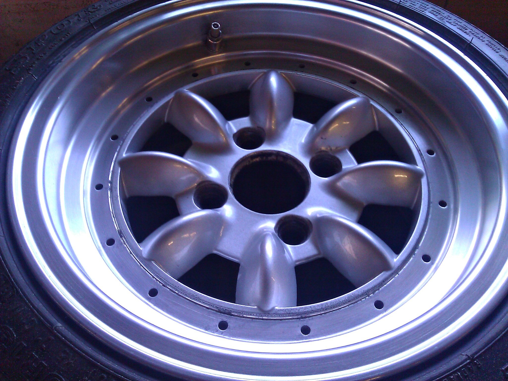

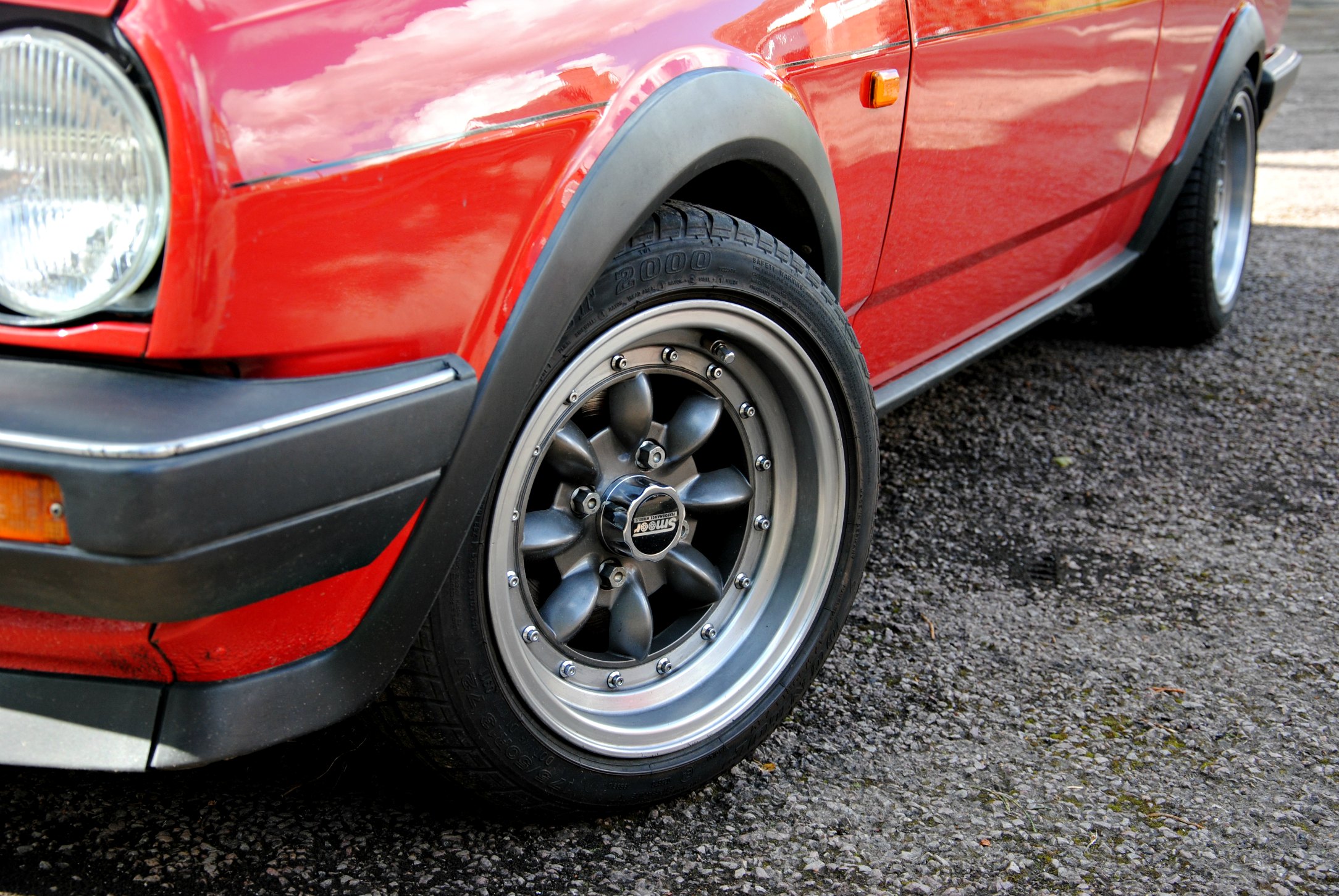

Next i polished the lips well with a machine polisher and got them nice and shiney and then re-lacquered them to save deterioration!

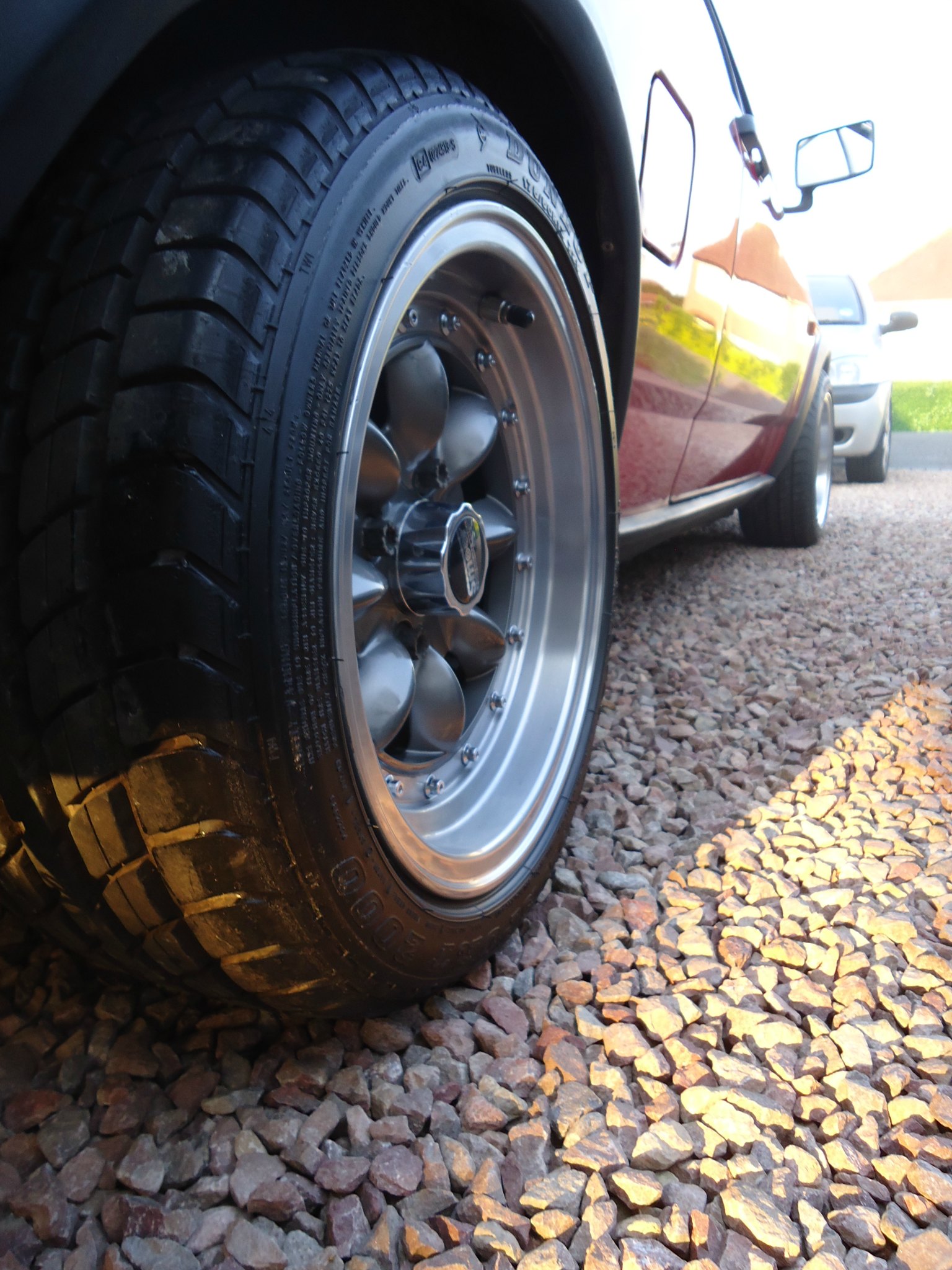

and a picture when they were on the car! think they look pretty fit! opinions?

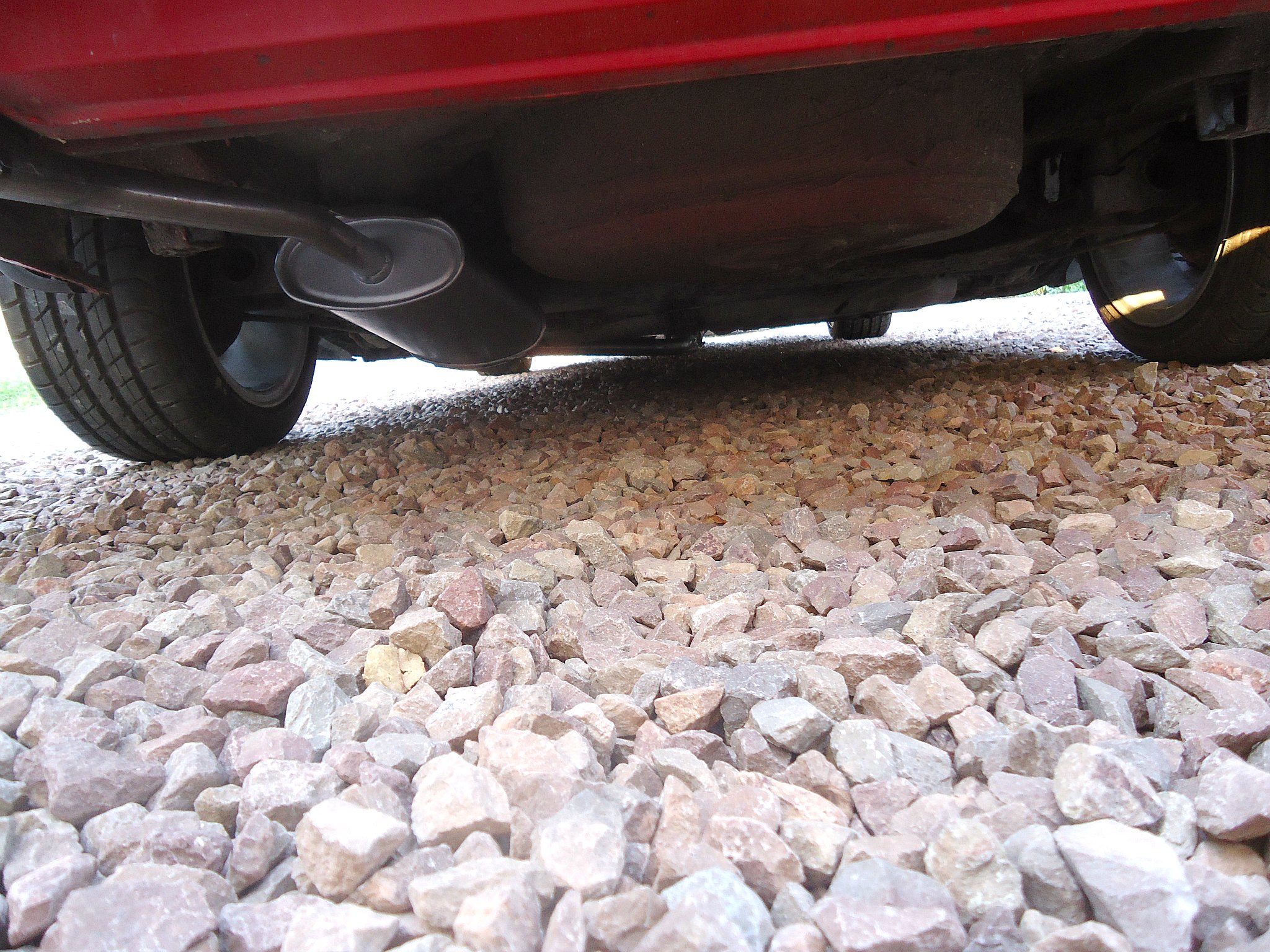

hmm i cant do speed bumps as it is! if i put a straight pipe and got rid of the center box i would be less worried about smashing the exhaust...
I wouldn't be worried about smashing an exhaust dude, its easily replaceable or do what you suggested, chop it out, i have on mine. Regarding speed bumps, just take alternative routes...
what about car parks or through ways where there is no other way?
also its not always the zort that hits its sometimes the sump or this thingy which I'm not sure what it is :S
Go over them at angles, for the love of god don't let your sump hit stuff.

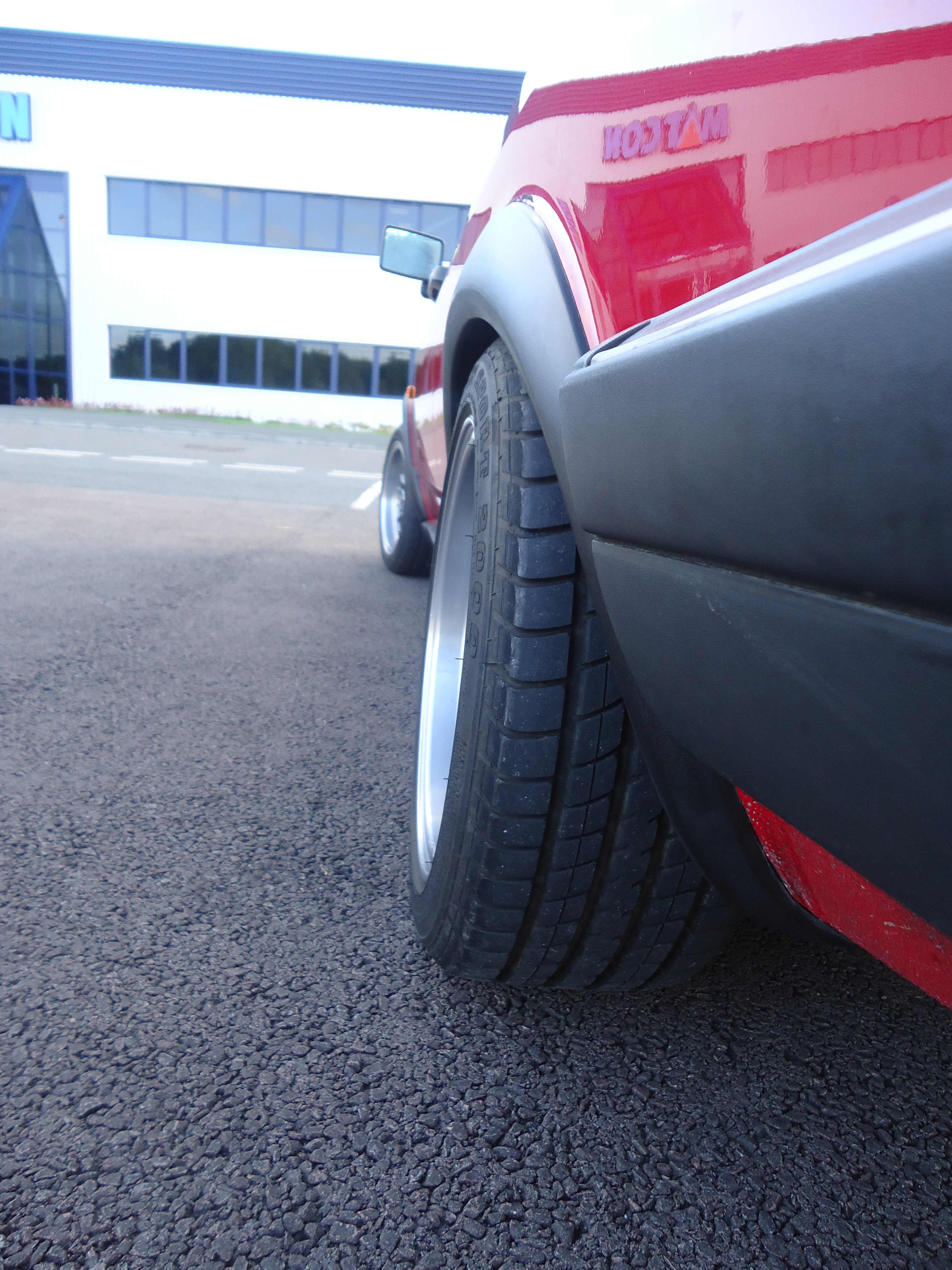

How do i go lower then?
without coilovers and the rear tyres rub if i have anyone in the back (rare occasion) but its bad as it is?
I'm scared
I'm a super low virgin :?
You need to roll the lip on the rear arches. You'll be able to feel a flat lip when you put your hands under the arch, that lip needs to be bent back on itself flat against the inside of the arch, so its basically like a U shape instead of an L if you get what i mean? Its either get coillies or cut your springs for a temporary solution?
I've rolled the arched a little, but intend on putting wheel spacers to make more low and wide but i guess if i go lower they will catch like a biach!
The rear springs are too floppy i think, need to be stiffer, and the front wants to go down only a touch to get more rake?
upload a pic of a side shot of your car son. If you put spacers on, you'll rub more unless you roll the arches more?! you can get higher rated springs which will be stiffer, i think the whole car needs to go down a lot..
I think it needs look lower but dont really want it any lower :L
here's a pic
Thats actually pretty good at the back, see i completely cut off the flat return part of the plastic arch i did, thats how much mine were rolled. they need rolling more so you can lower more and then accommodate for bumps in the road and extra weight of passengers
