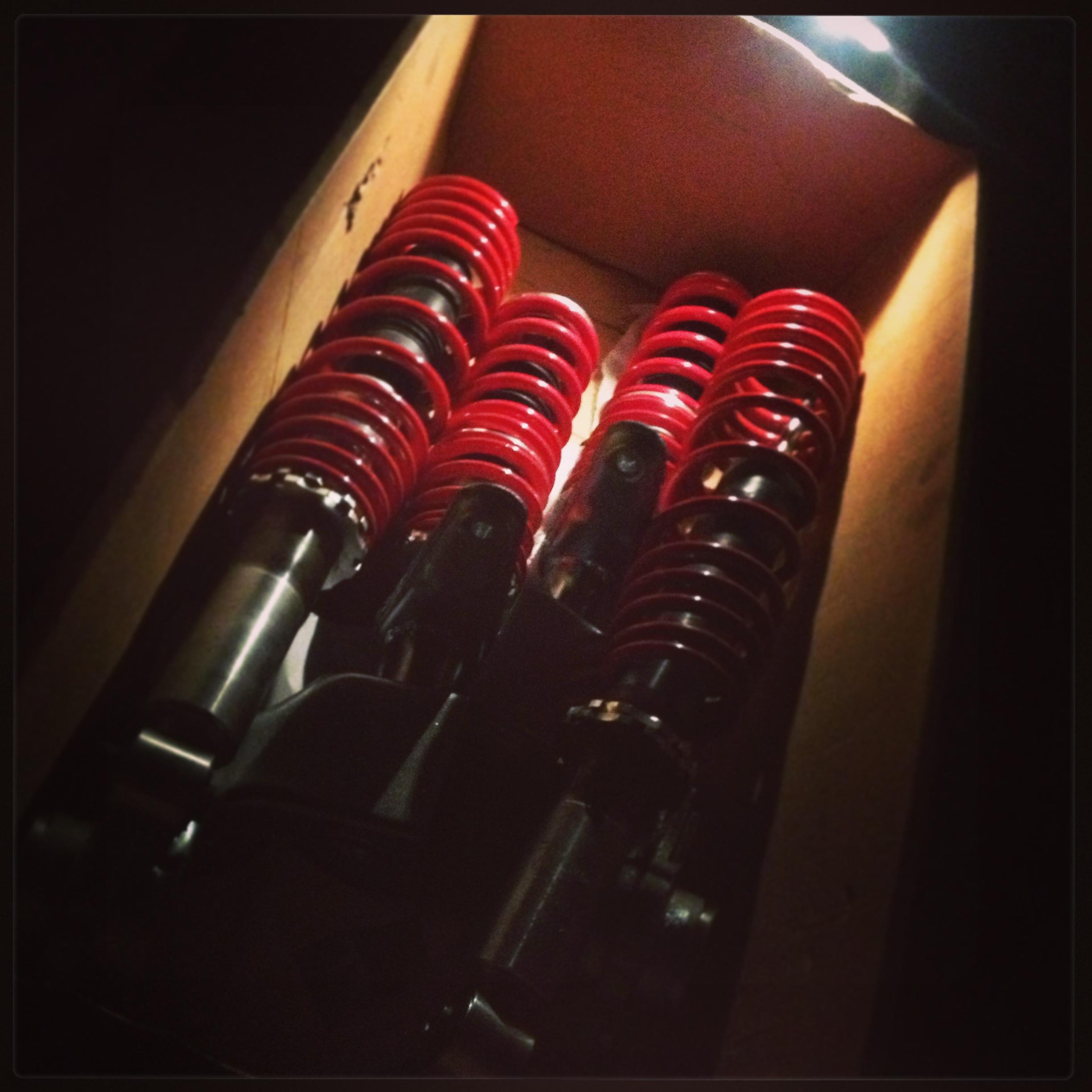

Coilovers are on there way! (thank fuck)
been wanting a set for ages but didnt fancy spending £500 so got a new set off a mate for alot cheaper!
hopefully this will give lows that are required

UPDATE!
haven't done alot recently as been veeerry busy!
coilovers have arrived
fitted the rears yesterday and the fronts are getting pressed bearings as i speak ready to go on this afternoon!
hopefully the fronts will go as-low as the rears, turned the coils to the bottom few threads and it sat on the arches, with 13's "/
so fair to say i wond them up abit! - do have a video of the above and will upload later :)
so thats where i am atm,
should be slammed for tomorrow :D

Take the front helpers out. Save you putting the coilovers on and realising its not low enough and having to take them back off again..... Just what I'd do
so you dont think it will go low enough with helpers in?
I left them on and now have to take them apart again just to get them off... Not low enough, atleast with 13" wheels.
