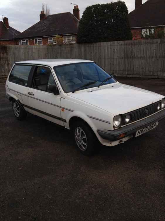

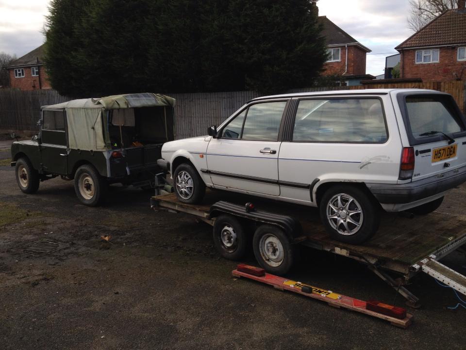

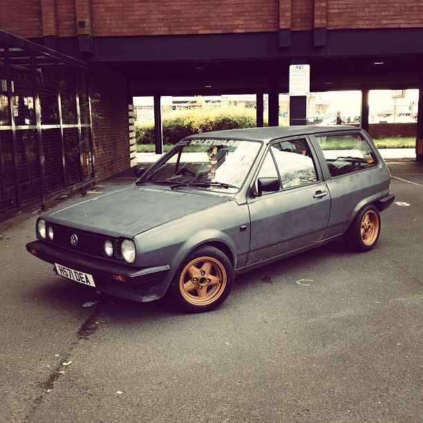

Hi Everyone, This is my first post on Club Polo, and i just figured i'd share with you my project,
a 1990 Breadvan. Its the 1.3cl 4 Speed, and i picked it up for 200 notes!
So here it is!

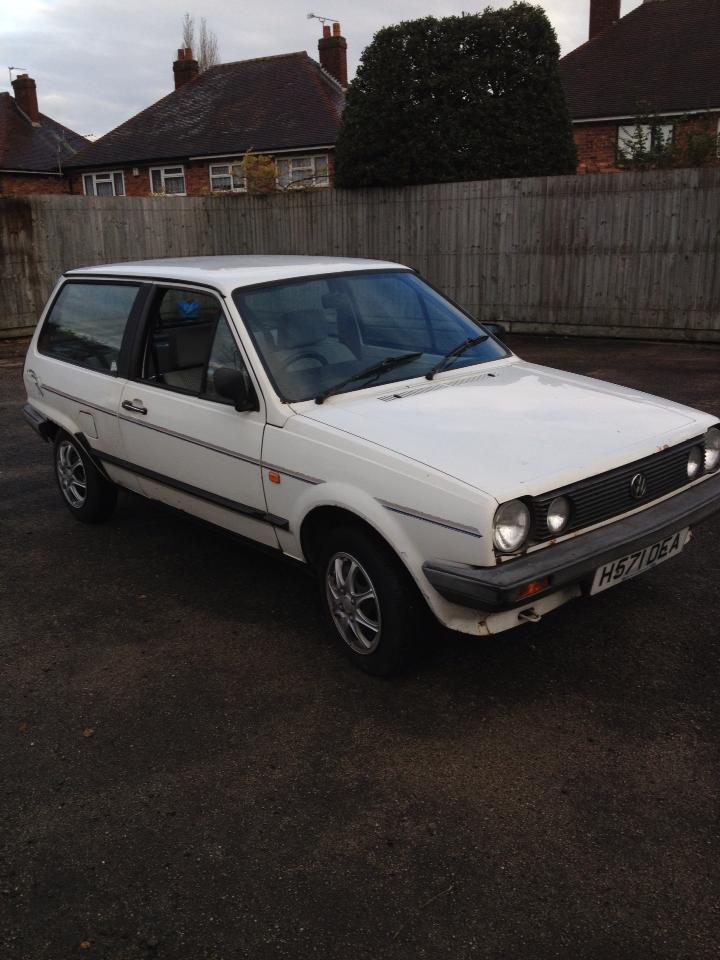

It'd be sat in the previous owners garage for a year or so (probably more) but it jump started first time
and we loaded it up for the journey home.

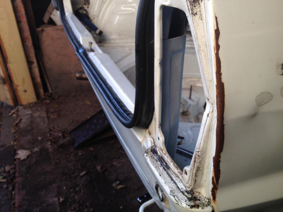

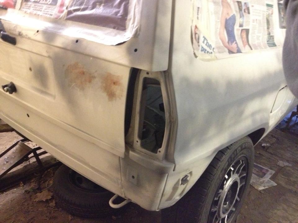

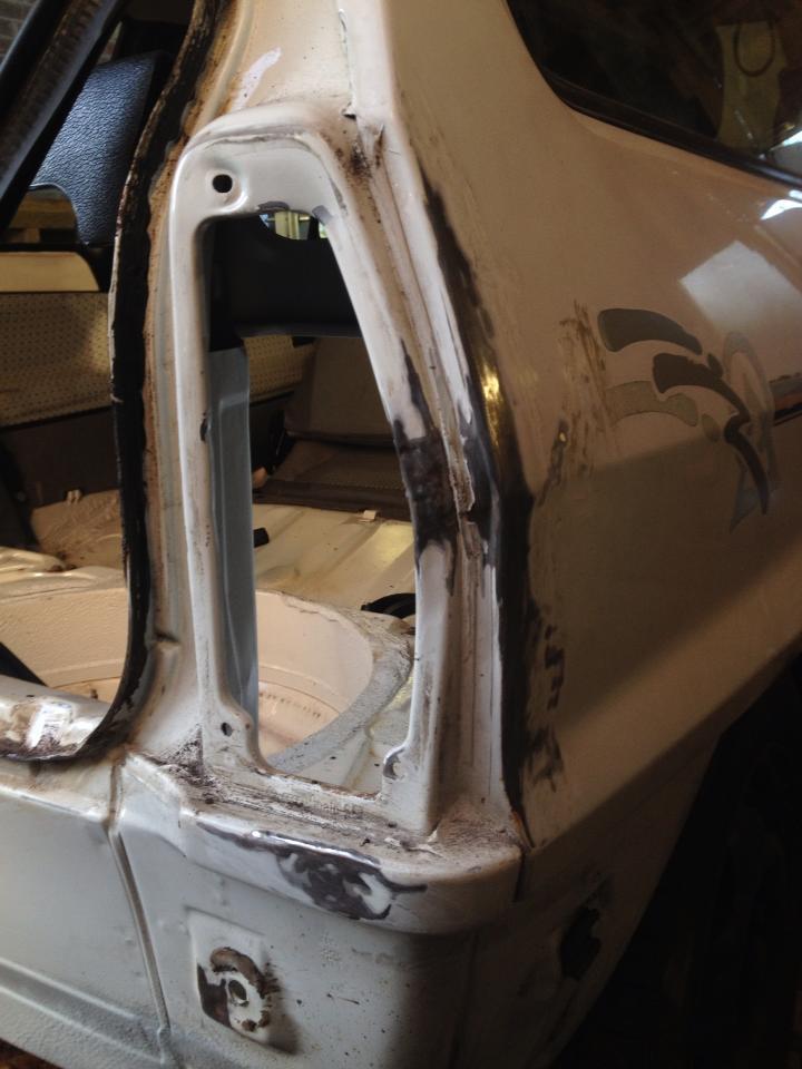

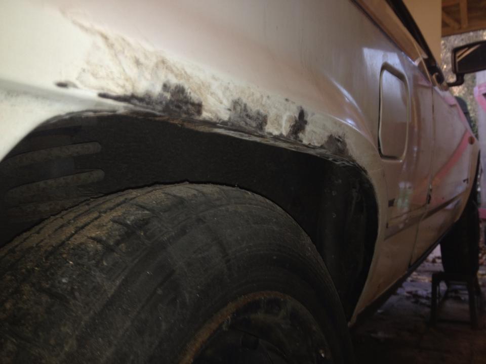

There were a few bit of surface rust but otherwise, nothing major so got it all cleared up and primed, there

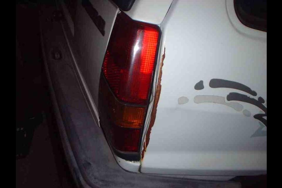

was also a dent where the rear light had been damaged and replaced which was letting rain in, so i got
that straightened out on the first free weekend i had!

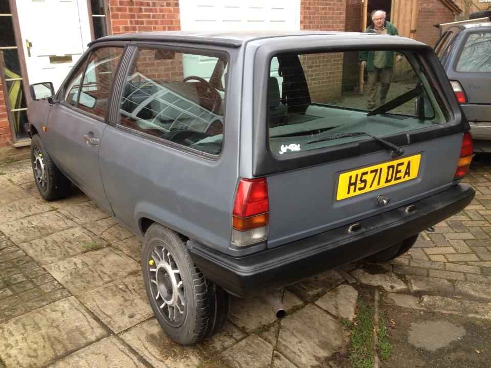

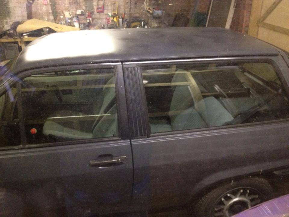

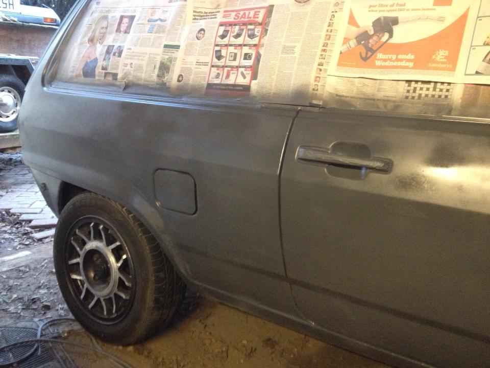

Once the rust was sorted out and primed, It turned out I didn't have as much money as i'd hoped, so decided to
rattle can the whole thing in grey primer from Poundland (not sure how good of and idea that was! haha)
I plan to have it professionally sprayed Orange when I have everything mechanical sorted!

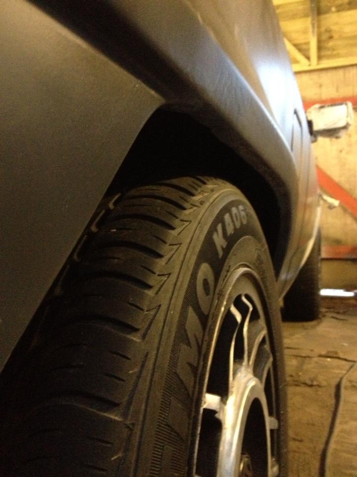

I picked up the scala wheels from a chum who had em on his caddy, although I'm thinking when i drop the suspension,
those big ol' tyres are gonna need changing for a lower profile with a stretch, most likely 155/55/14's

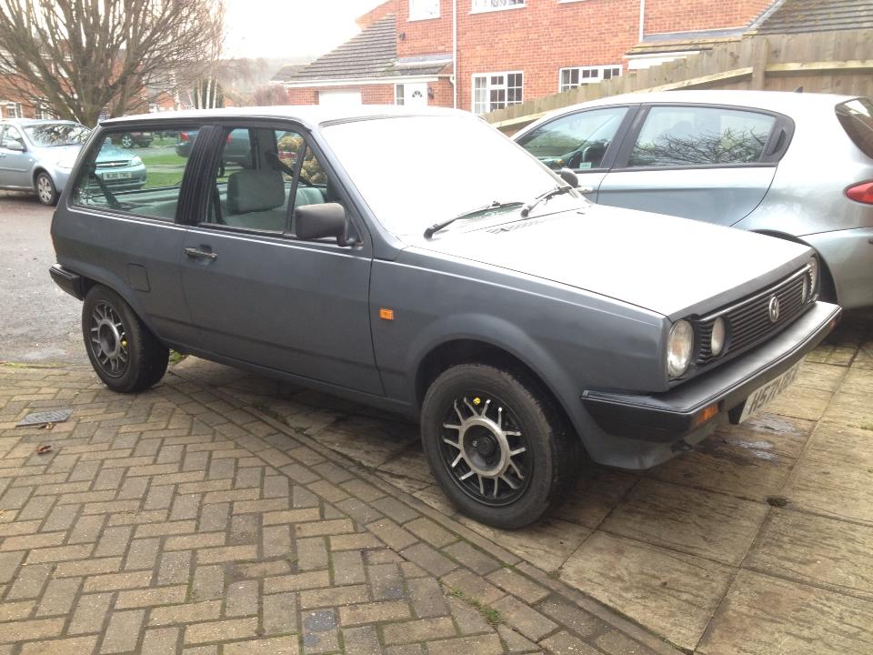

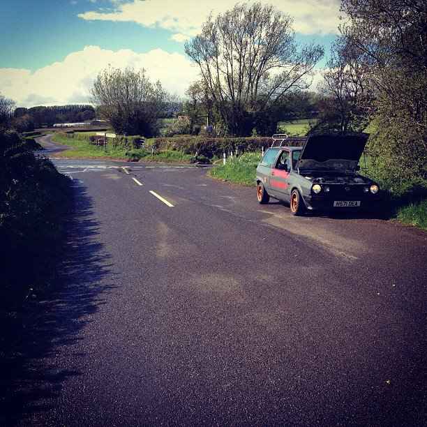

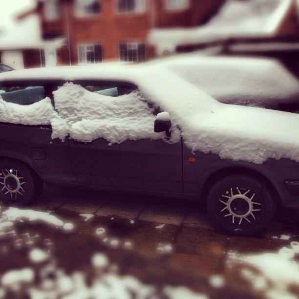

Just an update, here's where we're at now:
...after daily use for the last moth of so, carb problems have reared their ugly head, so i feel like a re-build/carb clean out is needed.
to be honest, i'd rather loose the pooburg thats in there currently for a manual choke one, if anyone has one going!?
The aim is to spend less time like this....
