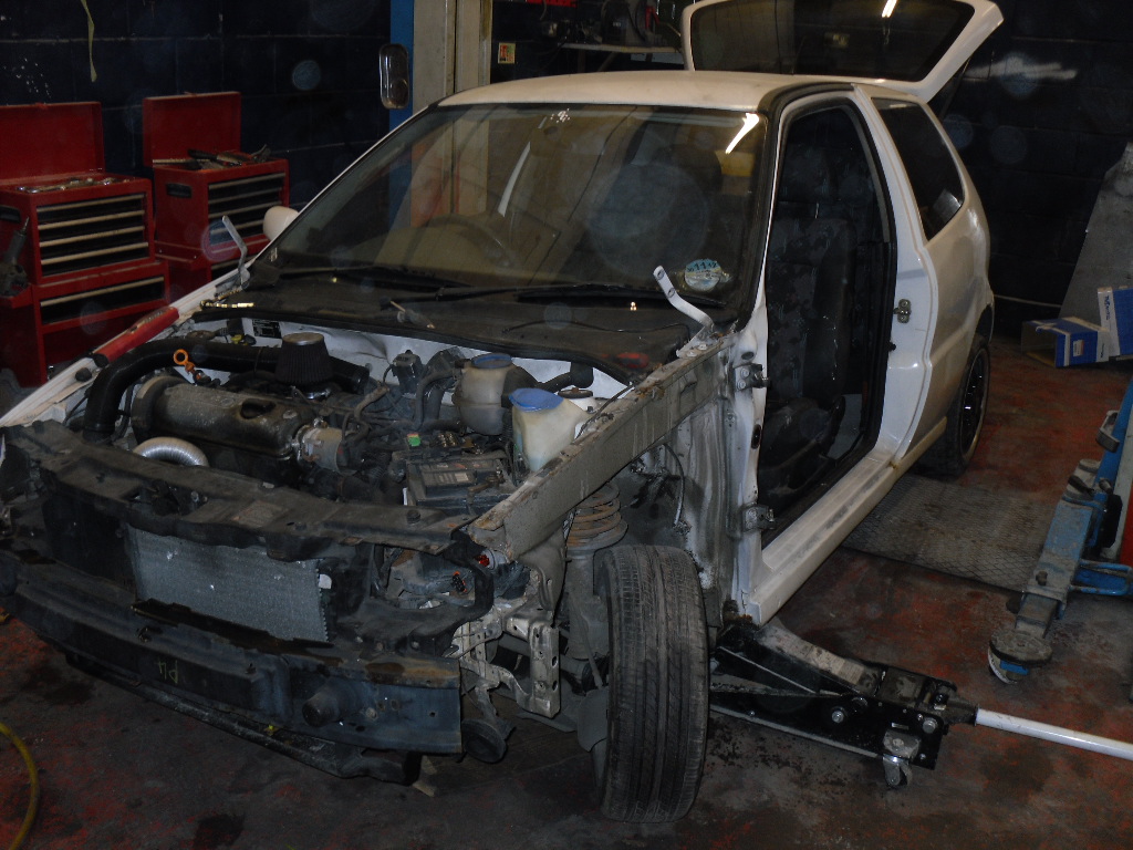

SO I've JUST BECOME A NEW MEMBER AND I've RECENTLY PURCHASED A MK4 VW POLO... THIS IS MY FIRST EVER PROJECT WITH A POLO SO I WANT TO MAKE IT LOOK NICE....LUCKY FOR ME I OWN MY OWN BODYSHOP AND MECHANICAL BUSINESS CALLED AUTO DESIGN INC SO I CAN DO EVERYTHING ONSITE WITH MY WORKERS

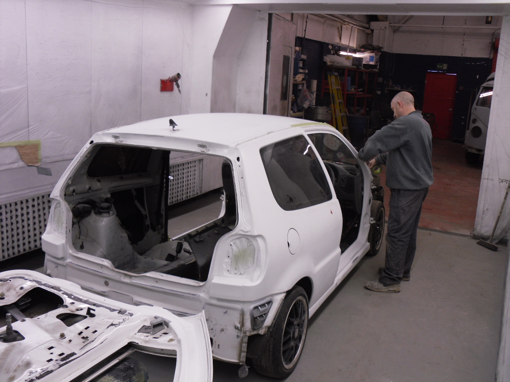

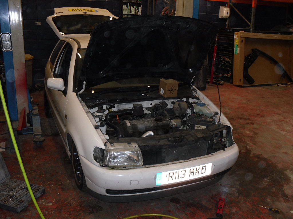

SO THIS IS THE SORRY STATE OF A CAR I've BOUGHT WE ARE IN STRIP MODE ATM

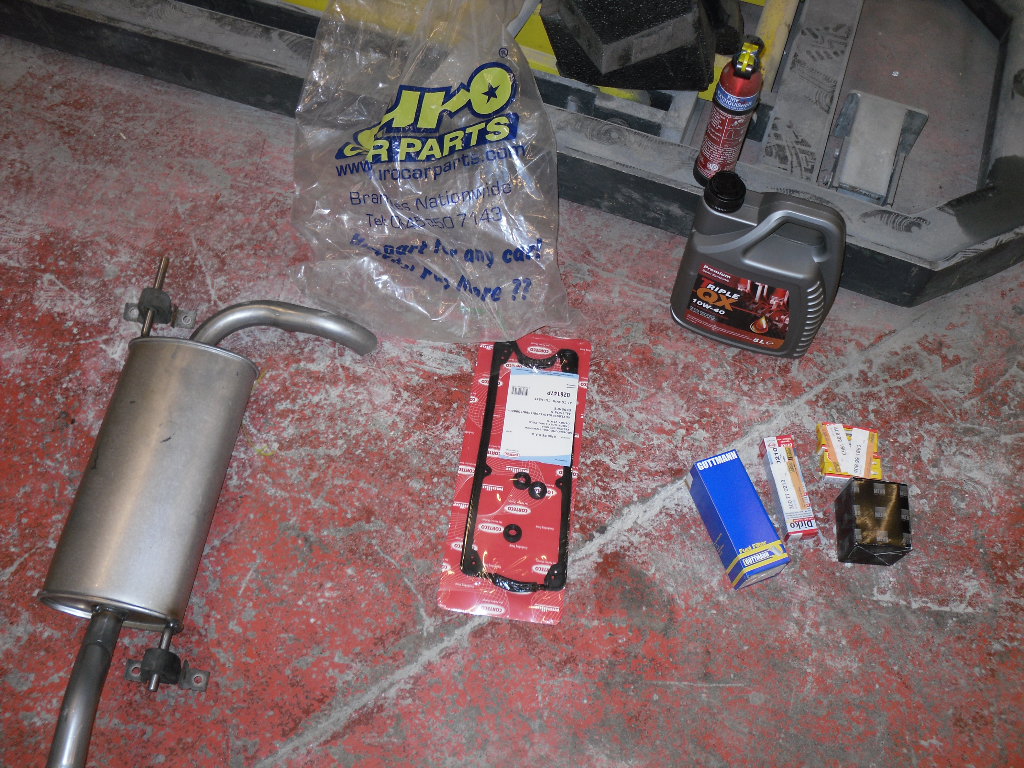

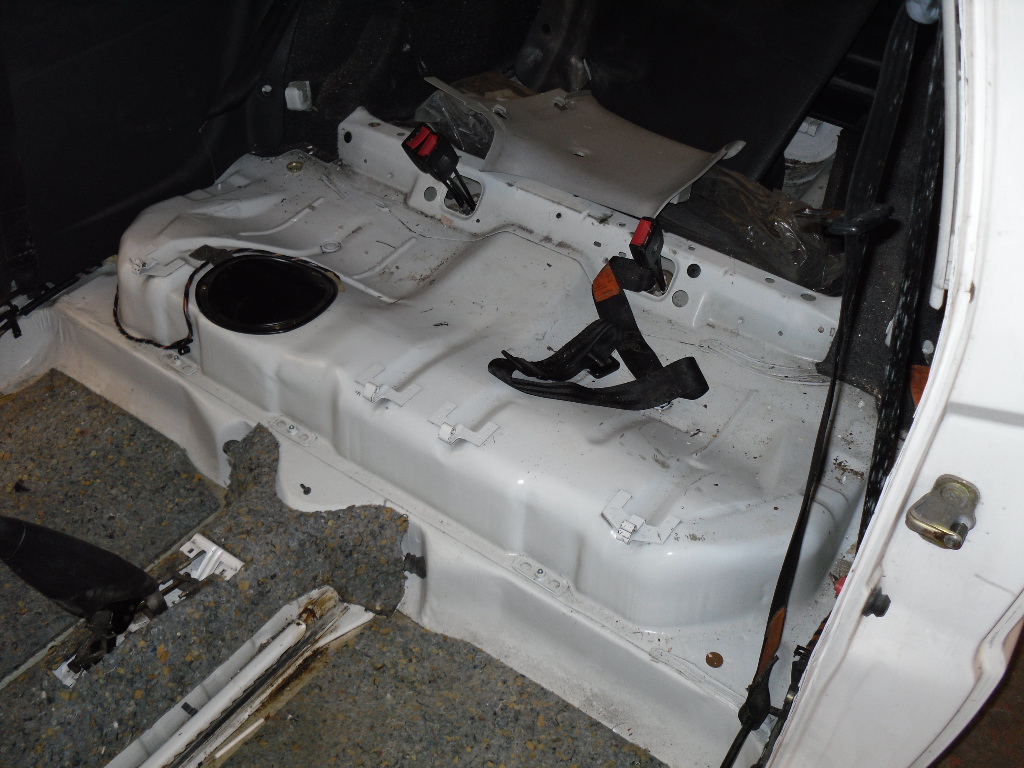

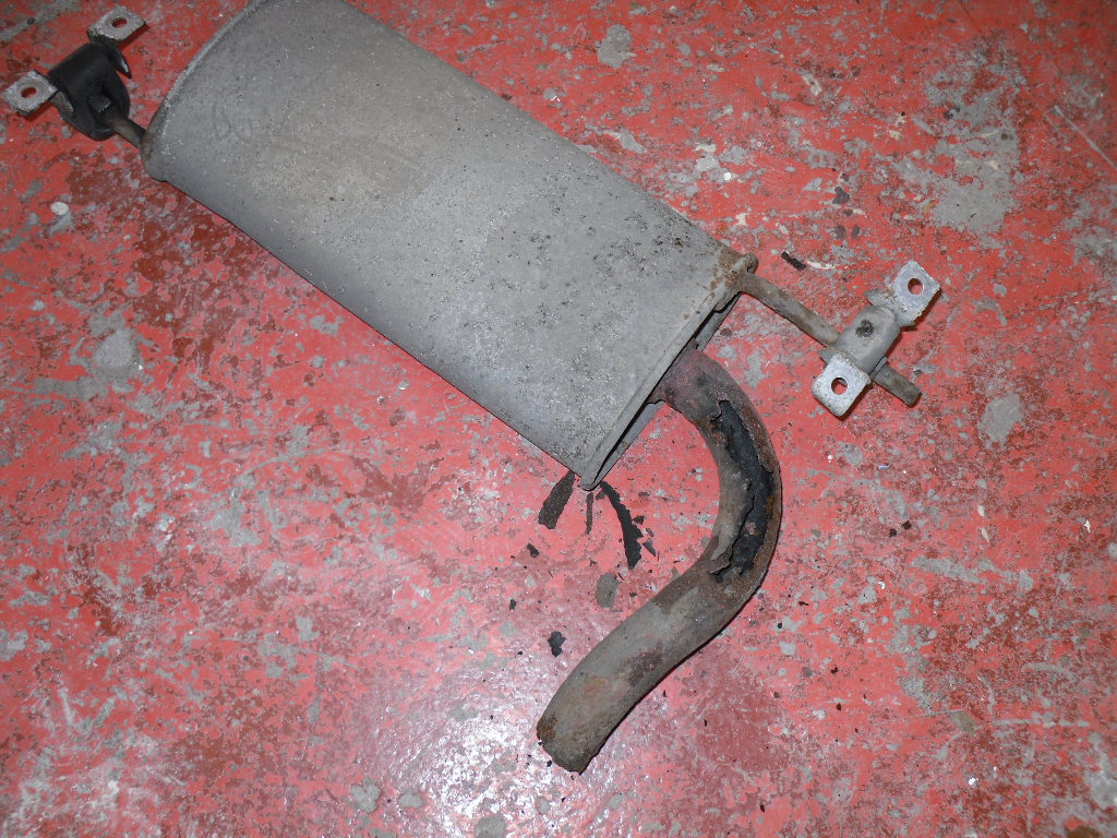

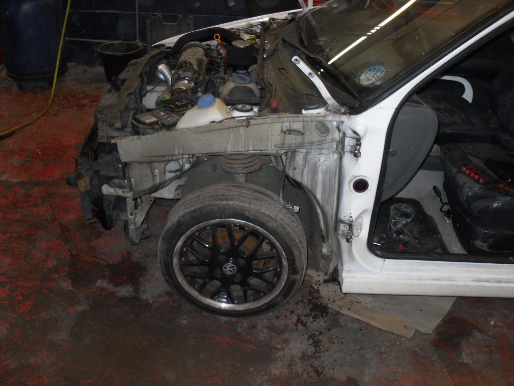

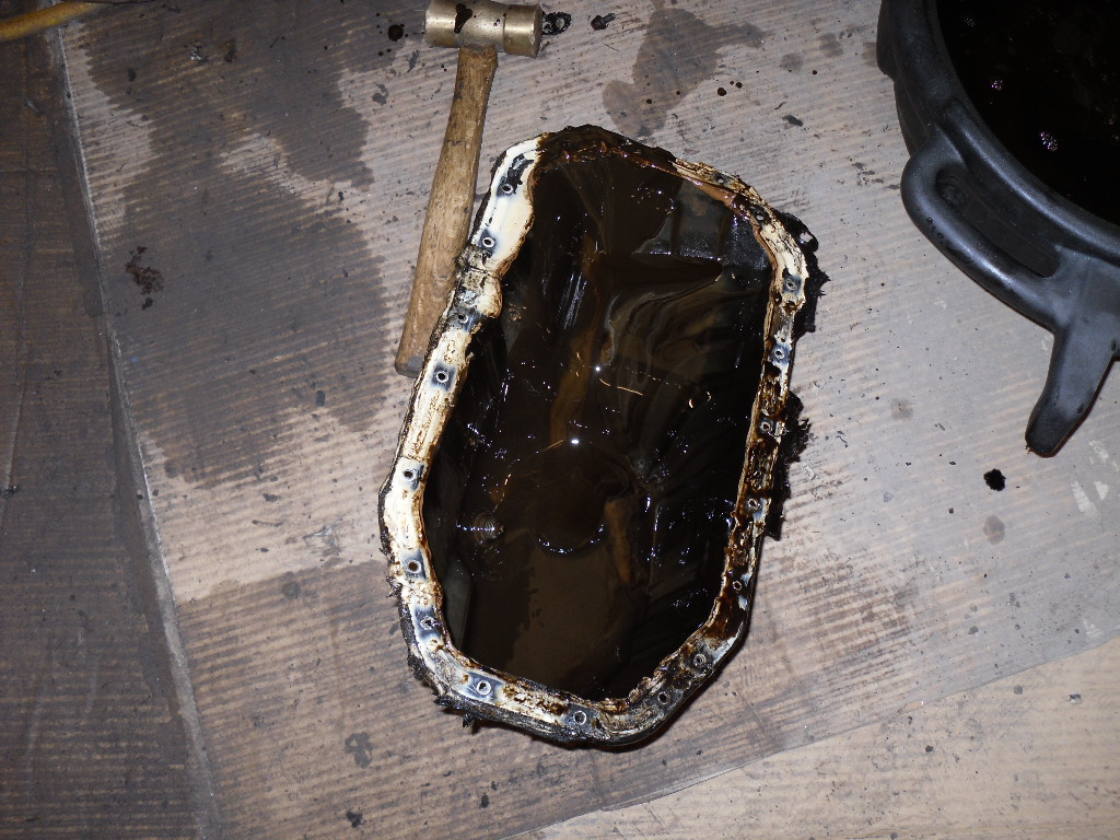

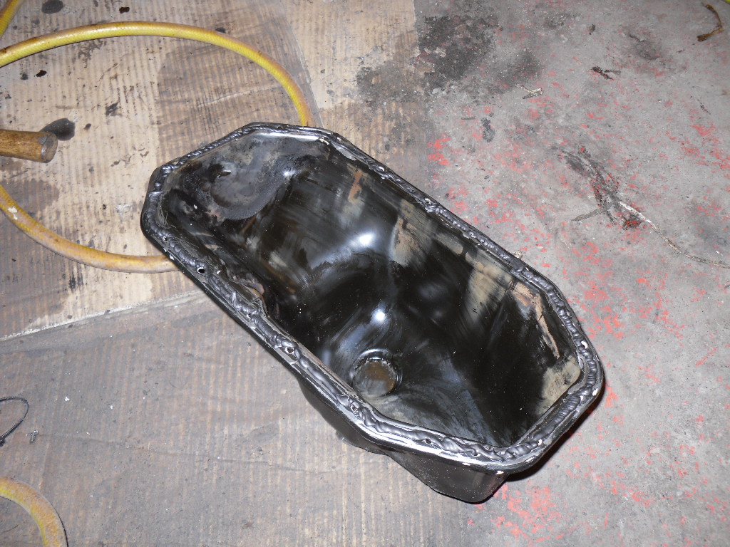

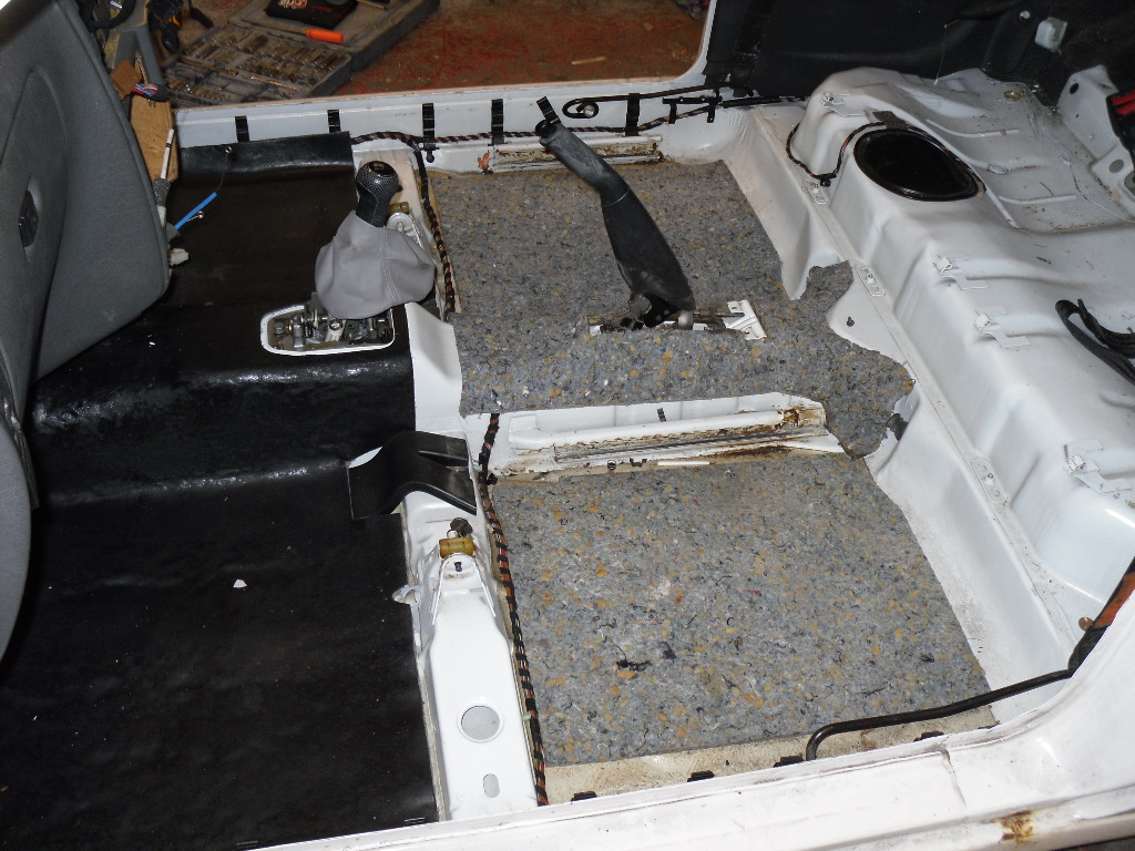

STRIPPED ALL THE INTERIOR OUT AND THE INSIDE IS PRETTY MINT SO I'm GOING TO LEAV THAT AND CONCENTRATE ON THE EXTERIOR..... NEW PARTS ORDERED FULL SERVICE KIT AND A NEW BACK BOX OLD ONE ROTTEN THE SUMP NEEDS TO COME OFF TO CLEAN IT WAS A LEAK SOMEWHERE !!! ILL KEEP UPDATING THE POST AS I PROGRESS

@prankstar whoops about the caps lock key lol.... cars is what I do so I'm very lucky in that sense I have my own facilities well I'm thinking of doing either a lambo orange with a black merc roof with Crystal sparkles and a black bonnet I've never done a lairy colour like orange.... lucky for me my headpainter is a ATA accredited Painter and his former employer was McLaren and he knows how to paint especially Custom stuff so I know I'm in good hands ill keep you posted on developments as we come along took the sump off clean the leak resealed it do the rest of service in morning then over to the bodyshop hit the whole car with 320 all over and get it ready for paint

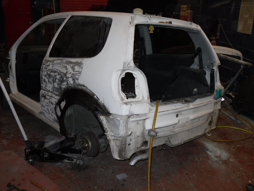

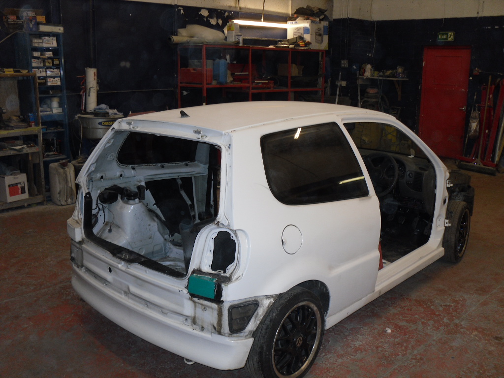

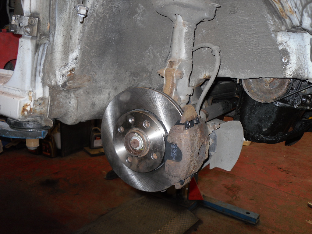

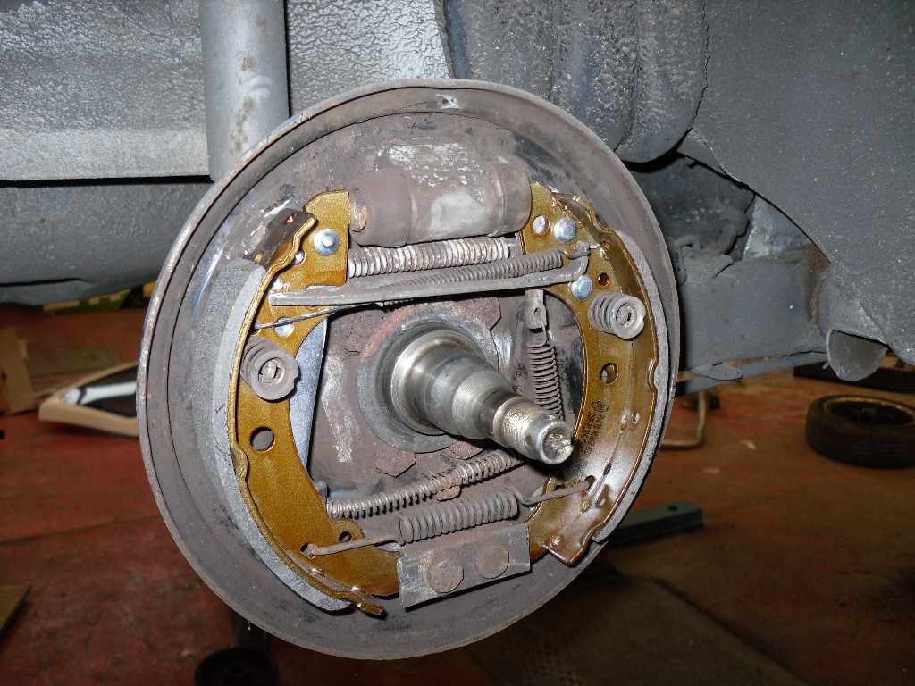

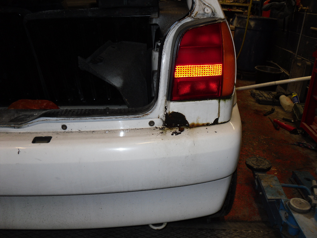

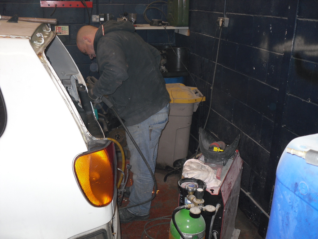

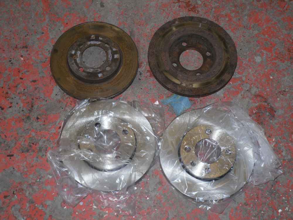

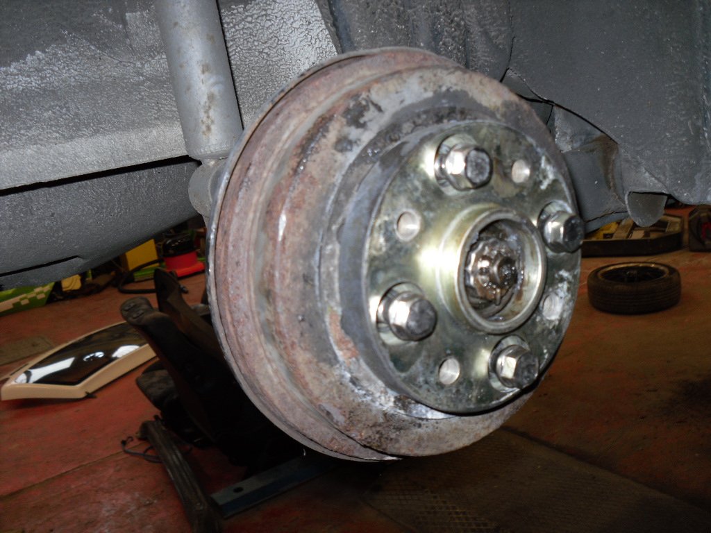

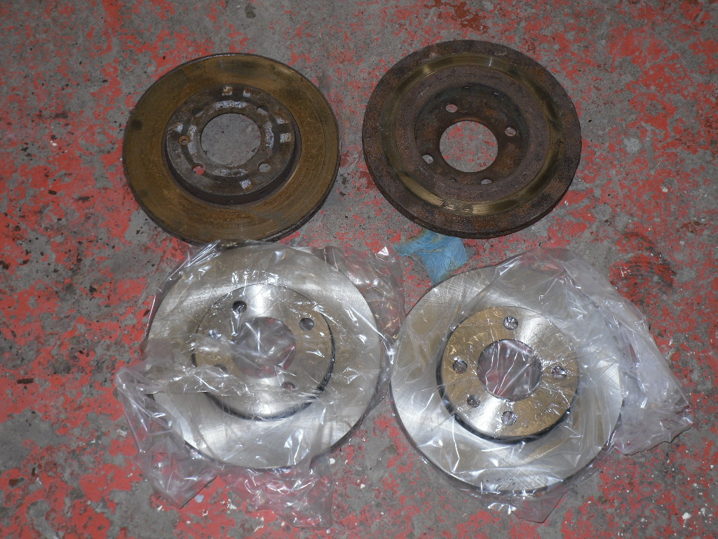

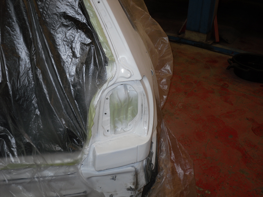

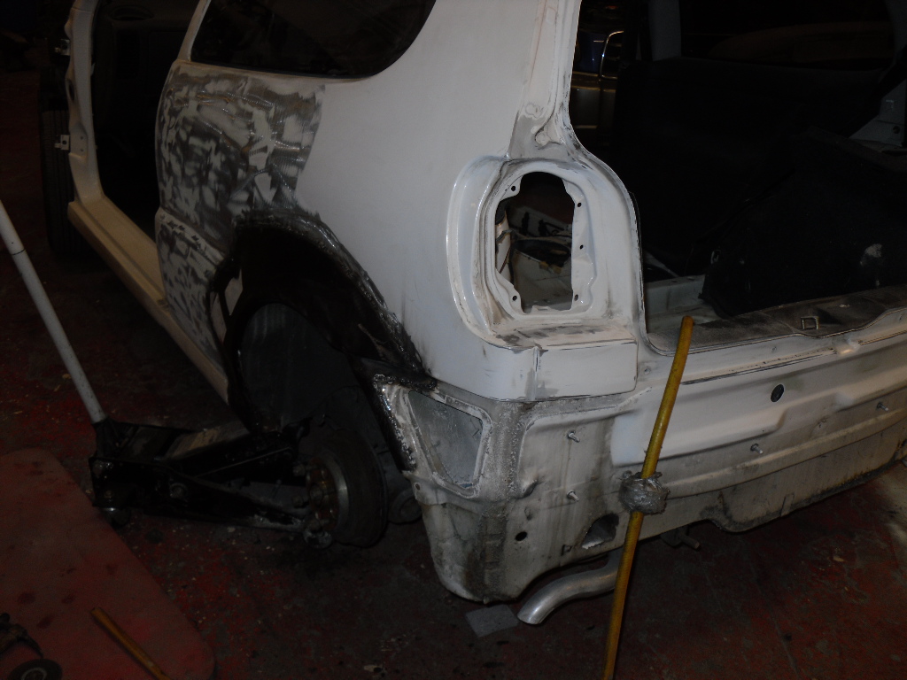

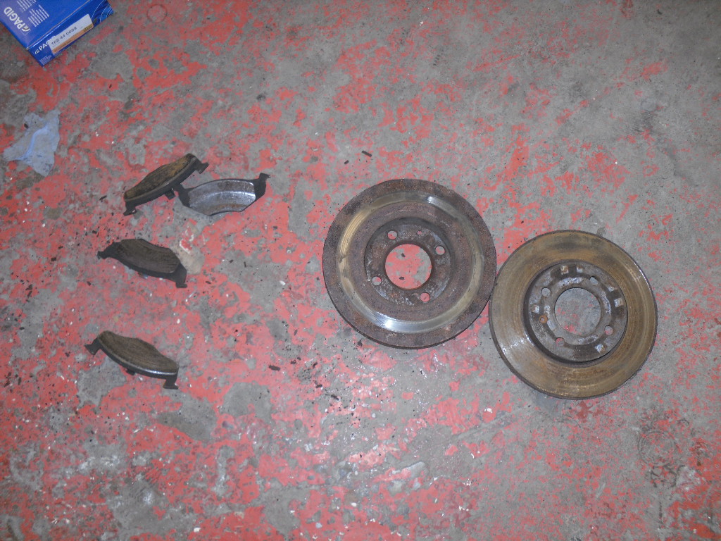

A quick update for you guys got new discs and pads and rear shoes delivered this morning the old ones are rotten also took a trip to the local breakers in peace pottage needed a few bits loads of dying polos in there we decided to take the section off where the rust is coming through under the rear light clean the area where needed and treat it with some Acid and weald the new section and seal it with body sealer. next task is to tackle that rear quarter so coming along nicely ill put some pictures up later to show our progress

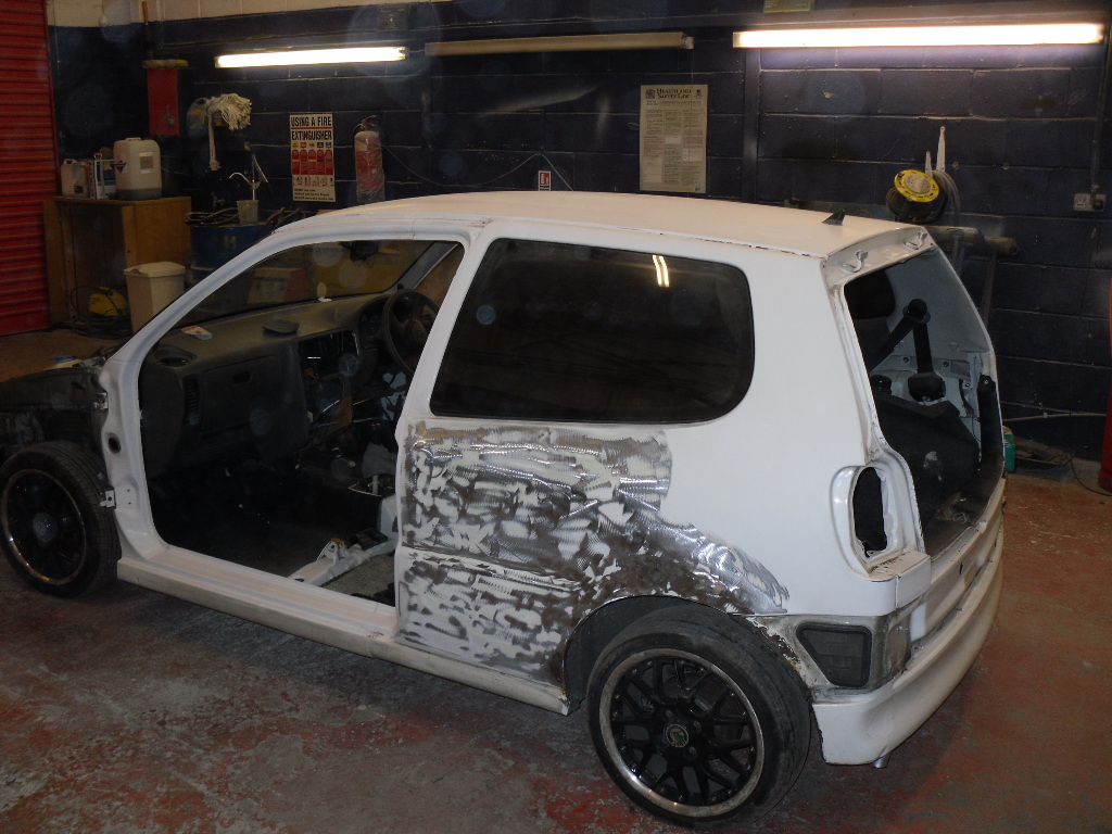

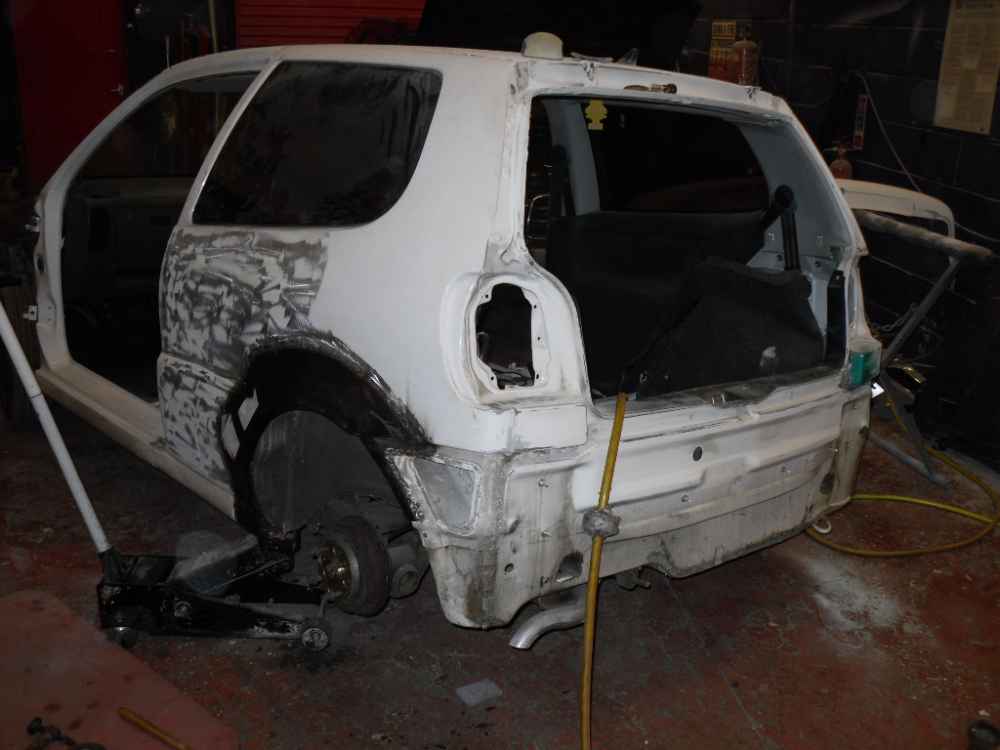

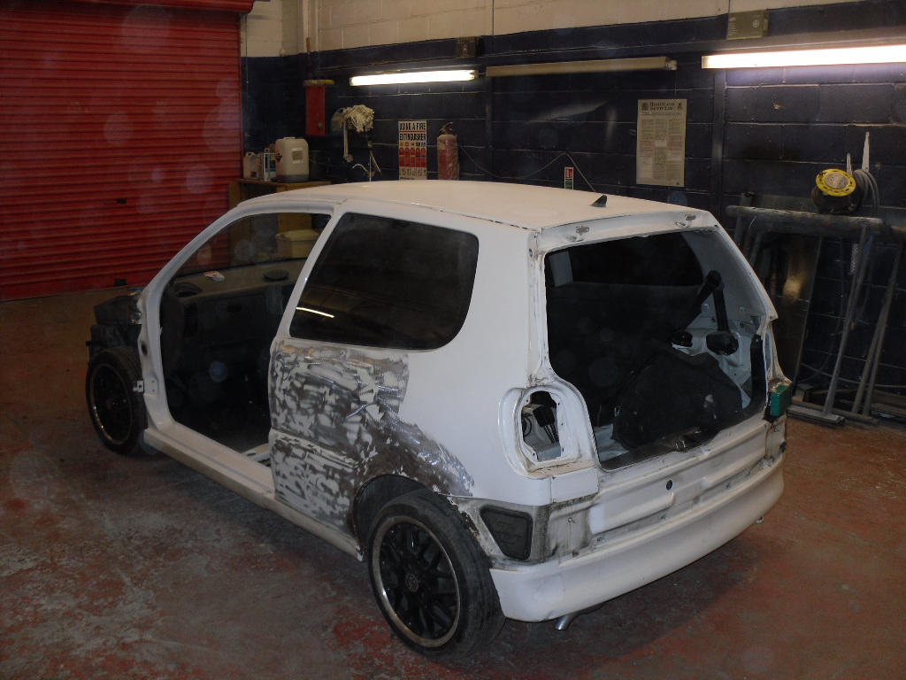

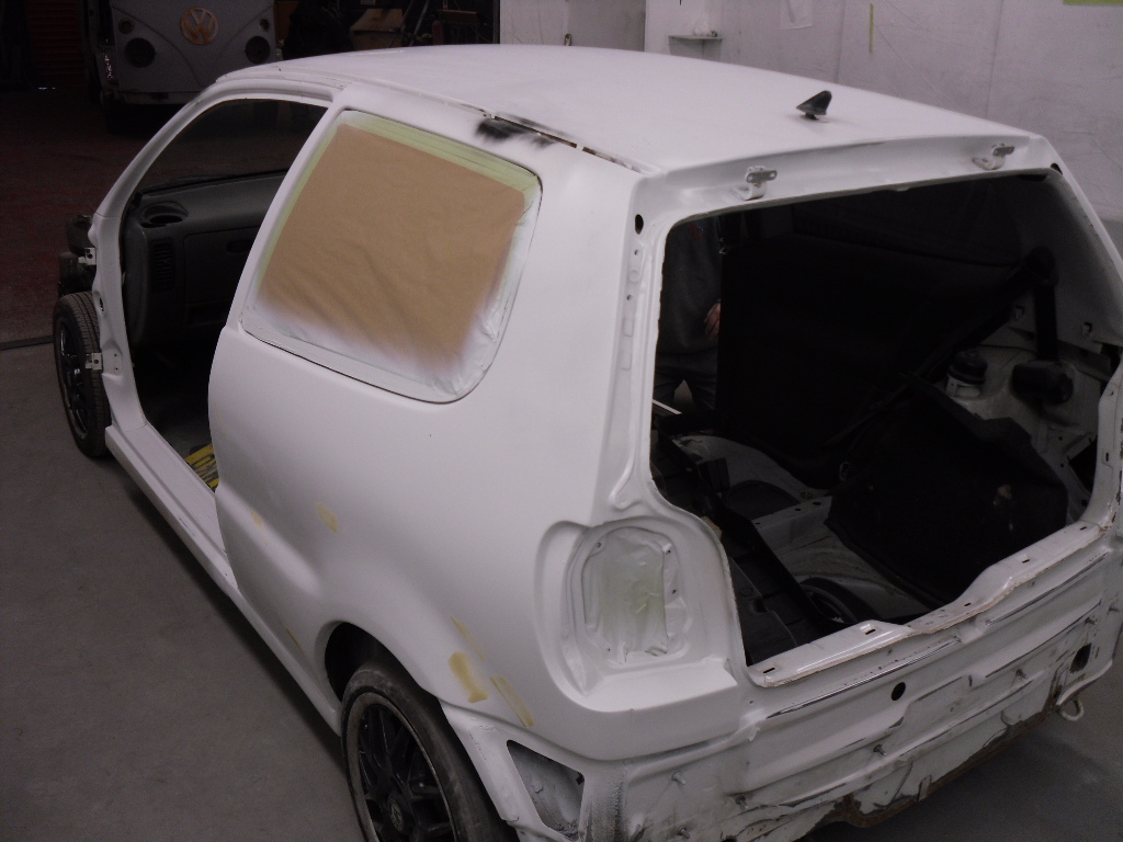

hi guys just a few things I've done today on the little polo.... rear arch needs cutting out and a new one putting in to rotten so I've ordered one from my supplier get my panel beater to weald it in car has been fully 320 down there a few blimishes on rust scab on the car but only surface so its all minor all the mechanical work has been done all now on the bodywork :)

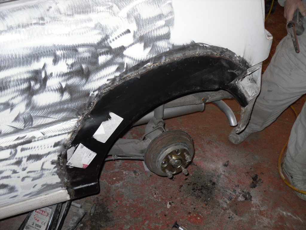

another update on the little motor :-) Rear Arch was rotten best way to cut out the old one and replace with a new one job done apart from that rear arch and the little spot under the rear light the car is really clean for the year

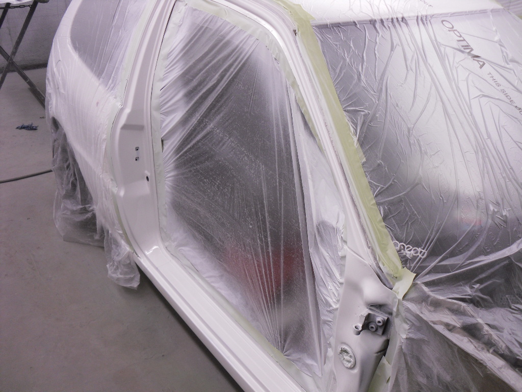

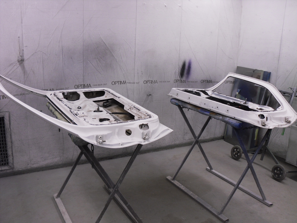

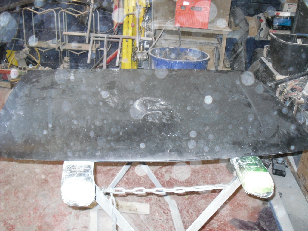

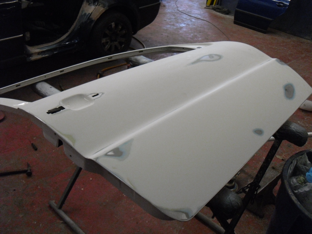

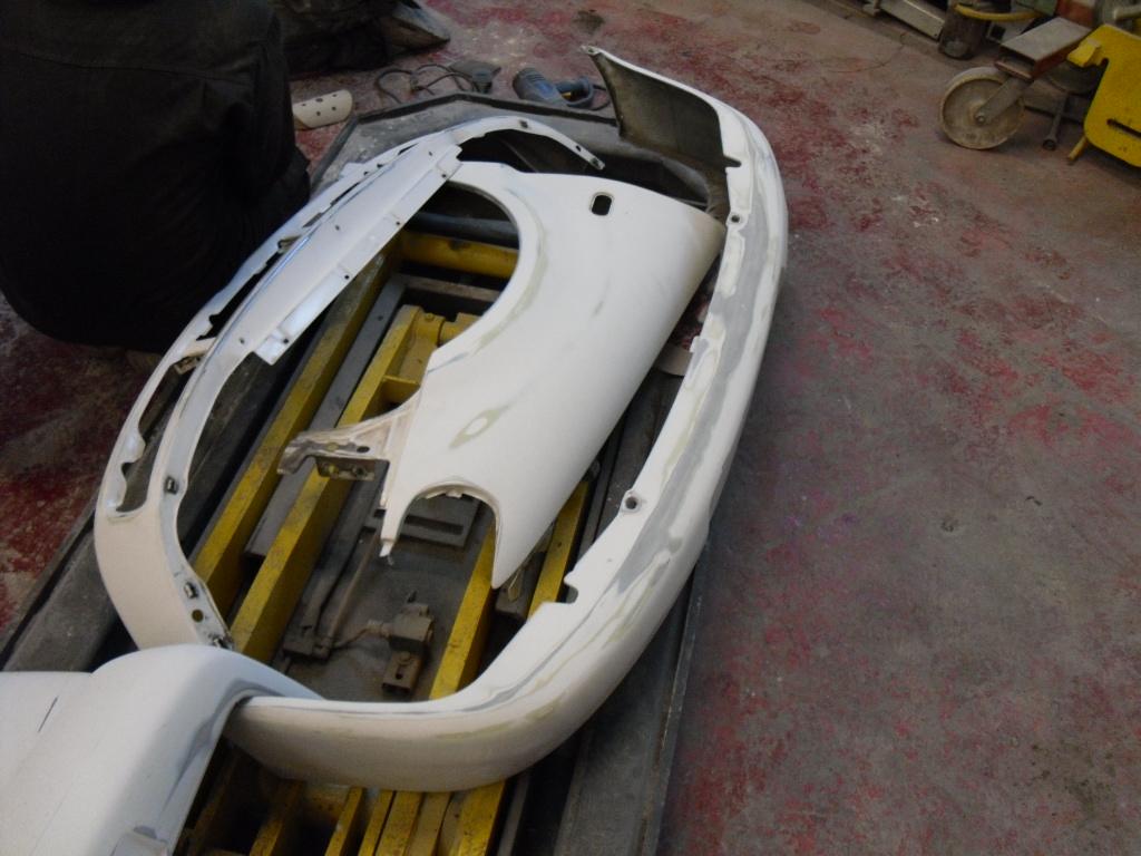

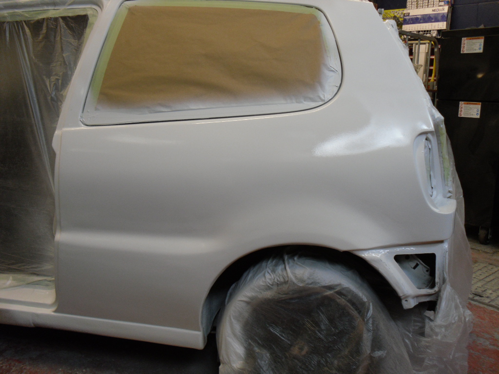

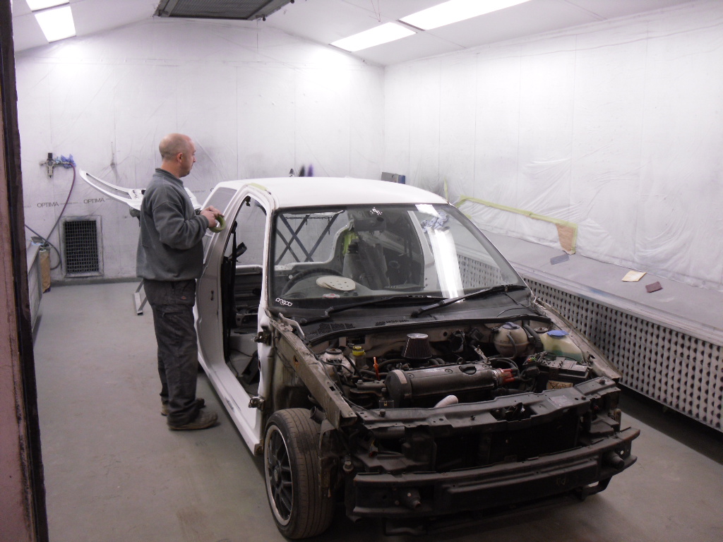

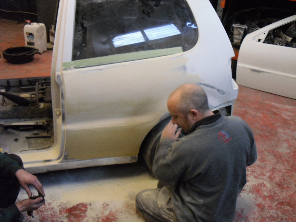

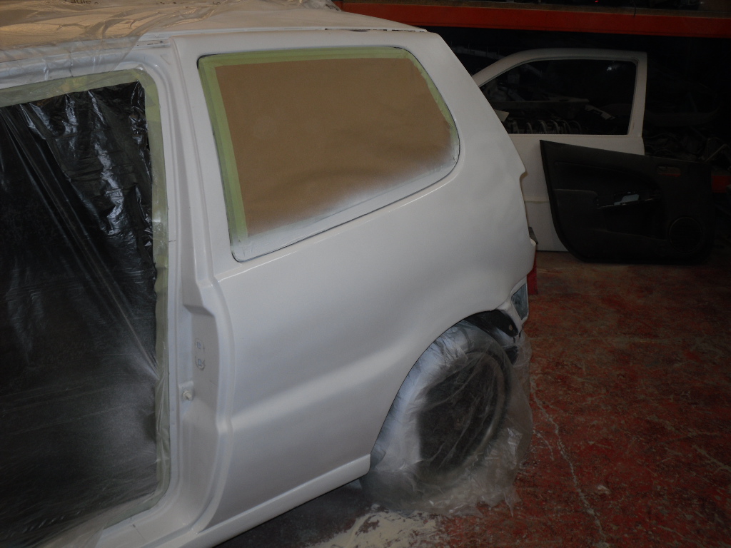

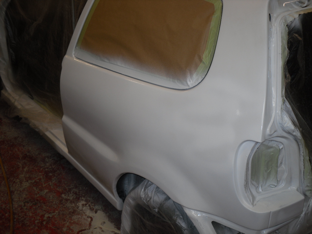

:-) A few updates prepared all the doors, wings, Bonnet and Rear bootlid today.... Rear quarter is coming along nicely nearly ready for some primer . Someone had attempted to do a matt black finish with a spray can looked really bad lol DA the whole bonnet of ready for the Merc Paint

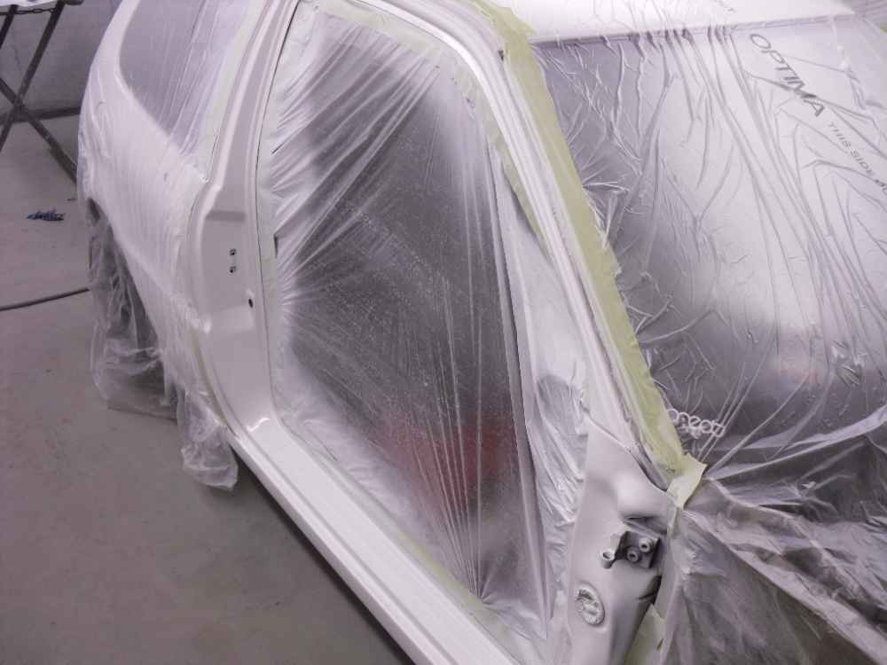

:-) Some more updates on the build got the car in some Wet on Wet Primer especially that nasty rear quarter

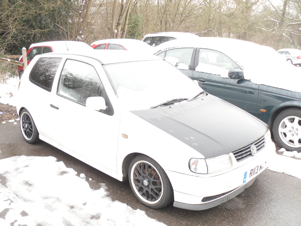

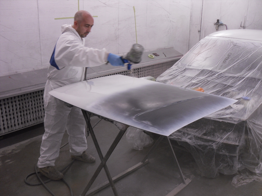

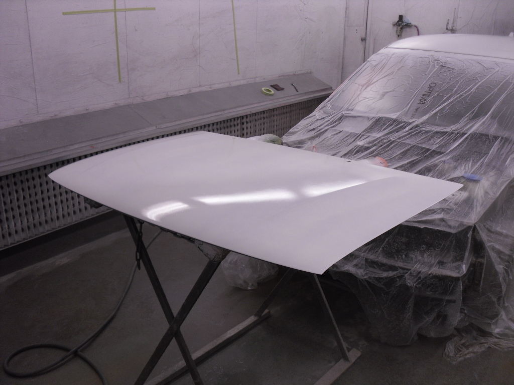

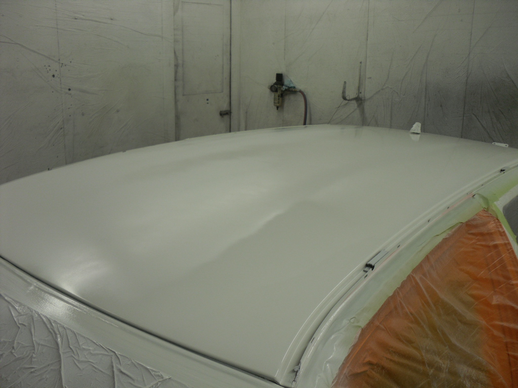

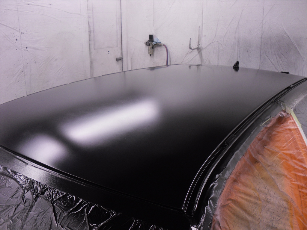

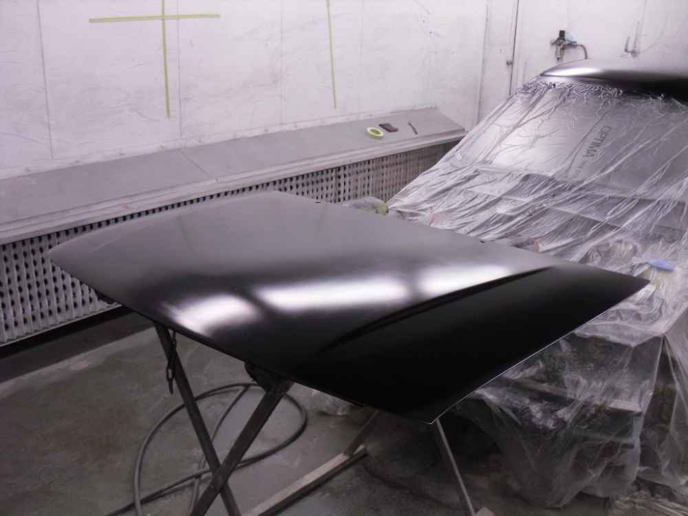

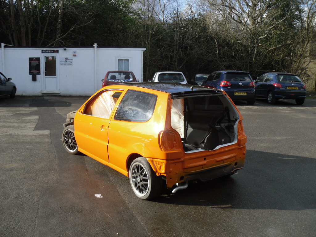

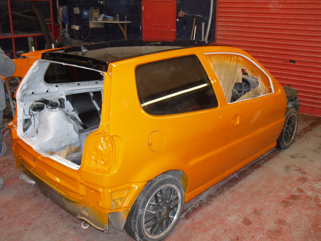

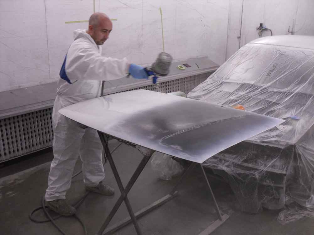

:-) some more updates painted the bonnet and roof today and dropped some orange pearl in there really pops when the light hits hit

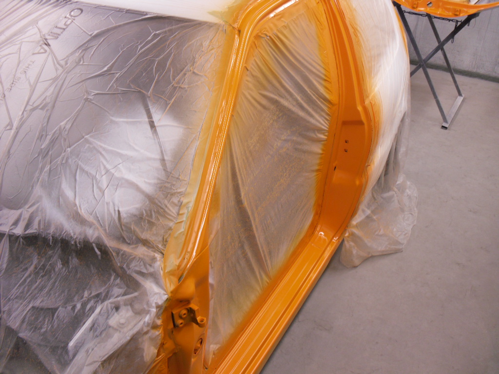

:-) nice new colour Ford ST orange with Merc obsidian black with Orange pearl in the roof and bonnett
really like where this is going :) thought you woulda done in the boot etc etc aswell, still looking amazing though whats the rest of the plans for it :)
yes I could have stripped the whole car out and painted everything but all those panels you see In white will be covered so you ll never see them plus I have other customers cars to do atm so time was another issue but I'm sure once the car is put back together it will show it credentials
