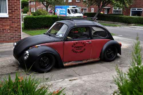

Decided to make a thread on mine and mikes 1991 mk2f saloon, incase anyone was interested haha. I'd got rid of my old car just before hand and just had to get myself back on the road. here is a little piccy of my old car just because i loved it :lol:

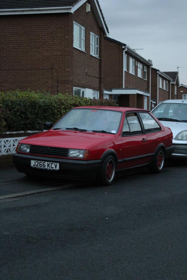

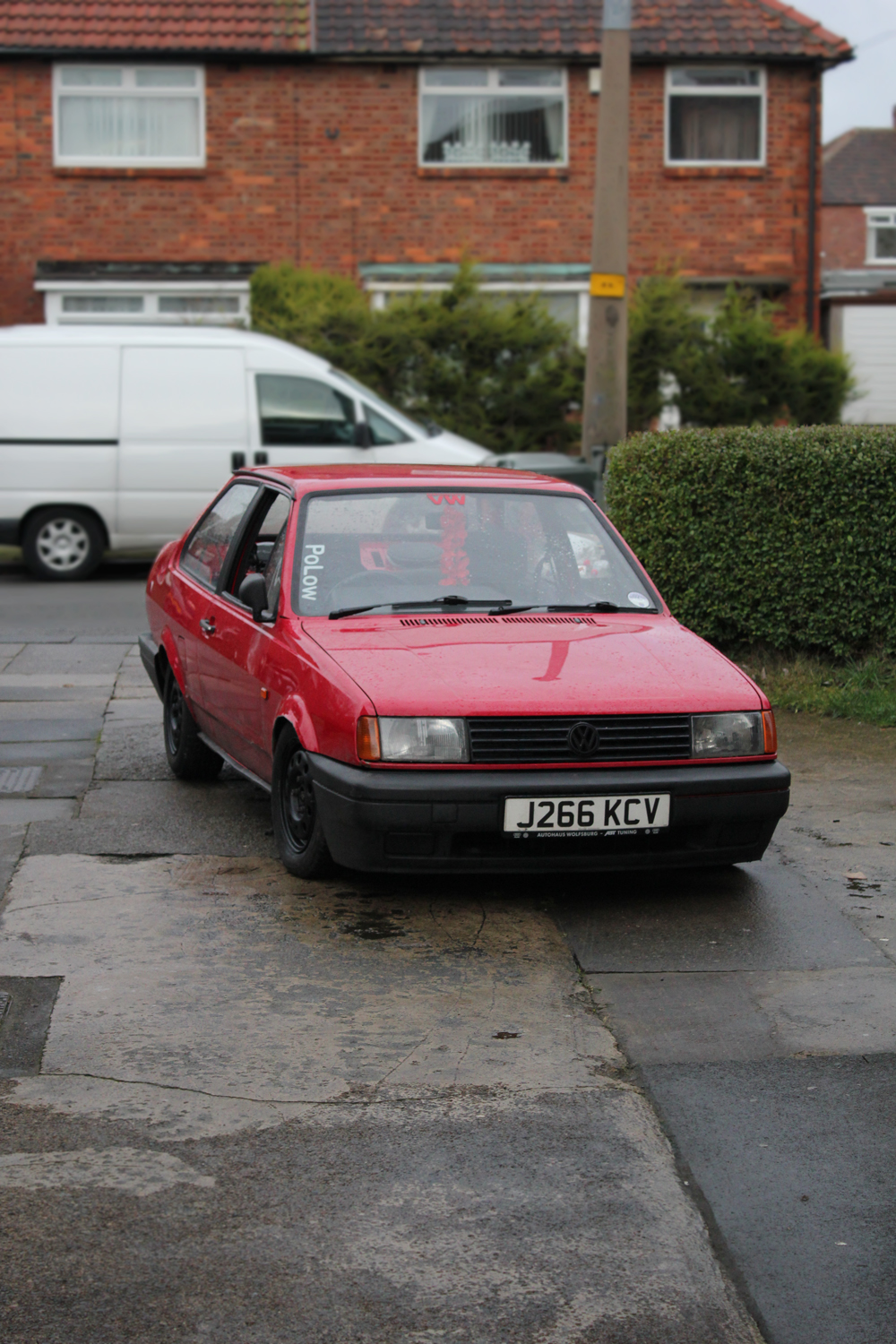

Anyway back to the polo, bought it in around September from a lad for a tasty £700 in better nick than i expected, here's a pic of the very day that i bought it

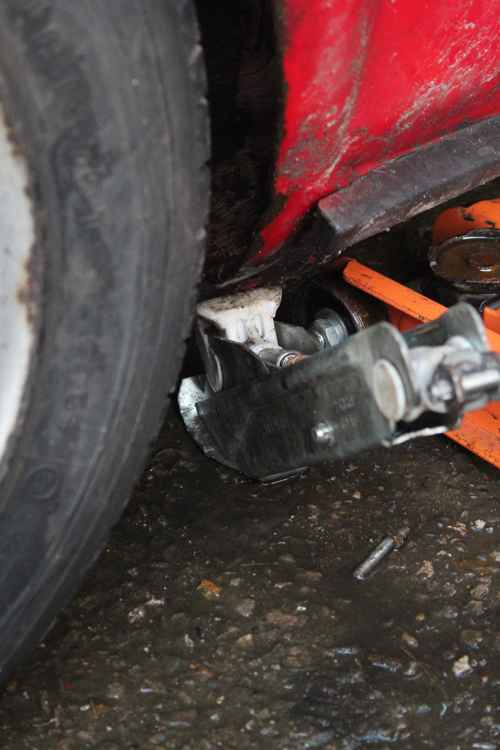

After this things got a little sketchier. went about cutting the springs on both front and back for lows, but didn't realise how much it would fuck up the steering and stuff. back end went fine but it was extremely soft still, so if i had someone in the back or even heavy shopping the exhaust would tickle the floor. The front end however went mad, the steering arms came up and not only touched the body (which led to body notching with my trust angle grinder), but the end of the steering arms and the strut arm touched the inside of the arch which made steering extremely heavy and down right dangerous. I also felt game and decided to cut the springs another coil which meant that the springs were now pointless and the car was sat on the damper which again is super dangerous but also is very uncomfortable on any kind of road, not to mention how stupid i must have looked from the outside :lol: so if you're reading this and you want to cut your springs just dont. save up and fork out for some bangin coilies - which was my next step.

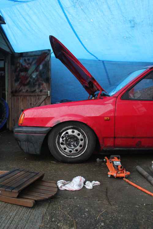

got one fitted and the low jack doesn't even fit under anymore :lol:

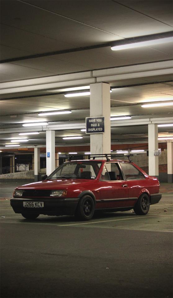

This is it with around 90mm on the back and about 100mm on front, both the coils go to around 120mm so when i get some new shoes i'll drop it fully.

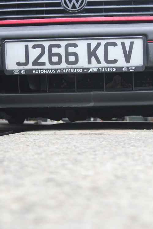

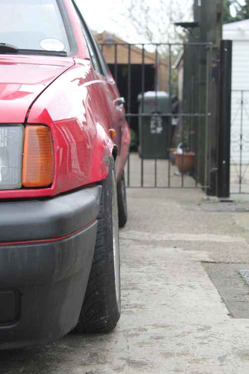

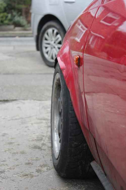

decided to test my old wheels before i have them re-sprayed and buy new tires for streettccchhhhhhh! coilovers still on about 100mm, here is how they are on the front. haven't got round to looking at the back yet :-)
looks at lot more thickened out now. camber ftw

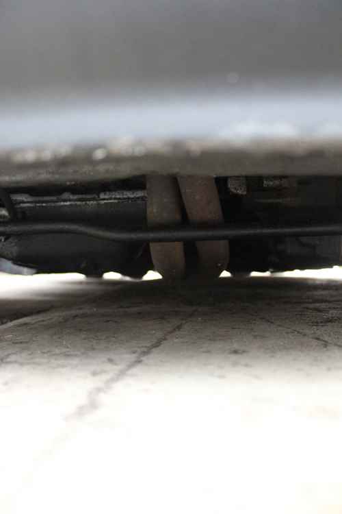

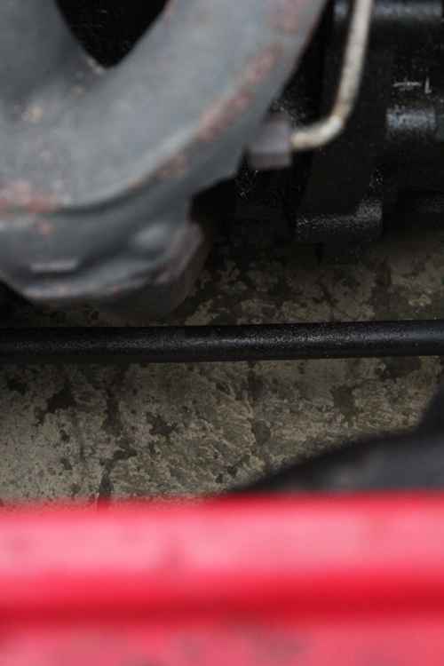

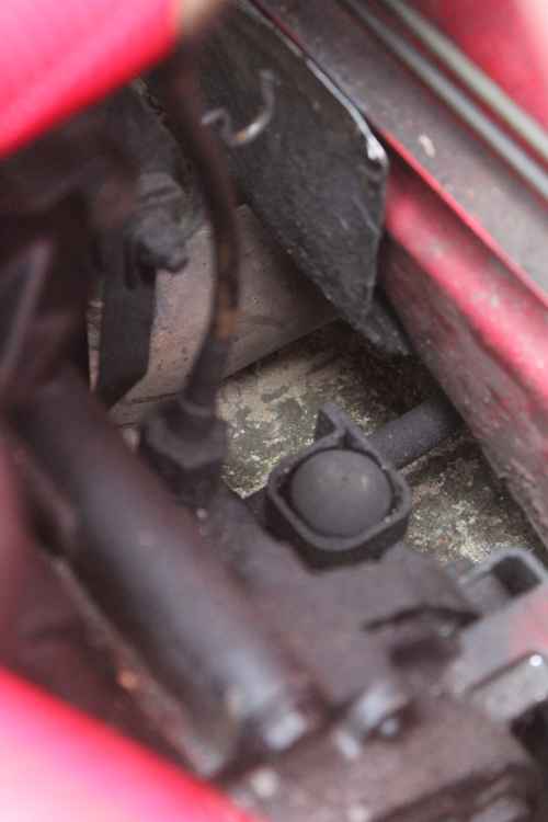

The engine and manifold are now dangerously close to the floor. 2.5cm is the lowest clearance point :paranoid:

PAHAHAHAHAH! ha PAHAHAHHAH! dangerously low? Yee, i guess you've posted the wrong pictures as i can see a lowered polo, where is this dangerously low you speak of. TRY AGAIN.
there's always one idiot hahahahhaa. doesnt say the polo is dangerously low, it says the manifold is dangerously close to the floor :p :lol:

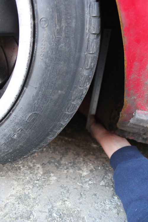

I never did say you said polo... However, low manifold means nothing, lower it. Take measurements from rear of front wheel arch to floor on FLAT ground ;) please. You'll see where its lower behind the front wheel, the lowest bit.... measure that.

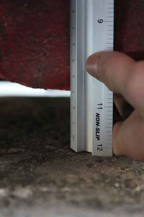

here you go, just over 3 cm
Edited by N-dog
Good man, Yes, you have room to lower that ;) Low, dont get me wrong but not low though :D
EDIT: actually got pictures too, cheers for the decent reply! Shamefully i feel bad now, apologies.
