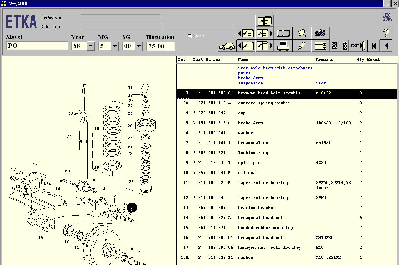

You talking about the ones that go through the rear axle bushes, one each side? They're M10x80 (as per Gaz's ETKA screen shot!) and 10.9.

in that explod drawing what size is no 29. I'm going to have to warm mine to change back shocks n may nack it
M10x82 or something like that. I've just bought 80mm long ones from t'internet as TPS said 29 was now obsolete after I'd ordered them... No.14 in the drawing is now obsolete too - I ordered 6 and got only 4, apparently the last remaining stock. All of these are available through VW Classic Parts if you like paying a fortune for bolts.
