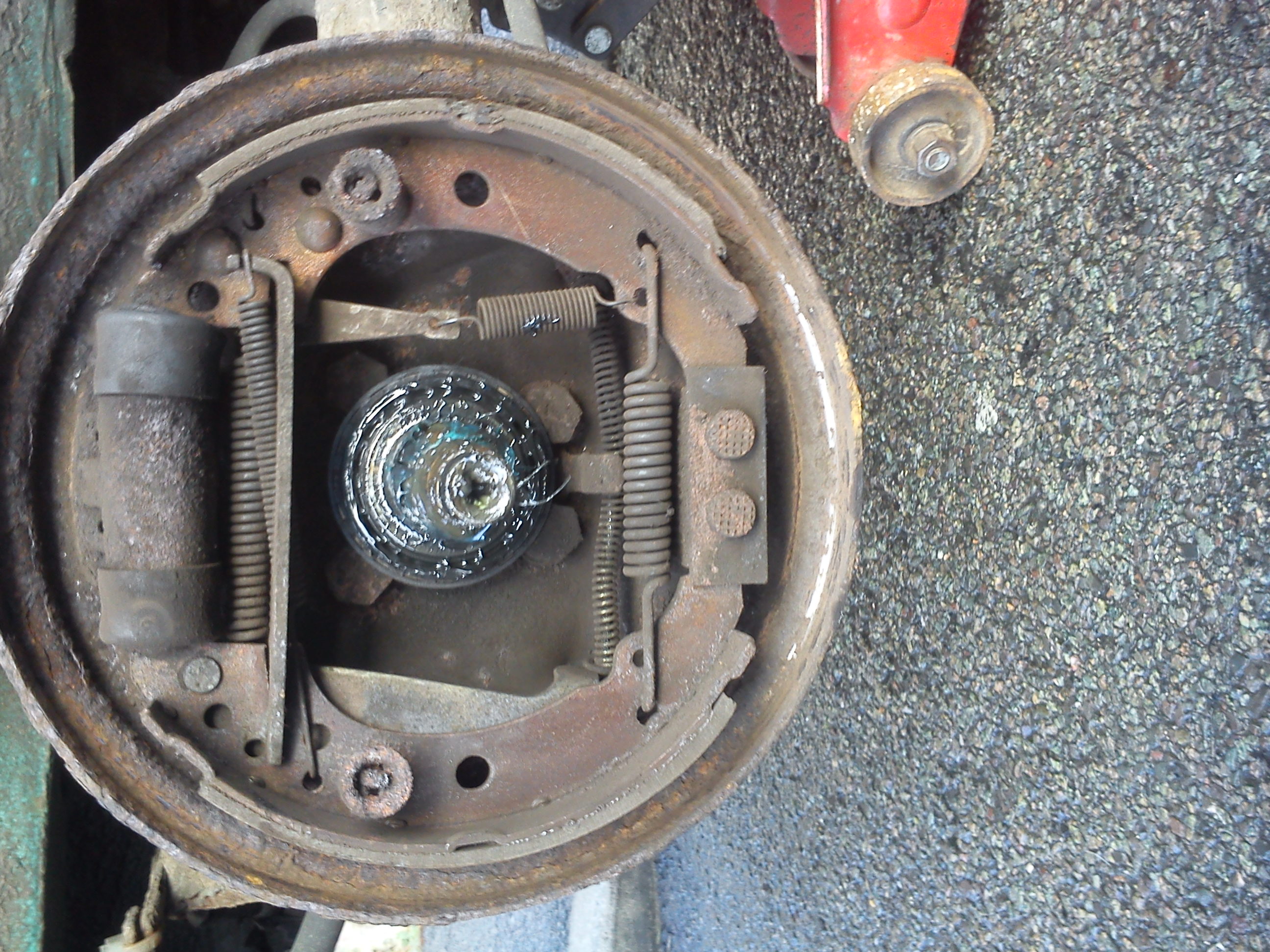

Just had a look at the photo i took before i took them off (to make sure everything whent back in right place) and the wedge is righhhhhtttt down to the point the spring on it is completly compressed, i know the garage have adjusted it to try make the pedal better, but it being right down is that a good sign that the shoes need replacing and probably the reason the pedal is spongey?
If the wedge is right down then normally the pads are dead or the wheel is jammed on. (i had it adjust and latch on during the MOT once).
Should be on the narrowest point, and should adjust properly after a few presses.
They're shagged then? Haha
Tryin to upload the photo but my phone aint playin the game
Low wedge
They dont look half bad TBH.
I've changed worse.
I dint think they were but I'm just trying anything to get the brake pedal back to the right pressure before have to start messin with master cylinders and servos. Its been bled by ETS and its still too spongey to go theough mot. :/
I've changed worse.
The linings do look OK but the adjuster looks to almost be at the limit of it's adjustment
you have'nt got 200mm drums and 180mm shoes ???
I've changed worse.
You may have a point. The shoes don't look like they are high enough up the wheel cylinder.
