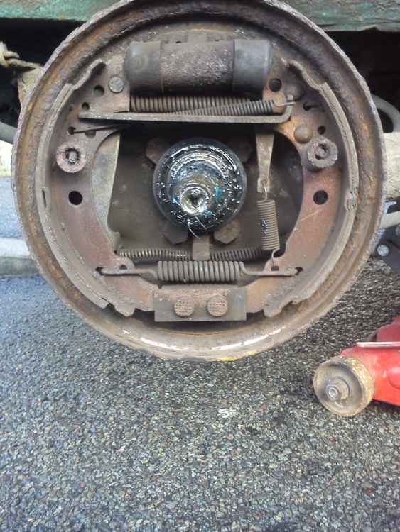

Mot fail on spongey pedal
They dont look half bad TBH.
I've changed worse.
The linings do look OK but the adjuster looks to almost be at the limit of it's adjustment
you have'nt got 200mm drums and 180mm shoes ???
Hmmmm you my be right, I've never had them off since I've owned the car, but i ordered new shoes drums and bearings which should come into the shop tomorrow, ill fit them and let you know how i get on, thanks alot guys
