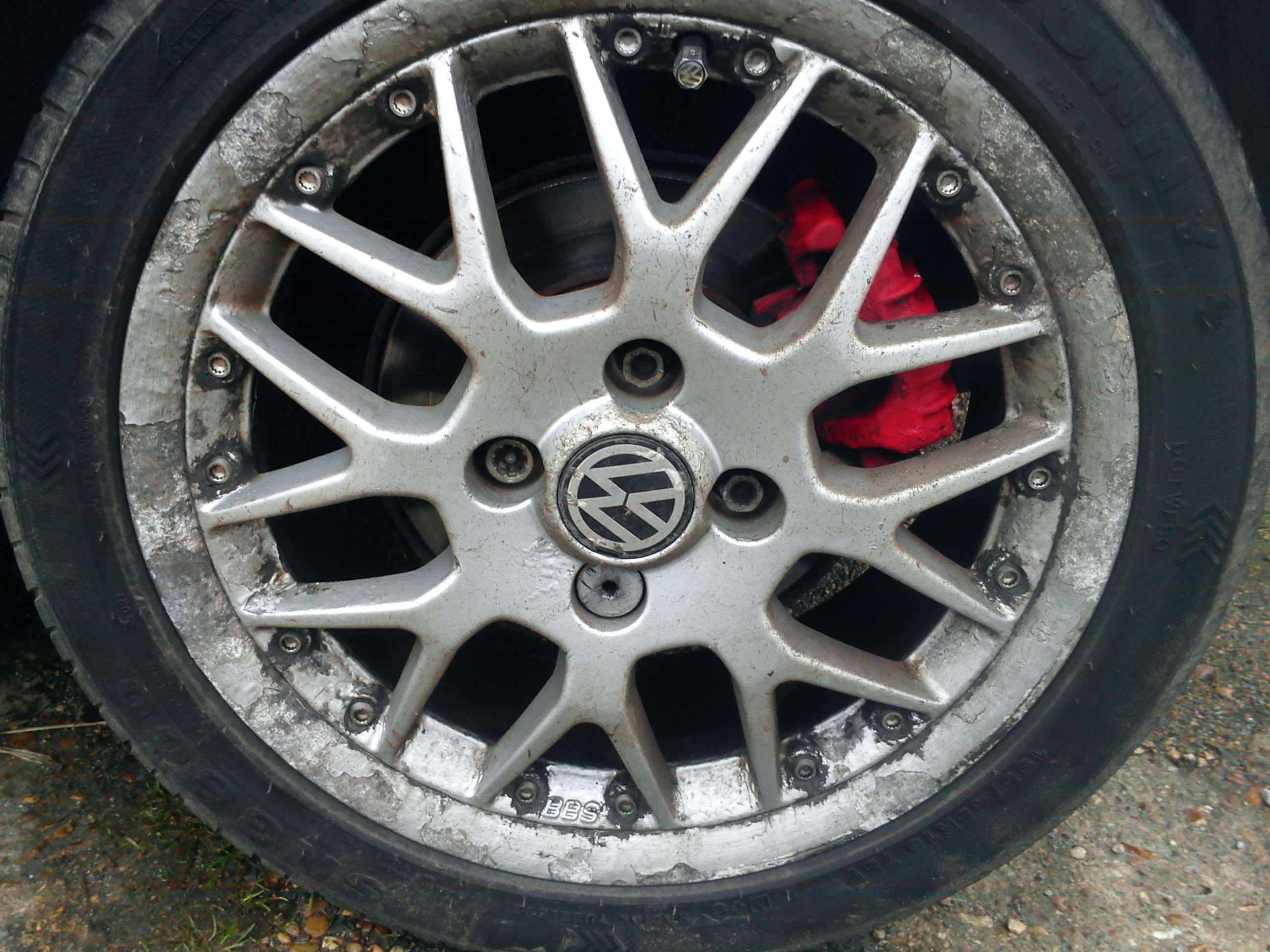

Hi everyone,
thanks for all the replies. Your information has been very helpful to me.
Here is a picture of the worst of my wheels.
The guy at the garage said they need sandblasting. I have emailed the picture to some companies to see if I can get a lower price to get them refurbed but if not then I will just buy new ones. Thanks for all the advice Adam. I really appreciate your post but I cannot see me doing the wheels myself. I don't have the time or the space to do them and to be honest I wouldn't feel confident at all even taking wheels off on my own. Well maybe I could take them off but I would worry about if I could put them back on properly afterwards. It is a lot better for me to pay the professionals to do it as long as they don't rip me off.
I have had a quick look at Wheel-whores.com and it looks good but I will need to take time to look properly. I was also told to look at rimstyle.com which also looked promising when I had a quick look.
Can anyone tell me whether there is any difference in handling between 15" wheels and 16" wheels? Is it just a case of the bigger, the better?
Many thanks to everyone
Mark
Its certaintly not a case of bigger the better. Fitting bigger wheels and tyres can make the speedo read inaccurately, the same goes for fitting smaller wheels and tyres. There shouldnt be alot of difference in handling, but fitting bigger wheels with wider tyres can make the car 'tram line' (follow the grooves in the road left by trucks) With 16" wheels that will be a similair width you shouldnt see any problems to that effect. I personaally wouldnt go any bigger than 16" if you want to minimize the 2 issues mentioned.
I agree with the other guys on the refurb though. The prices you were quoted are ridiculous, they must have realised you didnt know much about cars and tryed their luck ripping you off. I wouldnt bother refurbishing the current wheels, as they are readily available second hand in better condition, or even already refurbished, for reasonable money. I cant find any for sale currently, but they go for about £200-£250 in nice, fresh, refurbished condition, with good tyres fitted. Just keep a look out on here, or ebay, for 'BBS RX2' as thats what they are called.
It's best to start somewhere - if you don't feel safe removing a wheel, you're screwed when it comes to taking it off when/if you get a puncture.
Removing a wheel is easy. When it's dry, (the weather), because wet makes it horrible. Have a look underneath the car, you'll see a line that runs all the way along the sill on the underside.
If you remove your jack, you'll see that on the top of the jack - where it goes under the car, there's a matching groove. Place the jack around half a foot from the rear wheel (or whatever wheel you're removing), slot the jack in and carefully wind it up.
Obviously crack the wheel nuts first - loosey lefty, righty tighty. Put the wrench on and stamp on it with your foot, it's the easiest way. Then jack the car up.
Remove all the bolts and the wheel pops off. Nothing to it, really. Get stuck in! :)
If you can get the wheels off and get them somewhere, it'll be easier.
Sandblasting is the correct term. It's as it sounds, they blast sand (fine sand) at the wheels at high pressure, it removes all the shite and crud.
They then polish/paint/whatever the wheels back up. It's common to split the wheels, polish the "lip" and powdercoat the inner whatever colour you want.
I picked up a set of the GTi wheels that had just been refurbed with brand new Toyo's for £200. The tyres alone are worth more.
ClubPolo is a very friendly forum, and by far the best tbf, people like helping! :)

I bought the same wheels in a worse state then that and it only cost me £120 to get them powder coated and they look good as new i got the spokes black and the outer rim siliver.
peice of advise be very very carefull when taking the 16 bolts out because i snapped one and it was a very stressfull ordeal getting it out. will try upload you a picture later so you can see what they look like

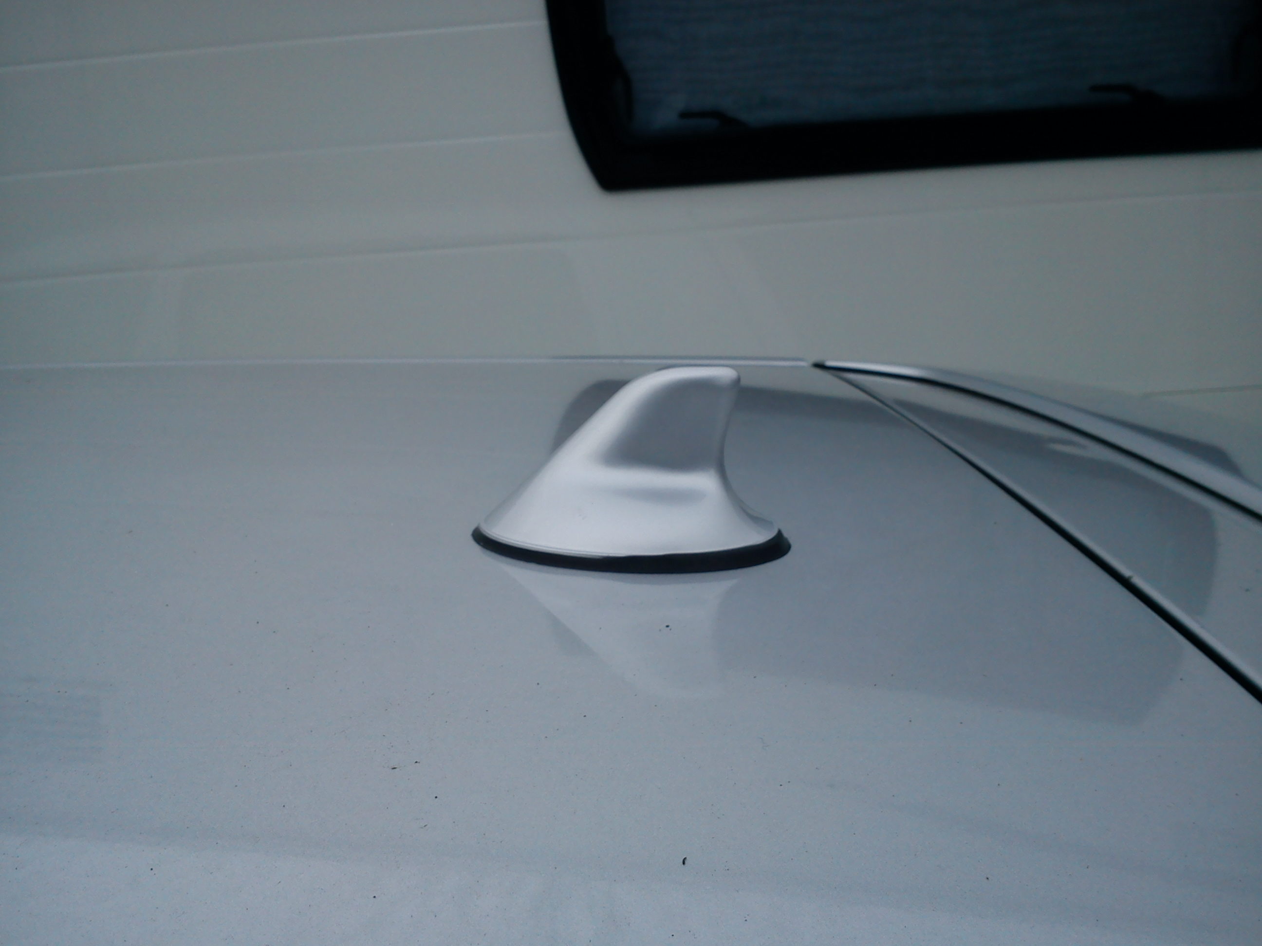

Adam - I will have a go at some point when it's better weather. I did manage to change my aerial today which is the first ever car mod I have done. My mate helped me and neither of us know much about cars. It has made me want to have a go at doing more things in the future.
Adam and Josh - I was told at the garage that they weren't split rims and that the little bolts all around the edge didn't come out.
That's good! It's good to just get stuck in! :)
Your garage is wrong, the bolts remove and the wheel splits. The bolts are usually well corroded in, sometimes they snap (like above), but you can always get stuff out!

So they wanted £600 and weren't even going to split them? I did quite a few of these and I chaeged £40-£50 each wheel, that's with spliting and taking the tyree off and refitting them . I either was doing something wrong there or something right?
