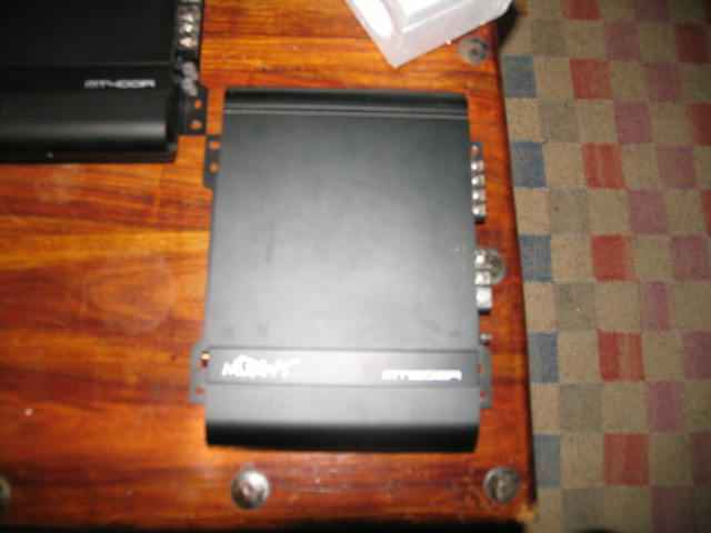

you wont get anything decent bass wise (without distortion when cranking it) of a speaker smlaller than 6.5 " howver you could fit 3 way component speakers that divide the frequencies between bass mid and tweeter giving a clearer crisper sound and providing decent bass however most decent 3 way comps are gonna 120wrms which mean you head unit will struggle to power them of the inbuilt amp eventually causing the amp to burn out or blow the way round it is to run a small 2 channel amp like this one along with something like this but they wouldnt mount in the front unless you can find a place under the dash/footwells etc
