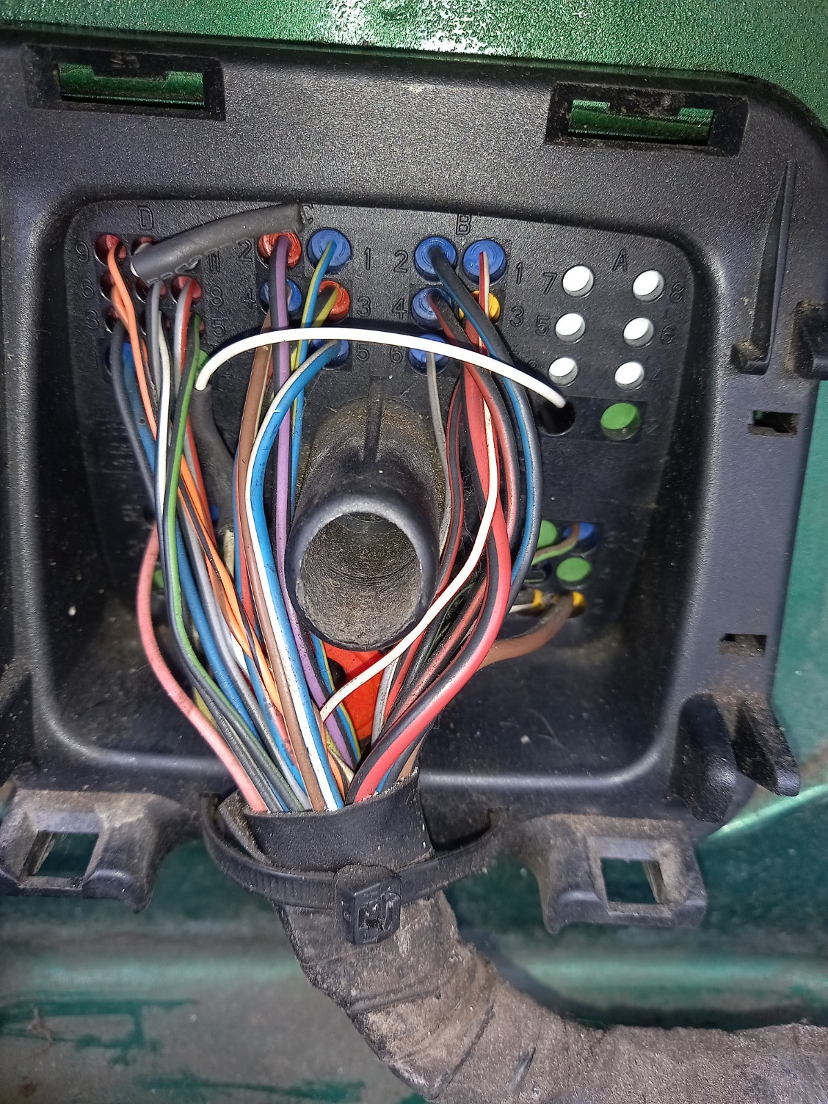

Below is a pic of the engine bay side white wire location, this is in behind wiper motor, with lid off the relevant interconnect box.
To get to here you need to remove the wiper arms, the plastic cover over the scuttle area, the wiper motor and mechanism and realistically the vertical metal panel that the engine ECU is attached to. (A few 'star' clips that just unscrew, a few T30 torx screws and a few plastic fittings here and there.)

Completed this on Saturday without any major dramas.
Fed the wire through from engine bay side (good opportunity to clear out water-box/scuttle area which needed it), through unused pin 1 of unused connector A* in the image above. Central Tx30 releases that whole engine bay connector group, revealing a hole where connector A is/would be. Viewed from inside I could see daylight with that cover in front of the relay panel removed.
Cut the original white wire and soldered to the newly threaded one:
