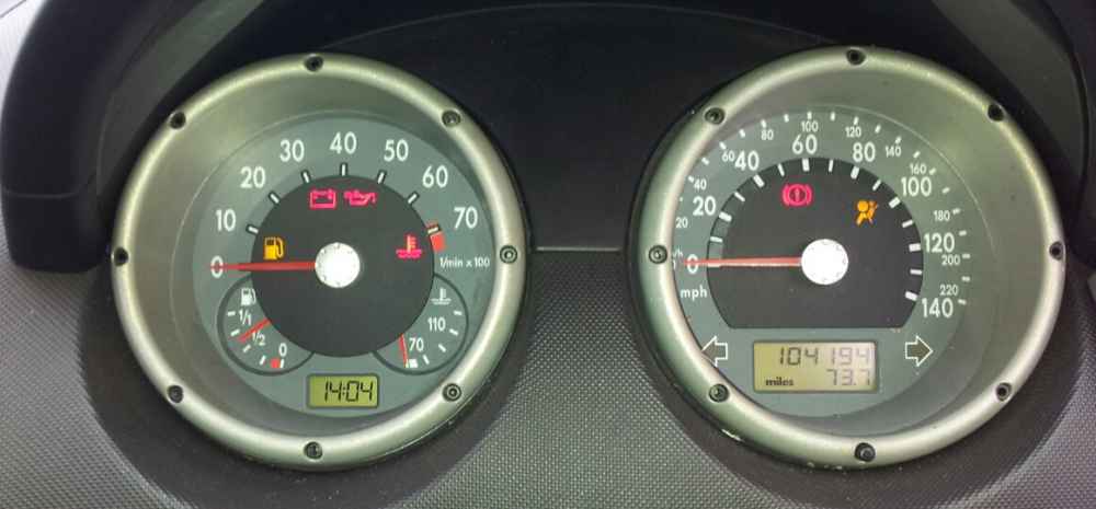

I checked over all the fuse links and there fine the light doesn't come on at all witch leads me to think the bulbs gorn or been removed.

If you bought it like that, chances are the bulb has been removed, to mask the problem.
I was also going to suggest check the bulb is present and working!
Here's the pic of the ignition lights
It's also possible to fool the speedo pod that the car does'nt have ABS, if you put a permanent ground on pin 19 of the blue connector it will inhibit the light, in a car with ABS pin 19 goes to the ABS control unit pin 16

got some time today to get the clocks out and checked it all ok nothing there out of the ordernary at all so i disconnected the battery for a couple of hours then when i turned the ignition on got a symbol of a A with a arrow round it then went out and haven't come on again any ideas what this might be? Thanks everyone for your inputs
That sounds like the ESP light #16??

yer that was the symbol 16 esp is that traction control or electronic stability control? Had noidea the car had esp but there's still no abs tryed it out on the way home and still no abs light or eml light guss il have to see my mate and have it plugged in and see if there any codes!!! Also where did you get this pic from?

Electronic Stability, it uses the ABS system!!
The picture is from Elsawin.
In a previous posting I made, It's easy to fool the speedo into thinking there is no ABS fitted just put an earth wire onto pin 19 of the blue connector of the speedo or pin 16 of the pump unit and this will inhibit the fault light
