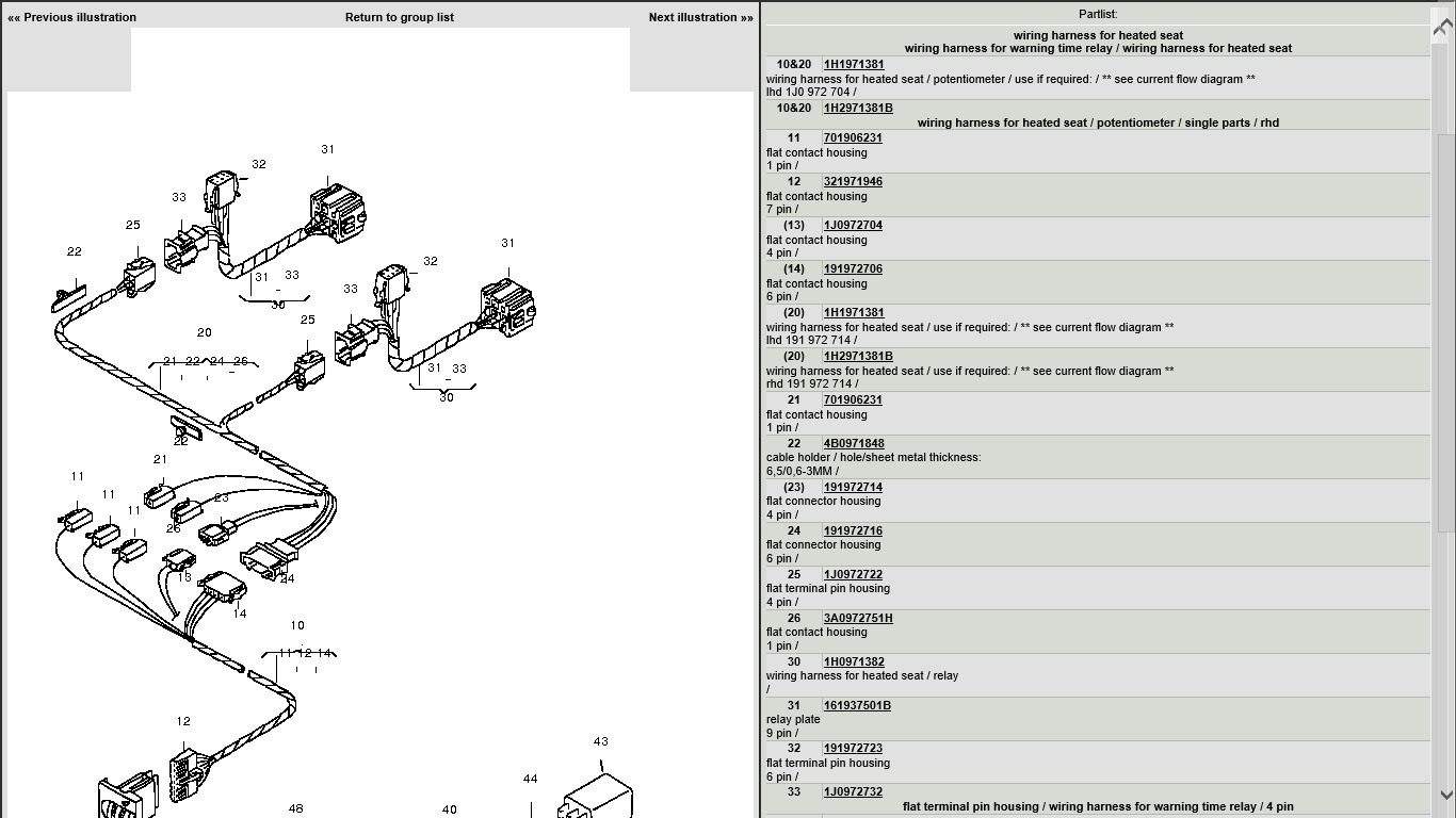

Sorry, you're right its a variable resistor. but VW call it a relay. there is one for each seat. the part number is 443919533A
To use the VW switch I cant seem to find a way out of using the 443919533A.
you can have them on or off using a relay, that will remove the thermal cut out that is also controlled by the 443919533A.
Hope this is a little clearer.

like I say, vw call it a relay as it performs more functions than either a variable resistor or relay
it is the part which plugs into item no.31 on this ETKA image. titled relay plate.
