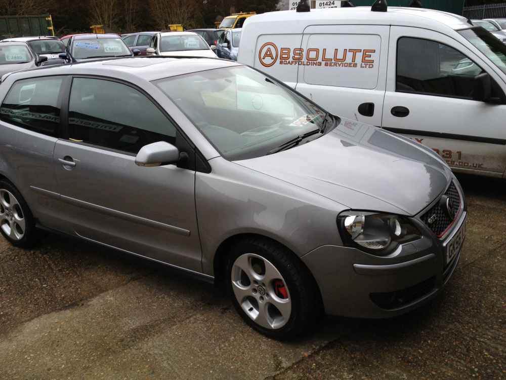

Bought my car in January.
Then it snowed
But finally when the sun came out managed to get a few bits done.

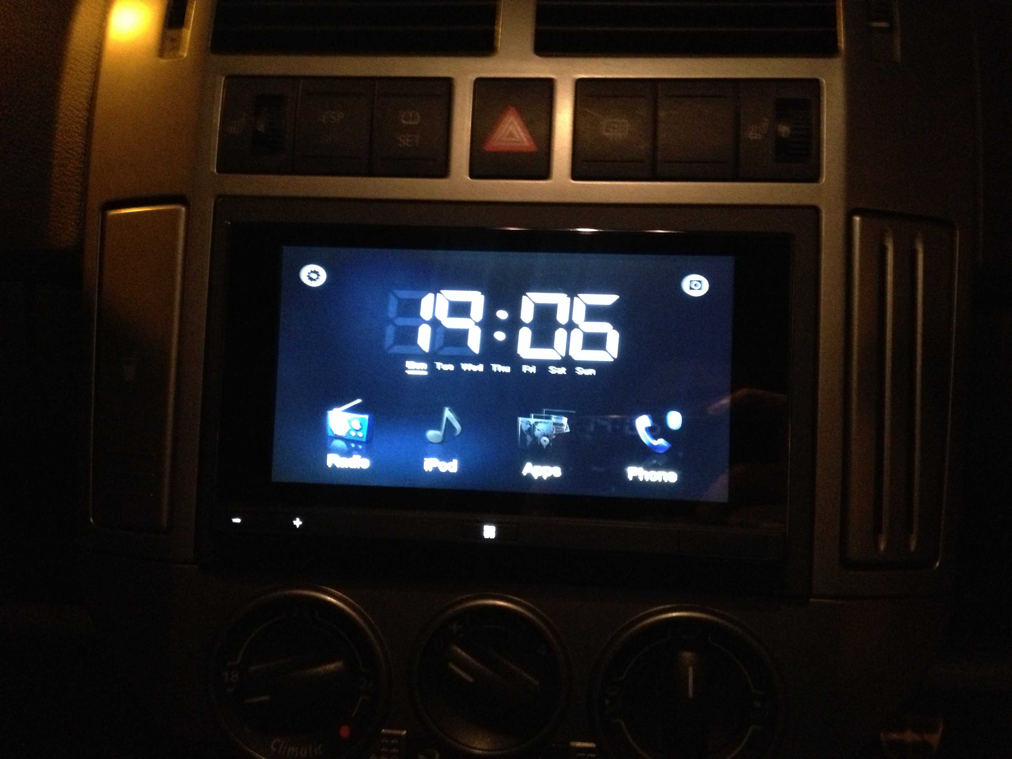

Next up was the headunit

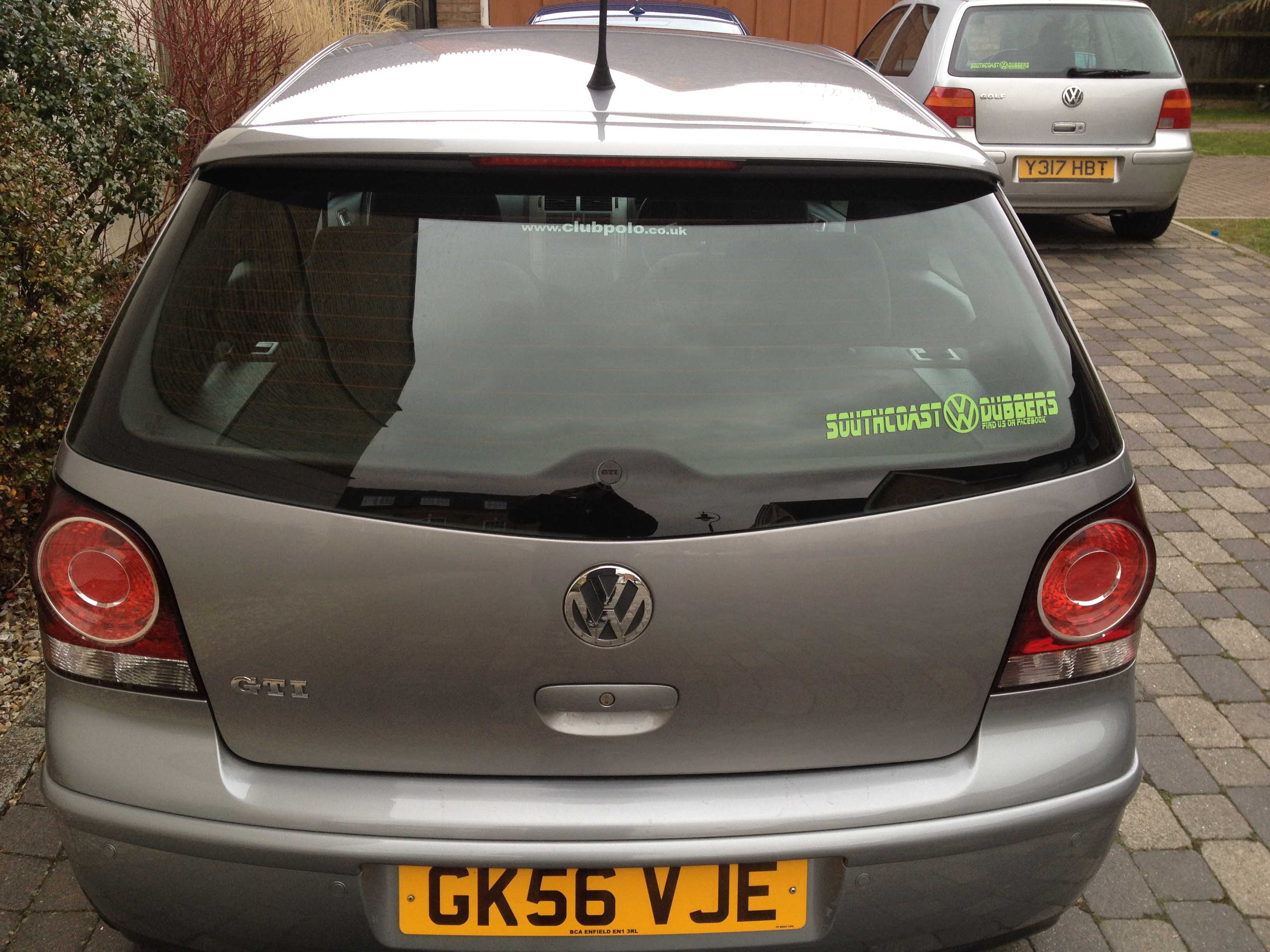

Few weeks later deleted my rear wiper with a gecleant plug, and added my local dub club sticker

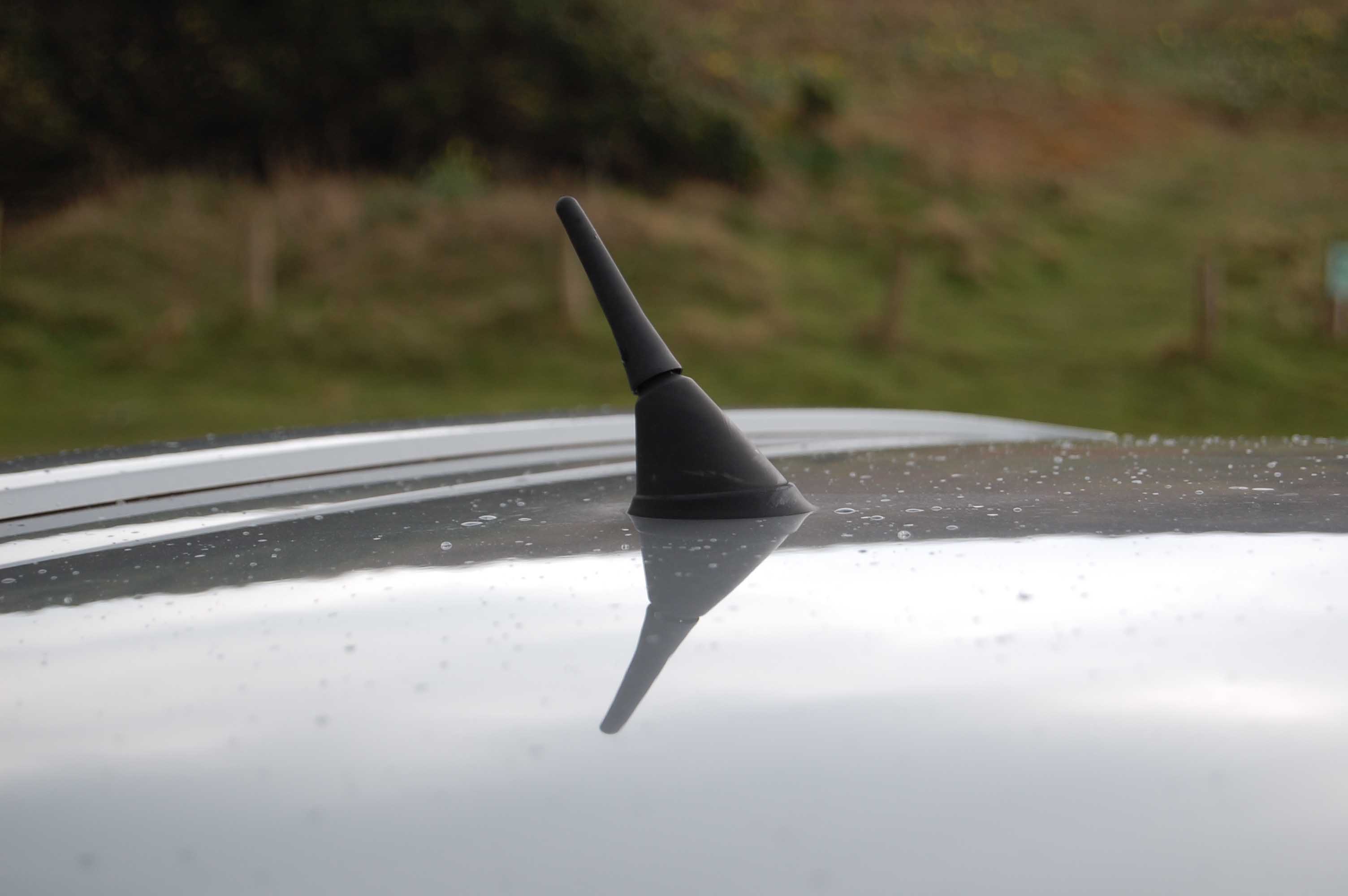

Stubby aerial

hi buddy car looks really clean 8-) , wanted to see how your head unit fitted to yours?
I've got the app radio aswell and was considering chopping the back of the centre console and trying to get it flush.
what did you do with yours and do you find much of the head unit sticking out ?
Thanks guys.
Radio is a nightmare to fit due to the amount of cables.
The surround fits flush with the dash without chopping the car up (I did leave the rubber knob off the back)
With a bit of fiddling and some rude words it does all fit.
Didn't realise till I got it out the box but the unit itself won't sit flush with the dash whatever you do.
Just the design of the unit.
Also be aware that the power in the loom is constant on both so you have to wire up the intermittent power to the back of the cigarette lighter.
And for the handbrake cable just stick it into the ground cable at the back of the headunit, this will bypass it so you can use sat nav even with the handbrake off.
Hope this helps

Fair play I had the same problems i ended up taking the centre console out for better access, luckily previous owner wired in an acc cable and like your self
bloody knuckles and alot of swearing later it was done, big improvement in sound for door speakers and really useful for iphone.

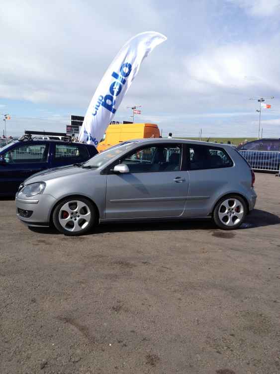

Firstly got the splitter fitted, then the coilies.
Definitely sitting much nicer now.
Would love some feedback on what people think of it.
Come and say hi if your going to be up at Santa Pod on sunday :-)
looks better dude! how low did you go? and ill see you on the club stand!!
Looks good, nice a subtle. What coilovers are you running how dies ride compare to standard gti springs? Love the lower honeycomb where did you get these from?
rouletwilson Posted Today - 7:41am
Not Sure on the final drop, left it down to my mechanic (yes I whimped out) to what he thought was best, seems to clear most speed bumps but after finally fitting my splitter its that which is scraping on the driveway :lol: See you on Sunday

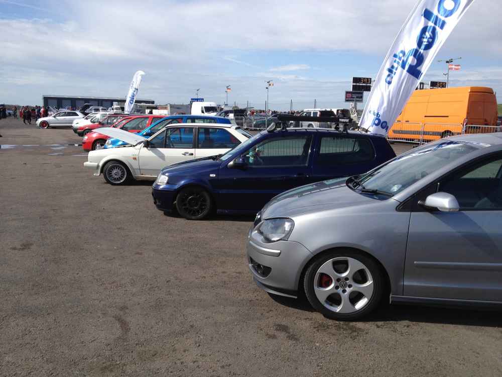

Had a great day last Sunday up at Santa pod on the Club Polo Stand
Was good to see some of the cars in the flesh and to put some faces to users.
Took a couple of pictures and thought I would share them with you.
Also managed a 16.4 on the strip which I was happy enough with for my first time :-)

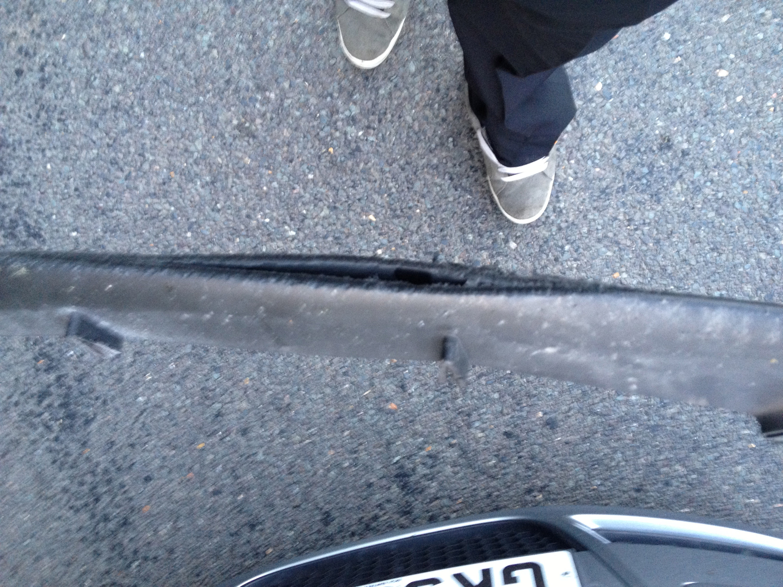

Sadly I no longer have the splitter on the front of the car as I firstly had a fight with a speed bump and then secondly yesterday I hit some debris on the M25 which knocked the splitter down and then I dragged it halfway round the motorway :(
Heres the outcome
Suppose I better get another one on order
