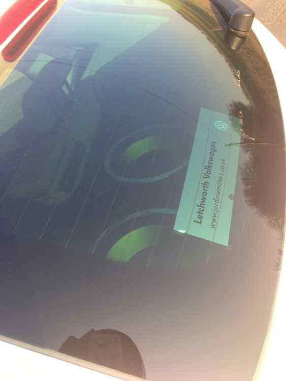

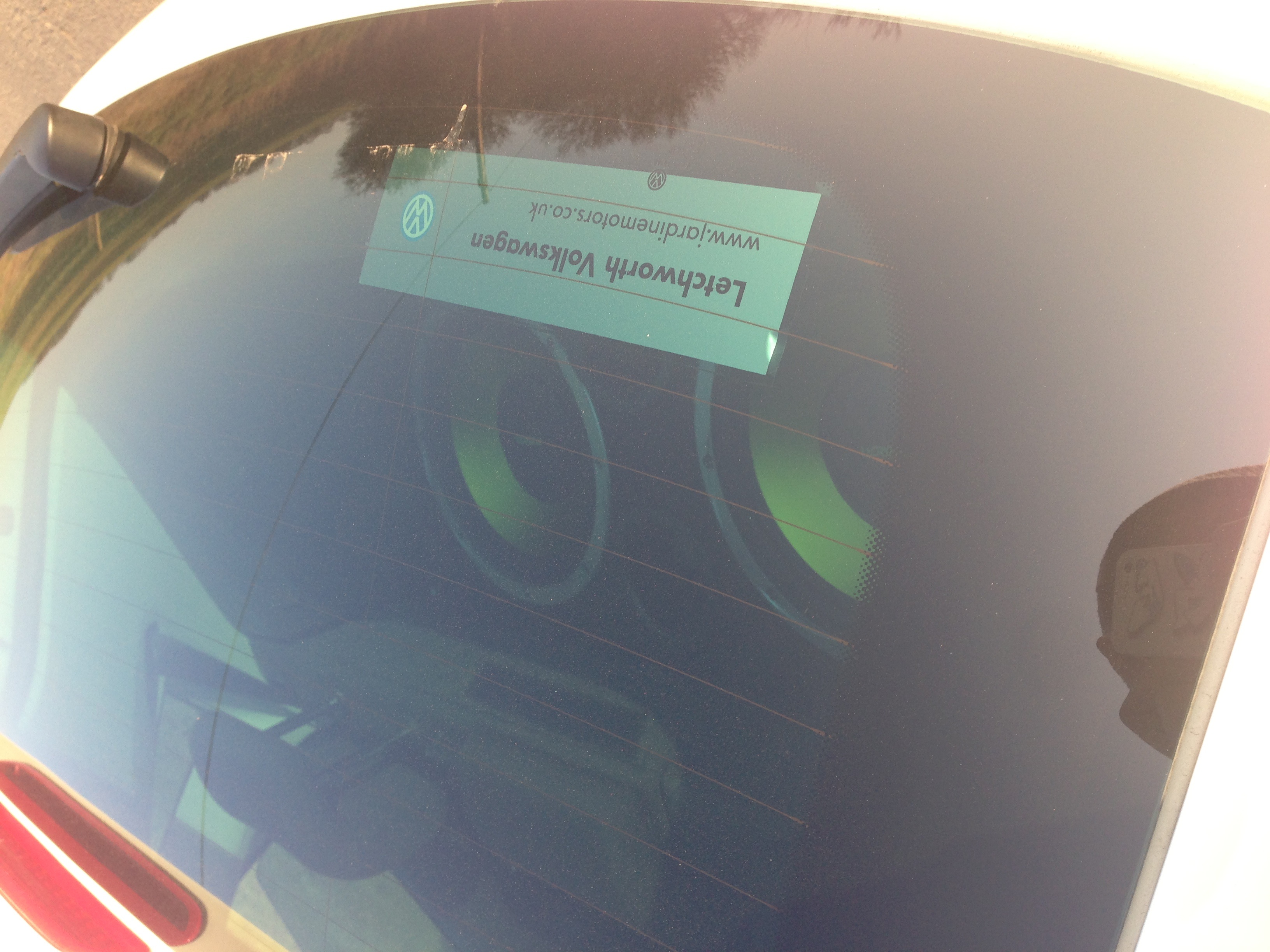

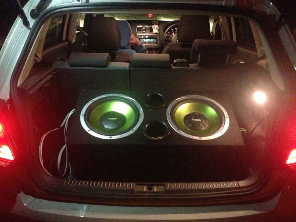

Some pictures of the subs
I am looking to do a boot build, I'm not sure how I want to do it yet. I originally wanted to use the spare wheel we'll but thought better of it for emergencies. So I am thinking of either bottoming out the subs with a tray above them to allow for some boot space, or to have a sub at either side of the boot facing inwards at a 45* angle each to centre the bass allowing the middle of the boot to be used for storage. If I have them at either side I will have the two amps in the middle hidden in a box with a hinged lid allowing for any further adjustments. If anyone has any ideas please reply as I am not sure yet of what I want to do!!!
