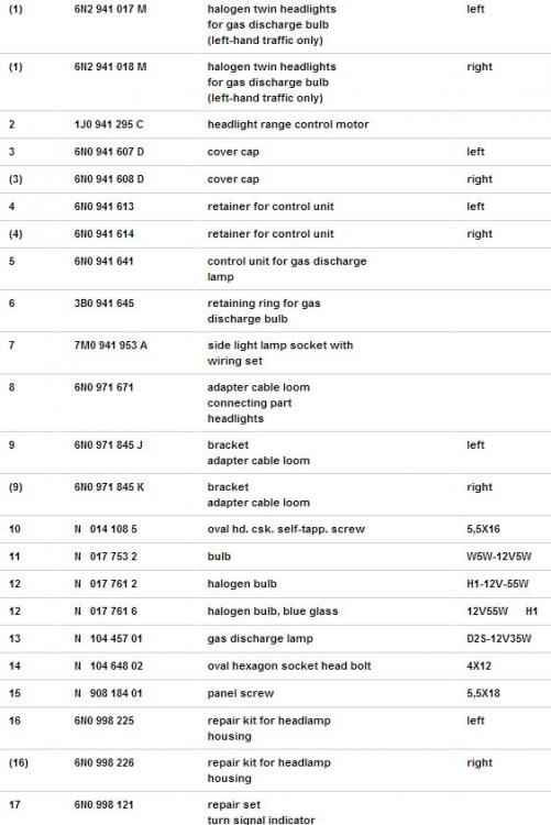

Can you also get a Exploded parts diagram?

Here is the exploded schematic for the headlight (if it's of any interest).
post-147057-0-84285700-1384346585_thumb.
post-147057-0-16573500-1384346592_thumb.
