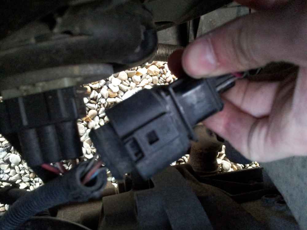

Cheers for all that. I have located them both and gone to do it but I can't get the wiring clips off. Is there a technique or do i just force them?
Push the tab kinda down and towards the back.
So, looking at that picture, the tab goes down and then towards the top right corner of the picture?
Then pull the two connectors.
Once you've done one, you can do them all. :)
Yeah pretty straight forward mate. Squeeze the tab and it will allow it to unclip.
