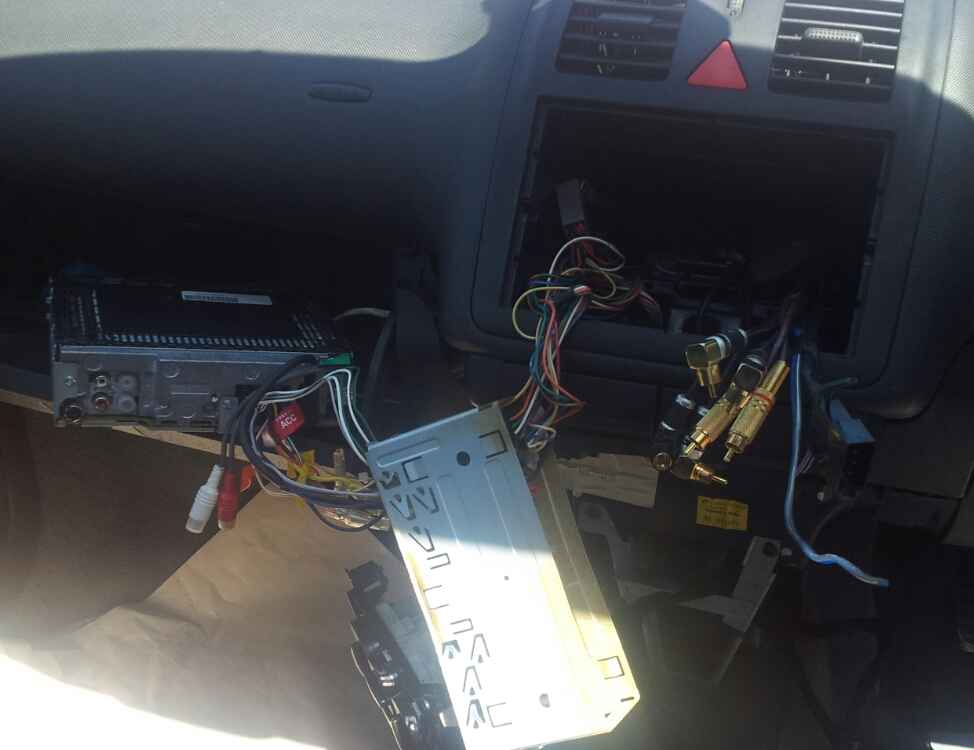

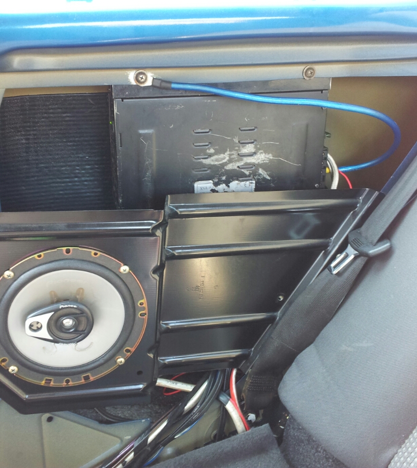

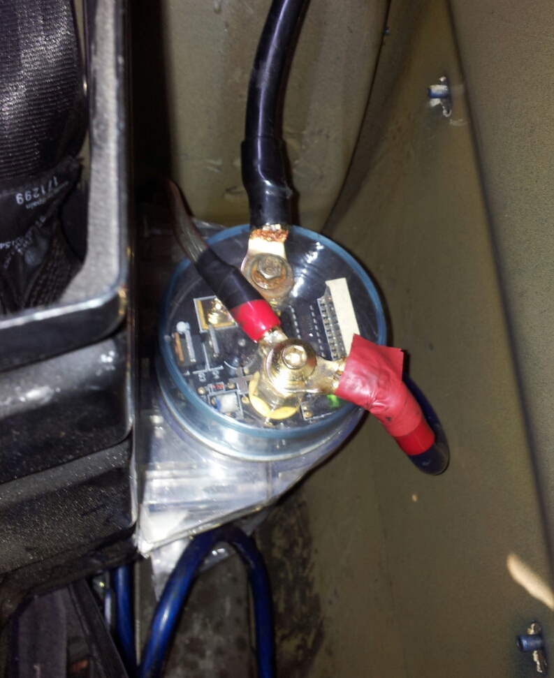

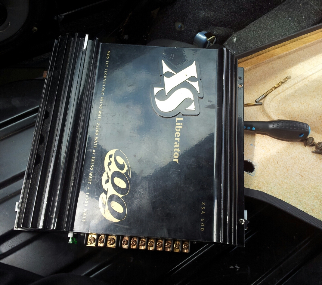

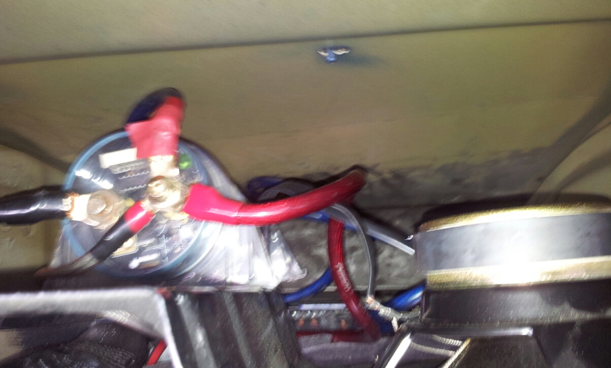

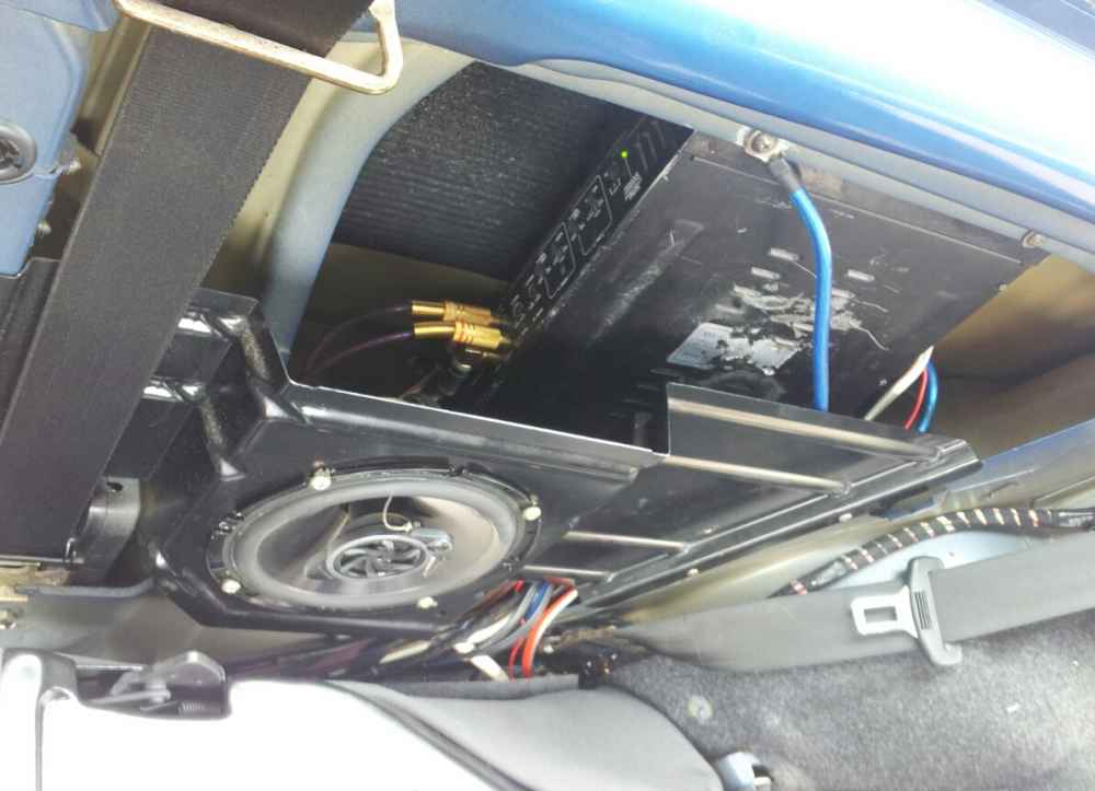

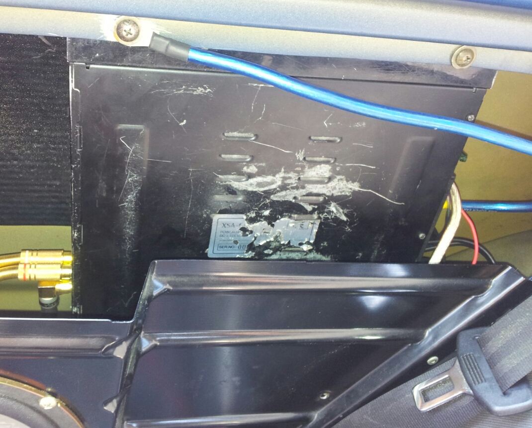

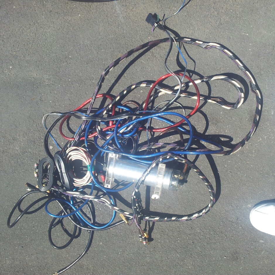

Here's today's pics mounted the amp and wired it all up most of its done now for the 4 channel amp just need to mount the power cap but fitting the lanza amps will have to wait till i get the box build as i don't want the extra weight for no reason . More pics to come as i tidy it up and start on the box.
bin that power cap and run a second battery aswel as a volt meter, if your doing a low false floor the box might be too small for them subs as in cubic feet

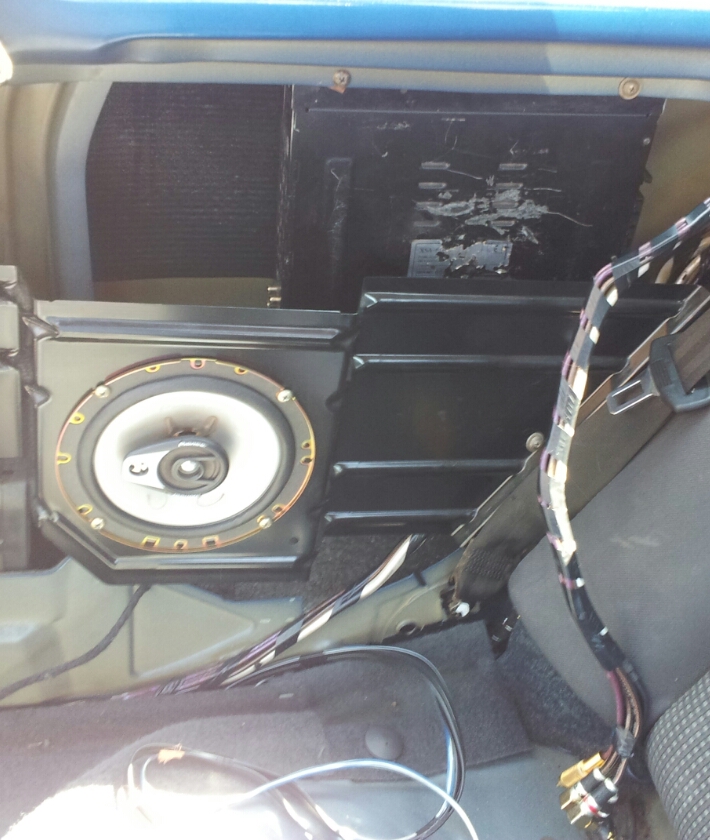

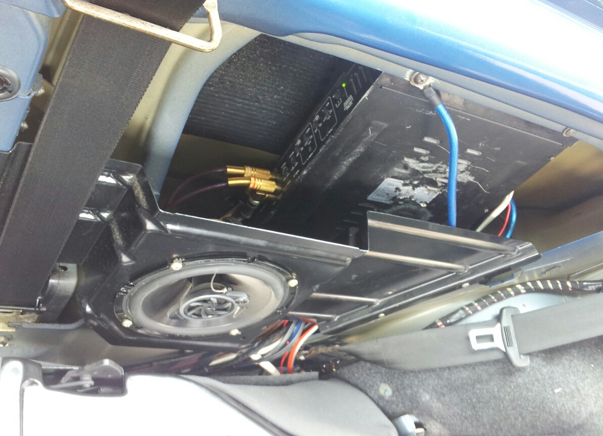

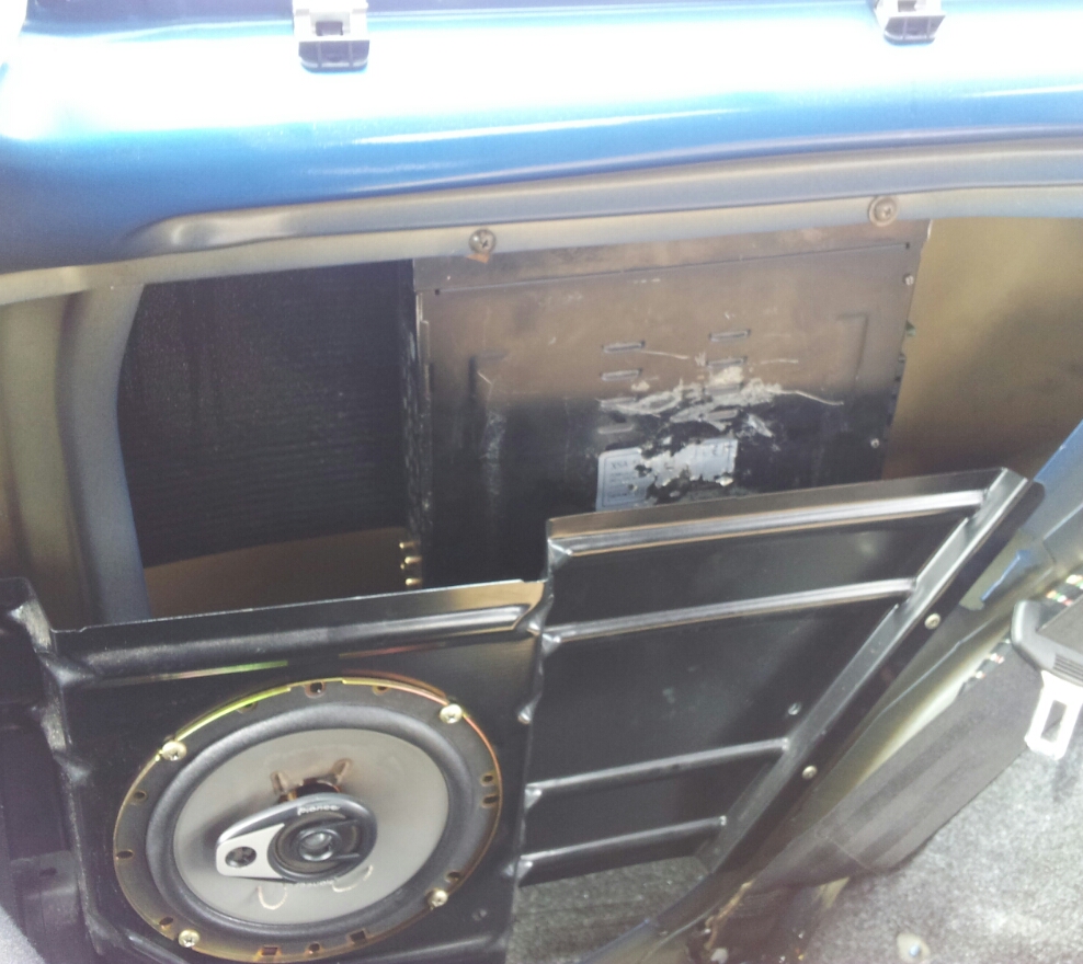

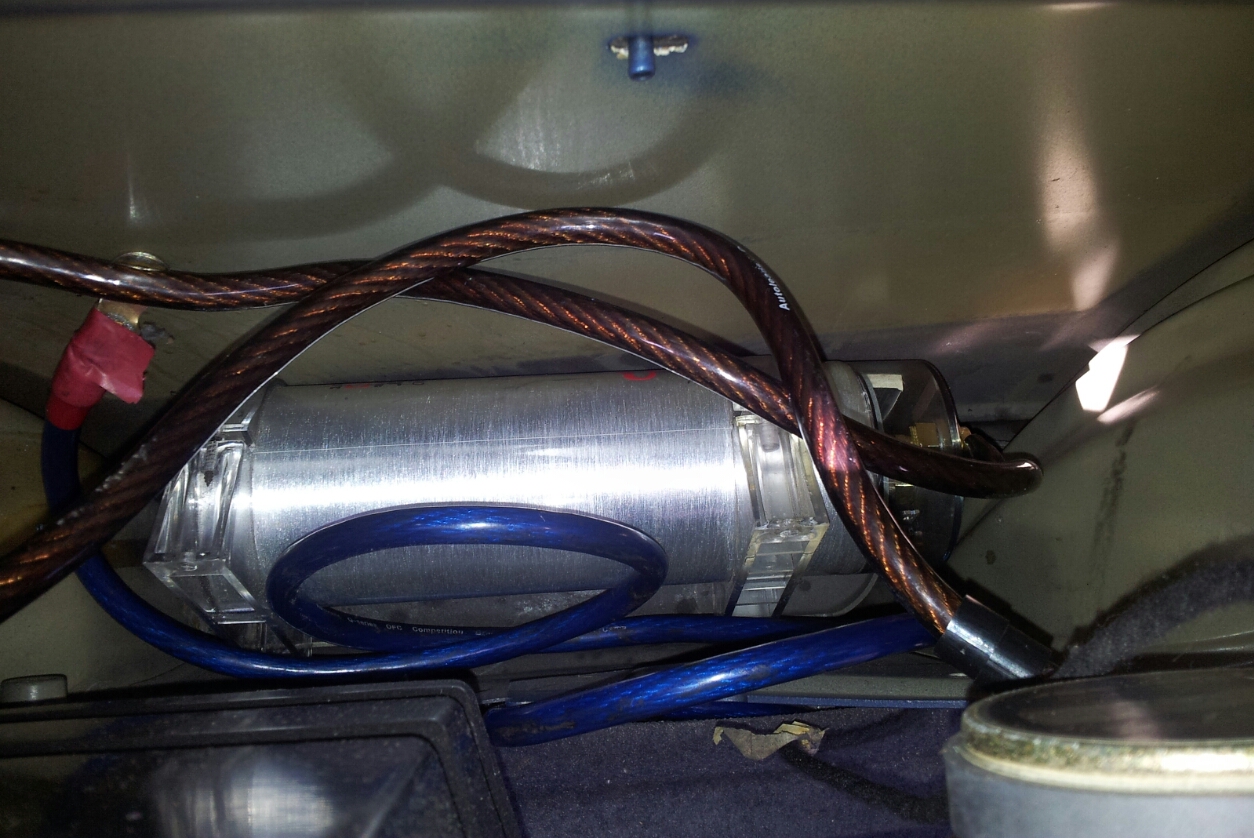

My lanza amps to big to fit in the side panel so its going in the boot and the power cap going in there to help stops interference with my 4 channel ( I'm only using the cap as i have it laying around) I've also changed the rear speakers to some better 3 way pioneers now i can start putting the interior bk in here's somepics of it all wired up.
So amps in caps in And new rear speakers and that's my old box new one to be built keep watching

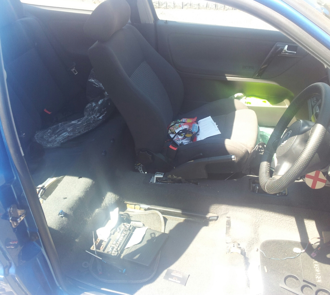

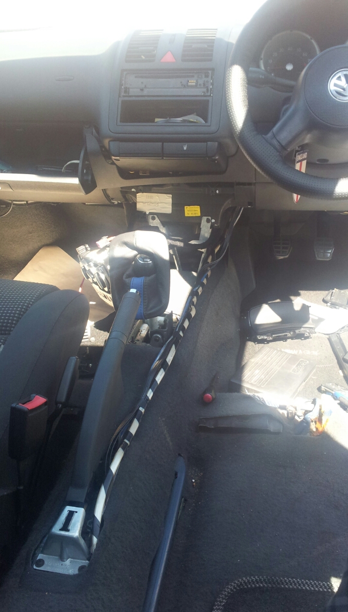

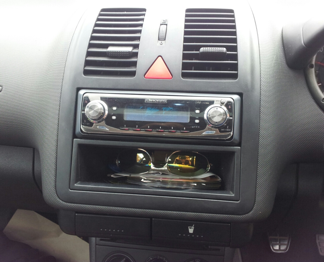

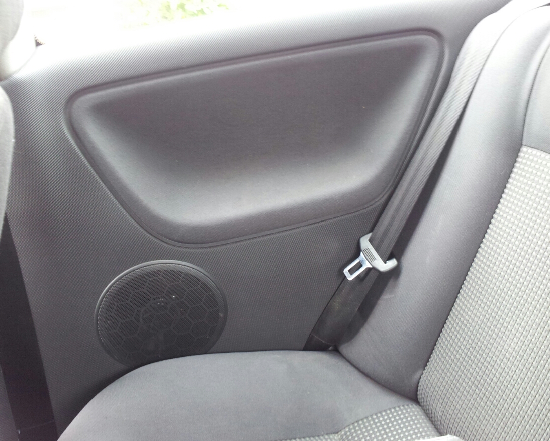

Here's the latest all in and hidden and back together sounds good now just need the subs in all the wiring ready for the Lanza just need to build the box .

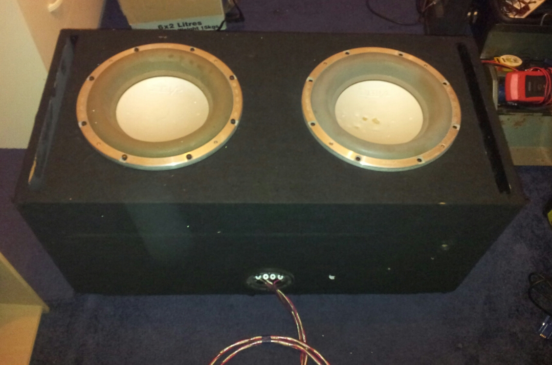

I was running the same subs and amp just a second battery 0gauge and line drivers and my Kenwood headunit a big box can't remember the exact size there's a pic of the old box but all that extra weight was ok in a car with 160 bhp but the polos only 100 and nippy but i don't want to weigh it down plus its nice to have boot space I'm building a shallowbox but still using 2 subs and playing on making a fause floor to cover them i don't want everyone to be able to see them but still be nice and lould (",)

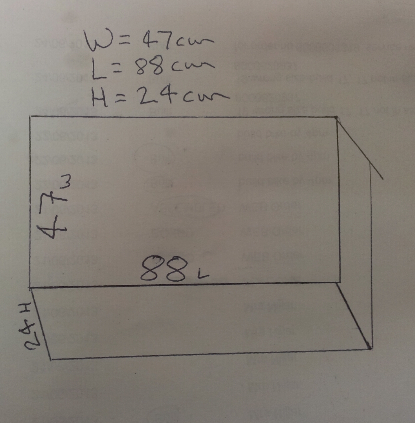

id do it ported I'm never going back to a sealed box, give me the boot width 35" hight 9" at my guess and depth 15" you want and ill calculate it for you

Il measure up the boot and get a diagram of what I'm after thanks I'm looking around 35Hz i do think porteds the way I'm going to go : )

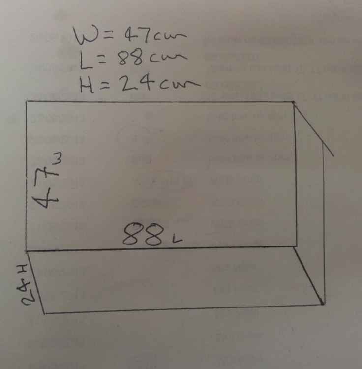

Hay dude if you still want to run some box designs for me here's the size id need it to be id like to get the 2space subs in if possible if not one will do.
Thanks :smile:
