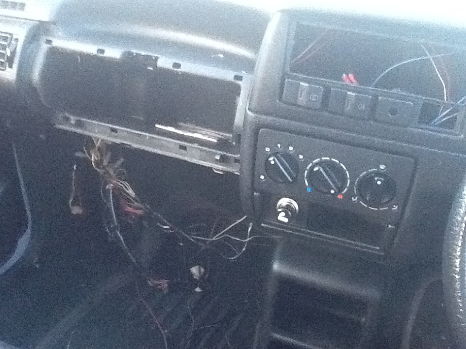

1993 K plate car with only 38k on the clock. The car was owned by 2 family members up until 2011 in which the car had only done 17k! It was then bought by someone who lived in the rip speed section of halfords. The car was unfortunately subjected to a poor attempt at a max power audio and neon set up. Blue LED's were fitted in the footwell connected to the dash lights dimmer switch! 6x9's in the rear with a Fli amp and bass box. Gear knob was a silver and tip ex'd colour and a dodgy Chinese head unit and Belkin thingy hung out the dash. It has trim missing along one side of the car where I guess the door has been resprayed due to a bump or attempted theft! Interior lights aren't connected up, rear demister doesn't work, fog light cables have been cut into and used to power an on/off switch for the audio set up and an old alarm/immobiliser needs removing from the wiring! Front passenger headlight has a hole in it and is best described as a mobile pond. Lastly the spare was flat.

I've removed the god awful audio and wiring for it and the LED's.
Started to remove the alarm

I've got the wiring to finish off/rebuild so I have all electrics working including interior lights and fit the various parts. As for the exterior trim I'm not sure if I should remove trim to have the car symmetrical or source new trim and refit?

I've done some more bits today. Bump strips removed and need cleaning up. Also removed a couple of stickers from the boot lid. Wired up the rear demister and fitted a new fuse. Working as new now. My windscreen washers now point at the screen and all 4 spray! Even the boot spray works. Fitted a new ignition coil too, cost me £17 from fleabay. Unit was slighty different from the one fitted which I think is the original unit. Anyway had to buy some differents bolt and use nuts as spacers as the 2 coils were different. No worries, cost me a couple of quid. £17 for an ignition coil is cheap enough. Some pictures added incase others want the same ignition coil.

A little update. Wiring sorted/ripped out! Rear window demist works! Still! Have the rear fog to sort out. Rear wheel bearings and mintex shoes/cylinders fitted. Rounded one of the Allen key screws that hold the cylinder to the back plate wheel hub so had to drill that out but managed to fit a hex head screw with washer. Was a perfect fit! Now though the rear brakes are dragging ever so slightly so I'm guessing I need to adjust handbrake? Or will it get better after a few miles? Also fitted a a new distributor pack but couldn't get the car to fire up? I am pretty sure leads were correct and rota arm etc were fine? Duff distributor maybe? It's this one

Wiring now gone!

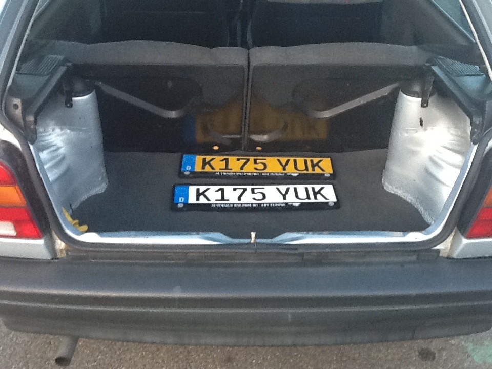

The pressed plates I have (pictured) I believe are not legal? Am I right in thinking this? Cheers
If you did not supply the company that made them with your V5 or similar document then they will not be legal. Dubmeister appear to be the one to go for when it comes to buying legal pressed plates as you send them your documents. I think your writing makes it illegal too.
Ok thanks, it's not worth the fine or points!!

The plates wont land you points btw, its a £30 fine per plate as many times as you get pulled. I've been pulled once in 5 years of german pressed plates, and that was 'national number plate check day' according the officer.
