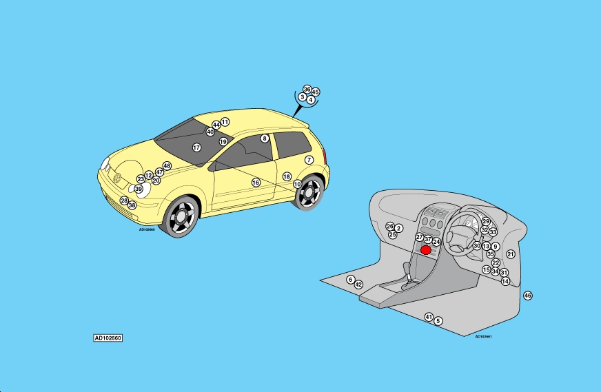

The wiring diagram shows the Earth for the Horn to be in the rear of the car????
Hmm, I can't really make out what the diagram is showing?
Perhaps it is in the rear arch? The panel in the diagram looks like a mount of some sort?
Yes, the removal instructions are as clear as mud :lol: It's just the wiring diagrams indicating the earth for the horn is on the C pillar, So I can't see them mounting it under the front wing liners and then running the earth all the way back to the boot area??

after seeing that diagram it reminded me i had an autodata disc somewhere
so loaded it up and it looks like its under the n/s/r wheel inner arch
10 in this pic
Edited by scottie
Doh why did'nt I think of looking there :shock: it's my normal first point of referance :-)
ok game over, after taking the wheel,mud flap and inner arch of it wasnt there
while the car was jacked up i lay under it and there it was, tucked up between the end of the fuel tank and chassis, then spotted the wires going through the floor, yep you guessed it the coe ut just under the seat base where I've been a dozen times 8-)
