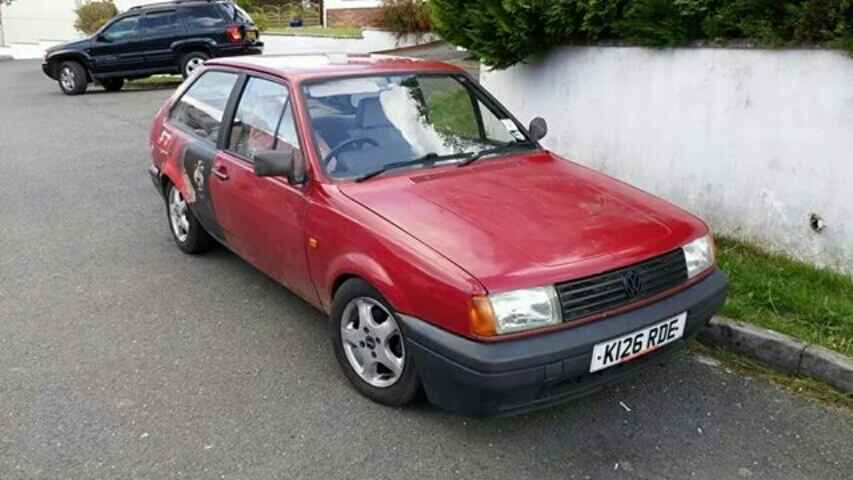

picked up this little project for the sum of £150 2 weeks ago, its a bit of a shed and for £150 saving it from the scrap is worth while, was taxed and tested.... for 3 more whole days, so went and picked it up and drove it 100 miles home and it never missed a beat which was lot more that I was expecting

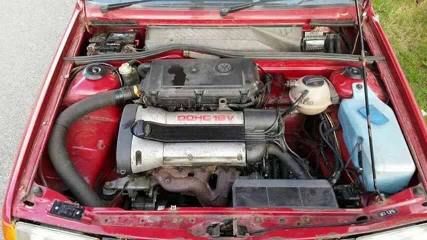

The wing was beyond repair so i was just using it for practice on but yes practice is needed considering the amount that needs to be done, plan is to get the bodywork looking like it has just left the factory then hopefully stick a carbed 1.4 16v in and a few bits and bobs along the way but any mods will be subtle

took the engine out ready for this going to run it with standard injection and immobiliser and still to clean up and give it a full major service whilst it is out the car
plenty of wiring to keep me busy
