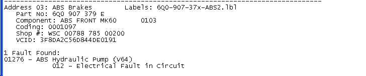

ordered the lead yesterday and got it this morning, took me only 10 mins to get it set up and turn the airbag light off
still got a fault with the ABS
01276 ABS hydraulic pump v64
012 electrical fault in circuit
heres the bit from the log, i was hoping it was just a front abs sensor
Remove the electrical connector on the pump and spray it with contact cleaner, usually a small amount of moisture gets in and corodes one or two of the pins.

will give it a try

bit of an update, car was getting lowered at the weekend , took the plugs of the abs sensors and gave them a clean, noticed the brake pad wear wires were just bare, so we joined the ends and plugged the laptop in and the warning light on the centre of the dash was now out but the abs light was still on,
read all the codes and we now get
00285 abs wheel sensor front right (g45)
which now seems obvious where the fault is
